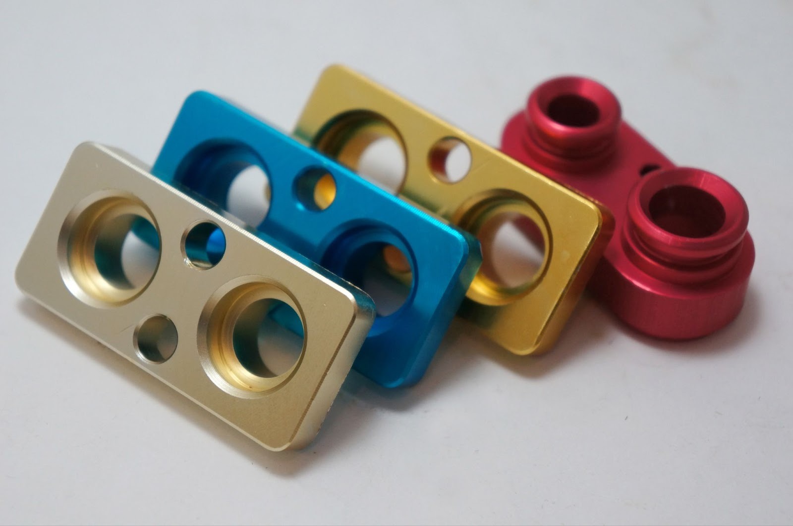

Anodizing (Type II and Type III)
Anodizing creates a stable oxide layer on aluminum that acts as both a wear surface and a barrier to direct metal contact. It is commonly used to reduce adhesion and improve durability in structural components.
