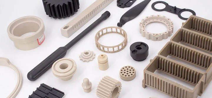

Despite these challenges, PEEK injection molding produces plastic parts with high-temperature resistance, excellent mechanical properties, and biocompatibility. Examples include surgical equipment and high-temperature seals for aircraft engines. A list of the material’s benefits are listed below:

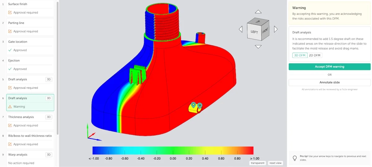

Part designers who follow injection molding design guidelines can promote manufacturability, control costs, and minimize defects. Fictiv’s Injection Molding Design Guide provides an overview of key design considerations. Download it here.

Draft Angle
Draft angles are the amount of taper that you apply to a part’s vertical walls so that it’s easier to eject the part from the mold. In general, keep draft between 0.5° and 2°. PEEK parts with smoother finishes require less draft and parts with textured finishes require more draft.

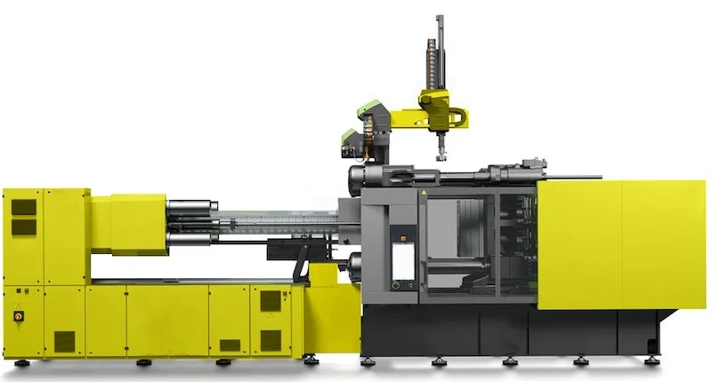

Injection molding machine
PEEK Material Processing
PEEK requires proper material processing to avoid injection molding defects. The following sections contain processing guidelines for injection molders to follow and considerations part designers should understand.

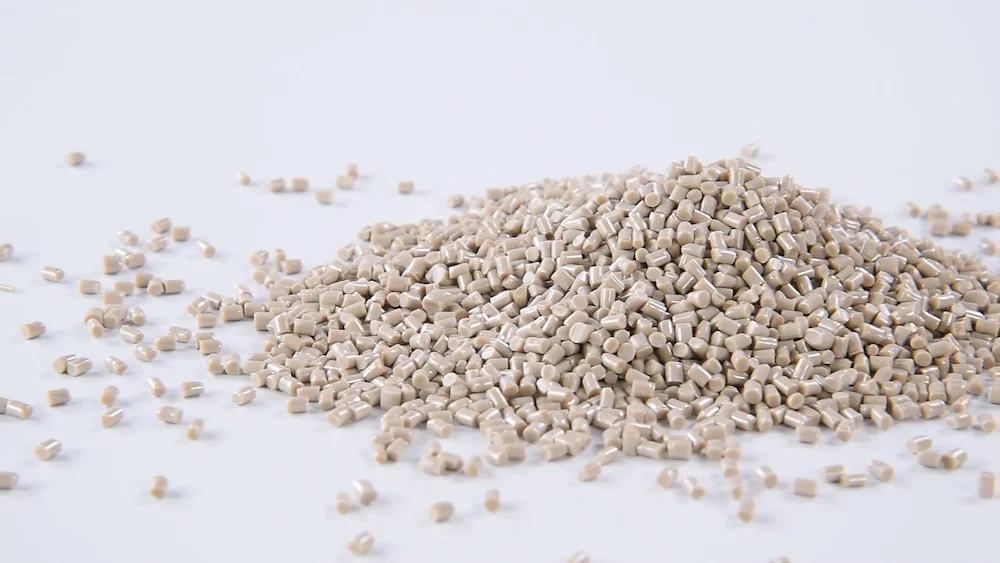

Moisture
PEEK resin absorbs moisture and must be dried thoroughly before injection molding begins — in general, PEEK must be dried to a moisture content of less than 0.02%. Injection molders can achieve this moisture level by placing the material in an oven for 2 to 3 hours at 160 °C.
Temperature Control
PEEK has high processing temperatures that range from 350°C to 400°C. Molds must be kept at temperatures up to 200°C to prevent part defects, and poor temperature control may cause a problem known as quench-cooling, which creates additional areas of amorphous PEEK and, ultimately, results in lower-quality parts.
Filled PEEK materials pose special considerations. For example, some glass-filled PEEK composites have reduced thermal stability, which means they can degrade if exposed to high processing temperatures for extended periods of time.
