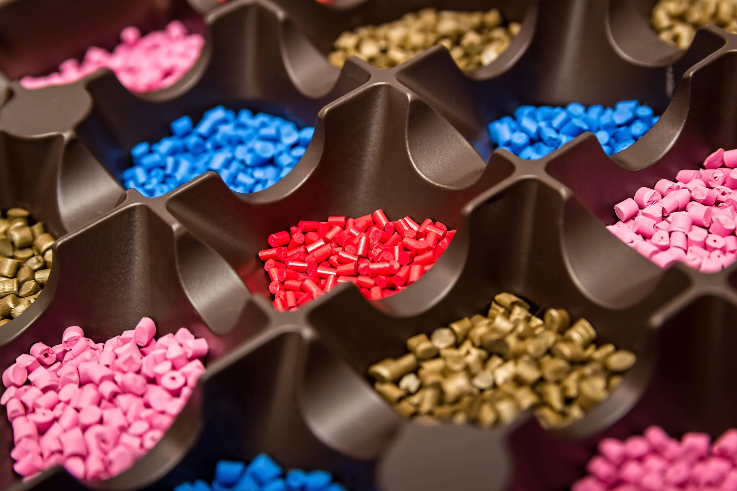

![polymer blends](https://www.fictiv.com/wp-content/uploads/2022/06/polymeric-dye-plastic-pellets-colorant-plastics-shutterstock_690803008-scaled.jpeg)
Polycarbonate/Polybutylene Terephthalate (PBT)
PC/PBT offers a good combination of chemical resistance, temperature resistance, and mechanical strength. It retains its toughness at low temperatures and provides long-term durability. This blended polymer’s properties can be further enhanced by additives that provide flame or UV resistance. Unlike PC/ABS, however, it has high mold shrinkage. Applications include electrical insulation.
Polyphenylene Ether/Polystyrene (PPE/PS)
PPE/PS provides excellent dimensional stability, low mold shrinkage, low water absorption, and outstanding stability in both hot and cold water. It also provides high impact strength and temperature resistance. Applications include instrument panels for electrical equipment, smoke detectors, speaker housings, and reusable medical devices.
