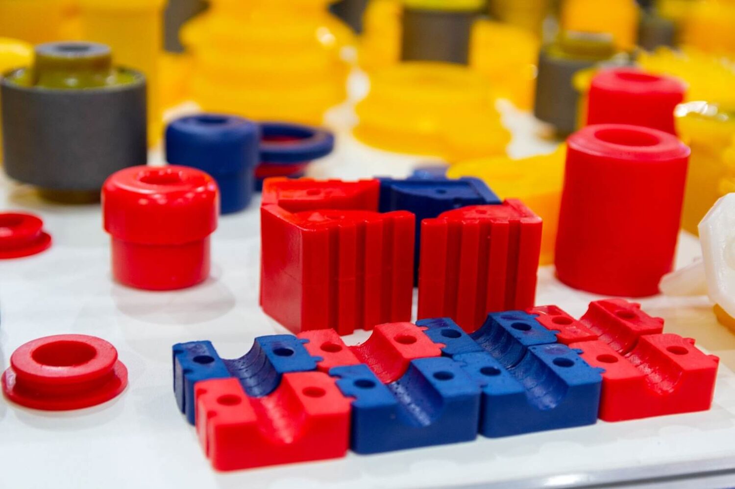

A plastic resin is an unprocessed polymer-based material, and most plastic resins (including thermoplastic resins) are made from the byproducts of petroleum refinement. With thermoset injection molding, the resins are typically supplied in liquid rather than solid form and require different equipment and procedures.
Thermoset plastics are used in consumer goods such as cooking utensils and billiard balls, but they’re also used in commercial and industrial applications with higher temperatures. Examples of thermoset products include:
- Electronic components
- High voltage insulators
- Heat shields
- Motor components and covers
- Lighting components
- Energy equipment
Medical instruments such as dental tools with overmolded handles also use thermoset plastics because these materials can be autoclaved at high temperatures and pressures. There are many different types of thermosets, but the following materials are commonly used.
