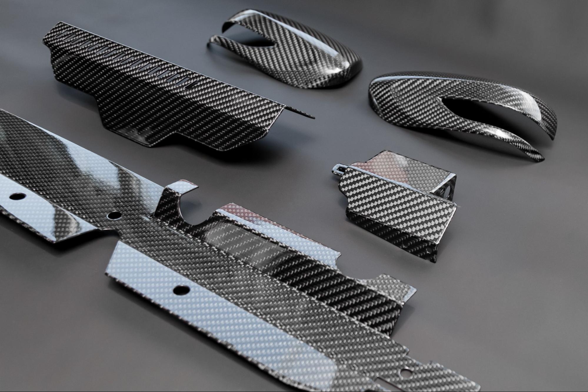

Car exterior components made from carbon fiber composites.

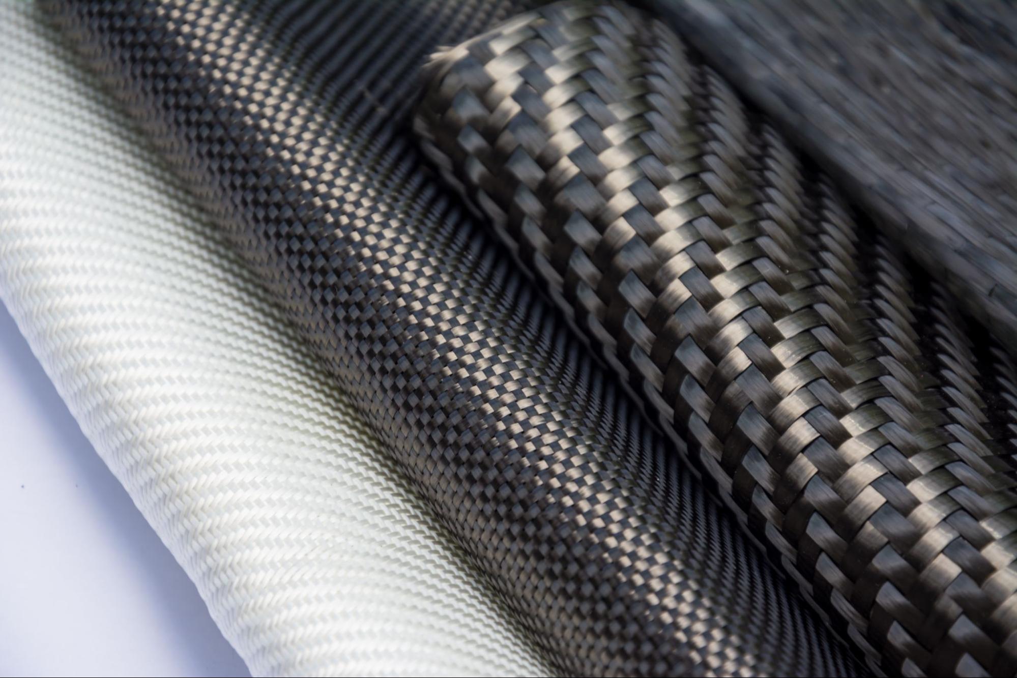

Carbon fiber composite raw material.

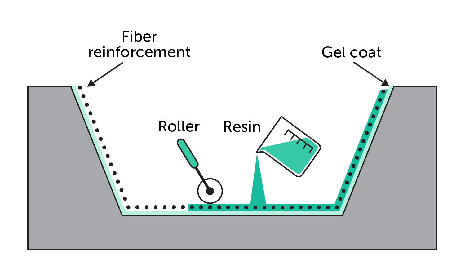

Hand Layup (Wet Layup)
In hand layup, dry fiberglass or carbon fiber fabric is placed onto the tool surface and manually impregnated with liquid resin, typically using rollers or brushes. This method is well-suited to large parts with relatively simple curvature and low structural loading, such as marine hulls, fairings, and industrial covers.
Its primary advantages are low tooling cost, minimal equipment requirements, and flexibility for prototyping and short runs.
Limitations arise from operator-to-operator variability, difficulty controlling fiber volume fraction, higher void content, and slow production rates.
