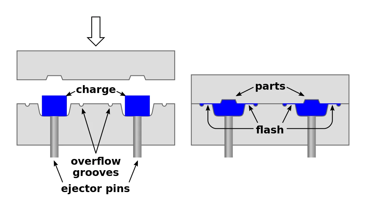

Flash molds
Flash molds are the most common mold because they’re the simplest and least expensive to produce. Before molding, an operator loads the cavity with an excessive amount of charge. When the mold is compressed, material fills the mold completely but flash escapes between the parting line. To control costs associated with waste, flash molds are often used with less expensive materials.

Compression molding process
The compression molding process typically produces flash.

Preparing the charge involves measurement. The compression mold type helps determine the charge’s size, but molders still want to avoid excessive trimming or de-flashing. If the charge is too large, compressing the mold will cause excess material to escape between the parting line and produce flash. If the charge is too small, there won’t be enough material to fill the mold completely.

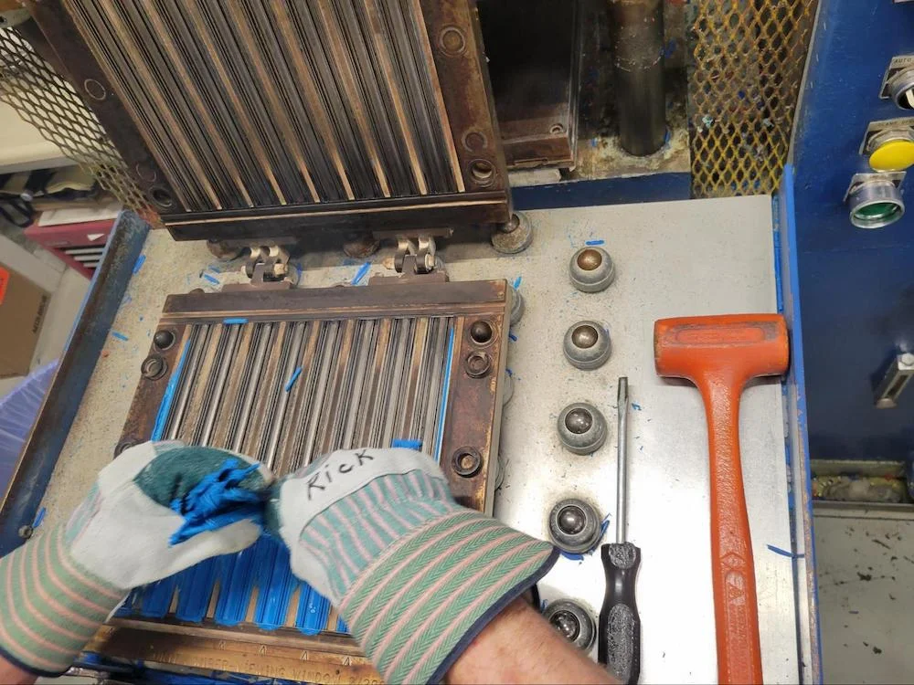

After the part is cooled or cured, the compression mold is opened and the part is released. Depending on part complexity and volumes, part ejection can be manual or automated. Manual ejection is fine for simpler parts and low-volume applications. Automated ejection is used for more complex parts and higher volumes. Typically, a plunger-style ejector pin that telescopes from the underside of the mold is used.

Clean the Mold
After compression molding is complete, it’s essential to clean the core and cavity to remove any residual material. Regular cleaning is usually done with a  handheld tool, but more thorough periodic cleanings are also required. Technologies include dry ice blasting and cleaning with chemicals, lasers, or ultrasonic immersion. Finally, a release agent is applied to help prevent sticking during future molding cycles.
