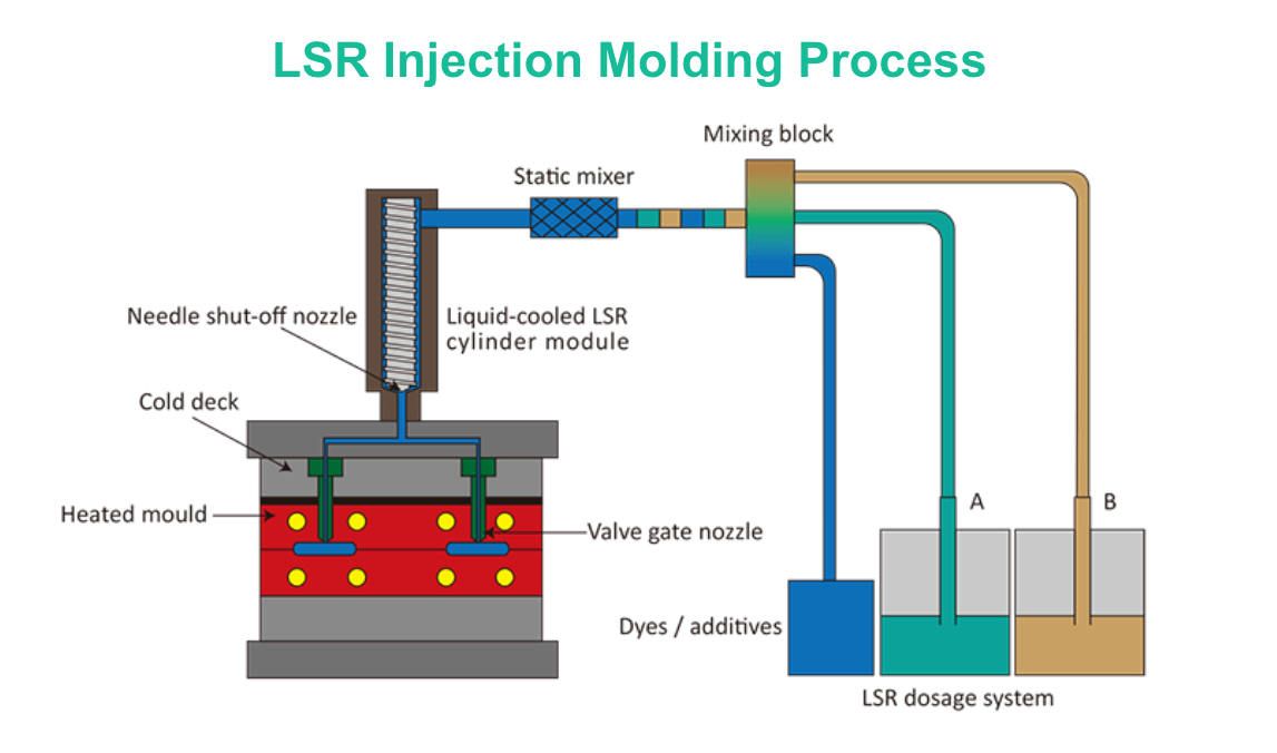

Diagram of LSR Injection Molding. Image credit: PRM-Taiwan

The LSR Injection Molding Process
The LSR injection molding process starts with precise metering and thorough mixing of components. The homogenized mixture is then injected under high pressure into a closed, heated mold, where it cures rapidly due to LSR’s thermosetting nature—enabling faster cycle times than thermoplastics. After curing, the part is ejected; in some cases, post-curing is performed to enhance mechanical strength or chemical resistance for critical applications like medical or food-grade parts.
This process depends on specialized equipment and automation to ensure quality and efficiency. Metering pumps deliver accurate proportions, static mixers create a uniform blend, and cold-runner molds keep the injected material cool until inside the mold. Automated demolding systems further optimize cycle times and reduce labor costs, making it ideal for high-volume production.

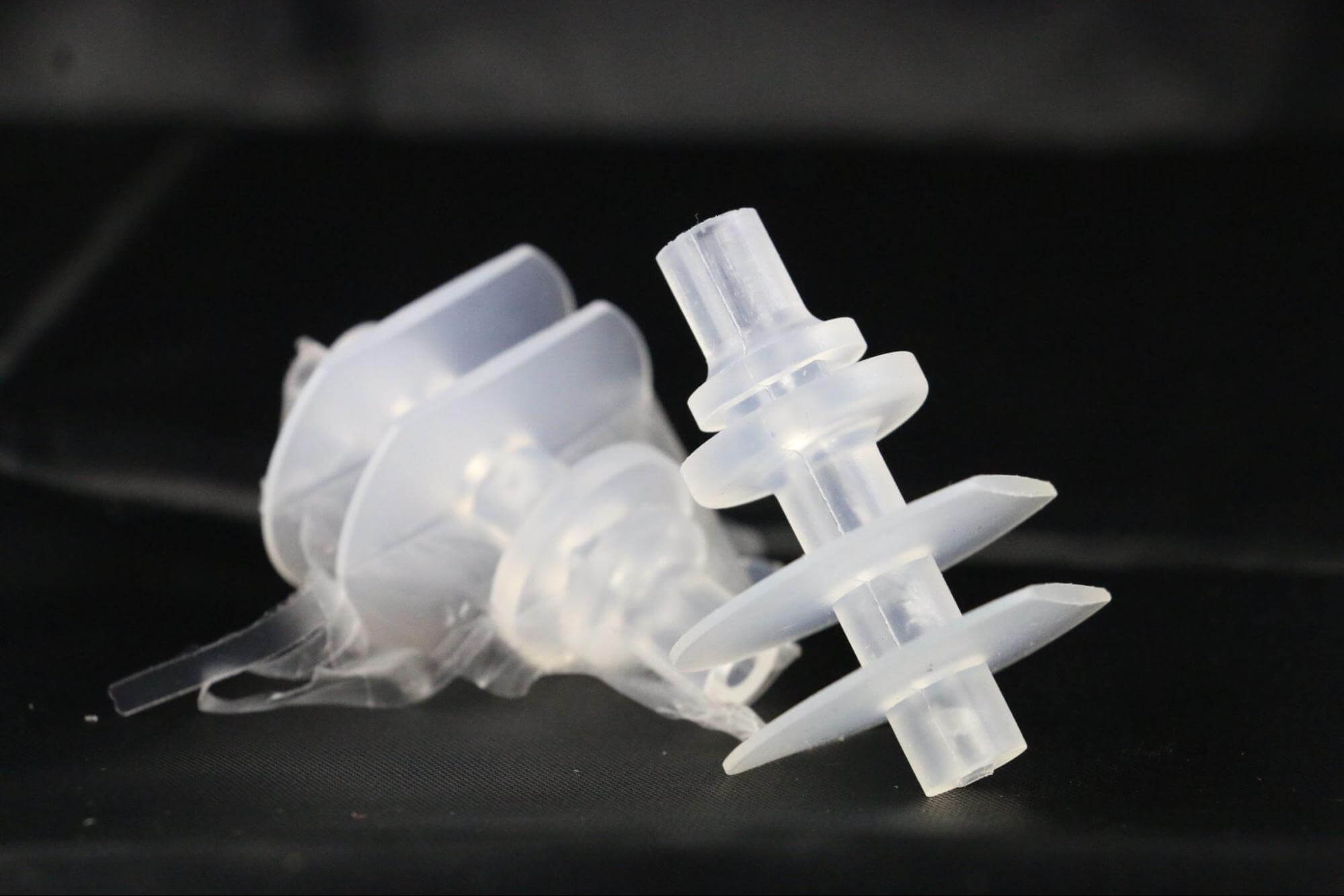

This silicone medical valve was injection molded and then cryogenically deflashed. Image Credit: Nitrofreeze
