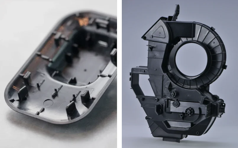

Injection molding
Injection molding is a better choice for complex parts like these.
