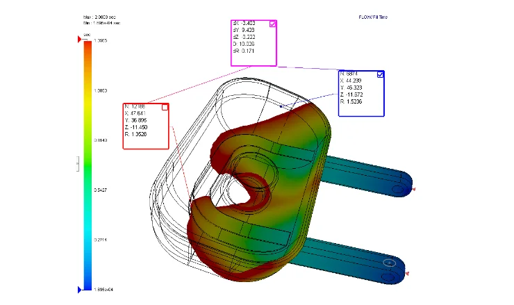

Overmolded Part Design
CAD software can support overmolding part design. Image Credit: Solidworks
How to Design Parts for Overmolding or Insert Molding
Overmolding and insert molding are sub-processes of compression molding and injection molding. That means if you’re designing a part that will be compression molded or injection molded, you need to follow the design guidelines for that process. Fictiv’s Ultimate Guide to Compression Molding contains helpful tips, and our Injection Molding Design Guide is a comprehensive e-book that you can download.
Parts that are overmolded or insert molded also have some additional design guidelines.
