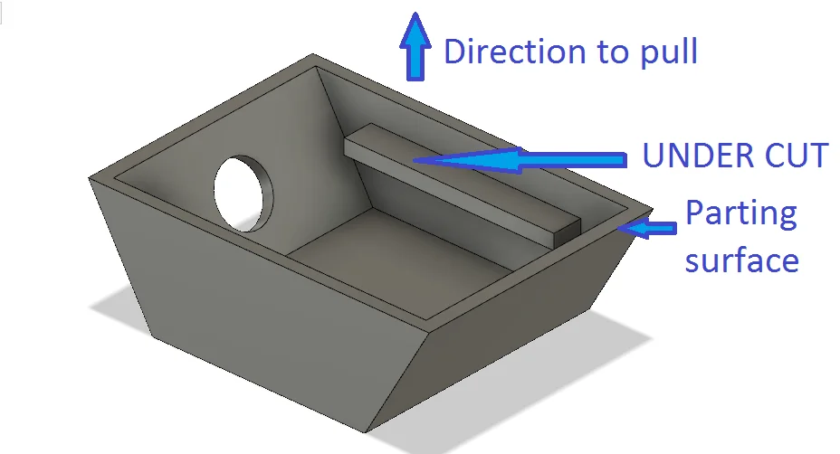

![Injection molding undercuts](https://www.fictiv.com/wp-content/uploads/2022/12/undercut.png)
Image Source: Autodesk
When to Use Sliders, Lifters, and Handloads
Undercut location is important, but it’s not the only consideration with sliders, lifters, and handloads. Slides are used to release external undercuts and lifters are used to release internal undercuts — generally with high-volume production of injection molded parts. For prototyping and low volumes where it’s not practical to invest in automatic devices, hand loads are more cost-effective.
Hand loads also can create complex features such as undercuts and threads that can’t be formed in the line of draw (the point at which two halves of an injection mold separate). Hand loads can also be used to eliminate the need for secondary operations, such as drilling-out air holes or channels.
