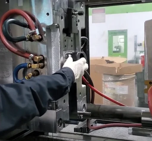

When you partner with Fictiv, your plastics project can use handloads instead of injection molding sliders or lifters. Handloads are inserts that are manually placed, or hand-loaded, into the mold to achieve features such as undercuts. The hand-loaded piece is ejected with the finished part and removed so it can be reinserted during the next injection molding cycle.
Hand loads add a labor cost to each part, but they cost less during the initial tool build than sliders or lifters. This makes hand-loading a cost-effective choice for low-volume injection molding and prototyping, and hand loads can still support complex geometries such as threads. Injection molding best practices advise against using unnecessary undercuts, but handloads can make necessary undercuts cost-effective.
Hand loads
