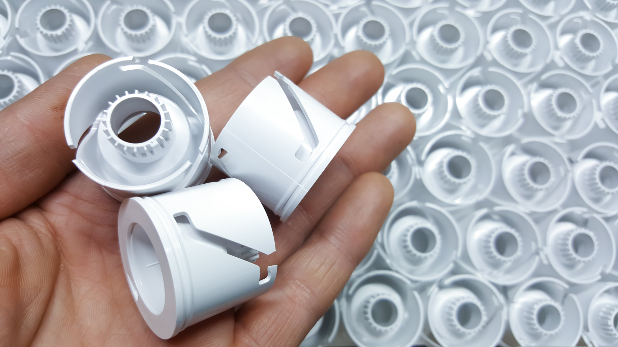

The Challenge: Avoid Unnecessary Costs and Complexity
Injected molded parts that have recessed features called undercuts are more difficult to eject during manufacturing. This adds costs and complexity to tooling, and undercuts that are too deep may be especially hard to remove. Yet, some product designs use undercuts for a fastening point or locating edge. Examples include the threads on injection-molded fasteners.
injection molding undercuts

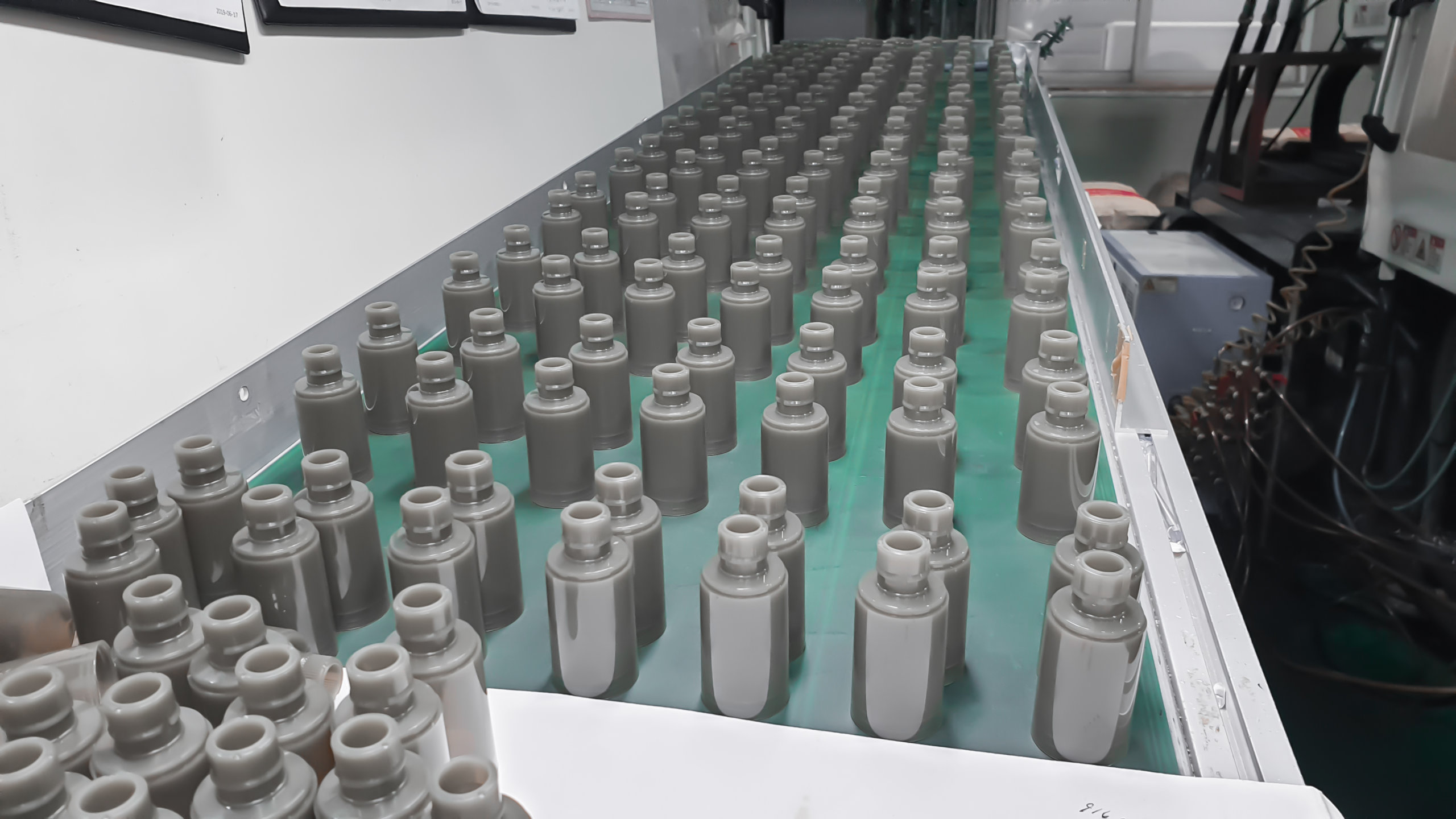

The Solution: Necessary Undercuts and Expert Design Help
When you partner with Fictiv, we’ll help you determine which undercuts are necessary for your design – and which ones are not. If your part requires undercuts, we may recommend using shut-offs, bump-offs, or sliding side-actions and cores. Moving the parting line is also an option if the undercut is on an external surface and you can adjust your draft angles accordingly.
For the internal regions and the sides of parts, shut-offs can be used. Shut-offs are also a good choice for snap-fits, and for holes and handles. Bump-offs, or stripping undercuts, can be used if the part feature is flexible enough to allow for expansion and deformation. Slide action cores are inserts that slide into the mold as it closes and slide out of the mold before it opens. They also help with part removal.
mold designs and part ejection
