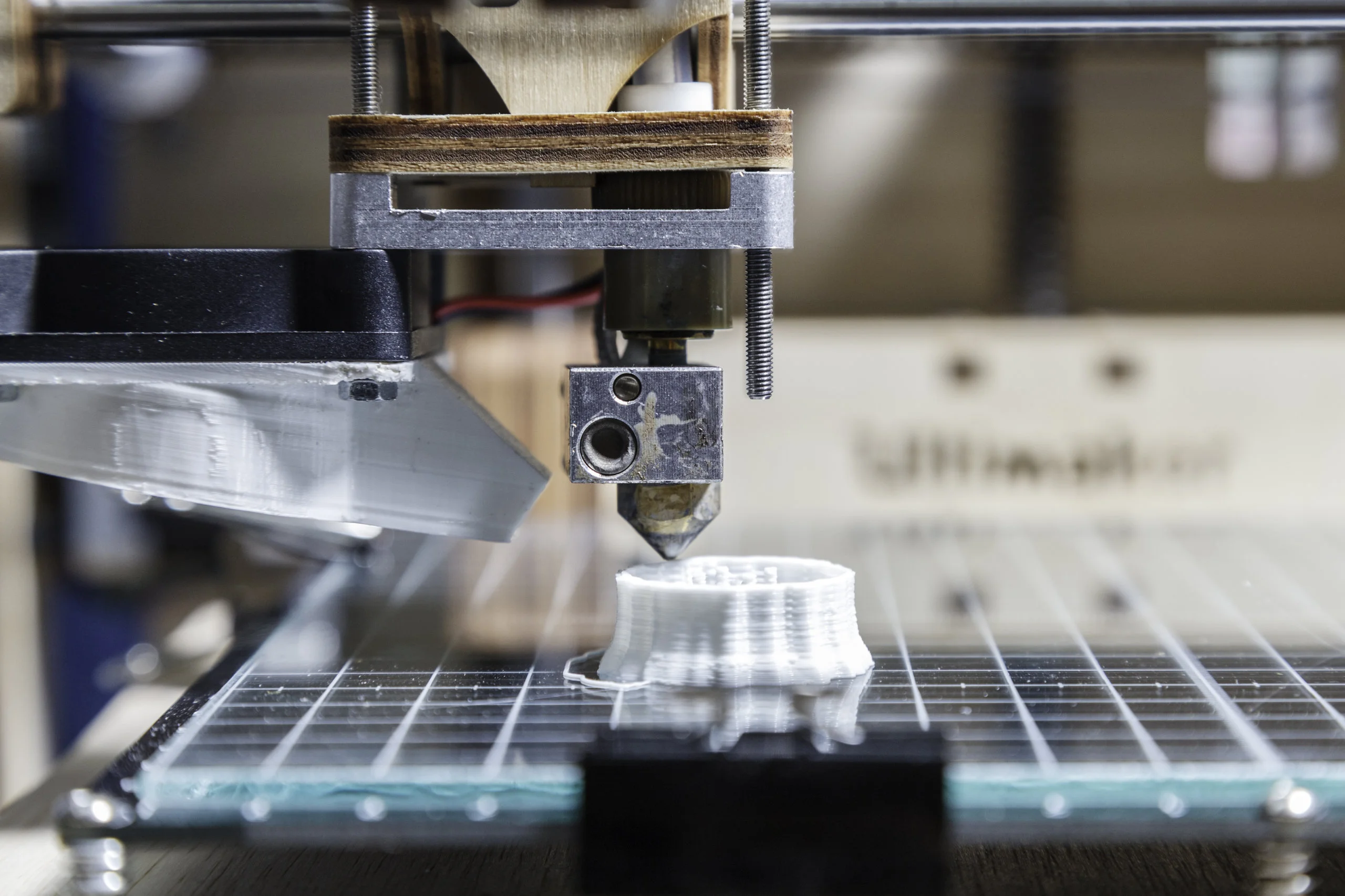

Medical injection molding and 3D printing are not mutually exclusive. In other words, there’s a role for both if you understand when to use them and for which types of prototypes. For example, alpha prototypes are essentially non-functional models. Often, medical manufacturers 3D print them so that they can see product dimensions without paying for or waiting for tooling. Beta prototypes can also be 3D printed to advance a design; however, these prototypes don’t represent the final product.
Pilot prototypes are produced to engineering specifications and can be used for clinical trials and soft launches. They’re an important milestone in the development process because they use the same material as the final product. If you’re seeking regulatory approval for a medical device, using anything but the end-use material won’t advance your project beyond the initial gates. Even when 3D printers use the same plastics as injection molding machines, 3D printed plastics don’t have identical end-use properties.

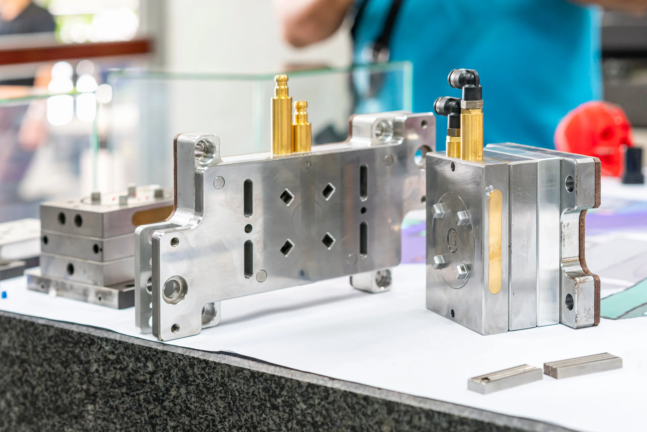

Medical injection molding for prototyping and low-volume production has its advantages, but how can you justify the cost of tooling? After all, some injection molds can cost thousands or even tens of thousands of dollars. Fictiv can produce tooling cost-effectively, however, and from either aluminum or steel. Both mold materials can be used with a master die unit and frame that includes sprues and runners, leader pins, water lines, and ejector pins. With this approach, you pay for only the mold cavity and the core details.
Family molds also provide a way to control tooling costs during medical prototyping and low-volume production. Because family molds contain more than one cavity, you can reduce tooling costs by having multiple different designs inside the same mold. Yet, a family mold can also contain cavities for different iterations of the same part instead. That’s useful during prototyping so that a designer can compare different versions of the same part.
