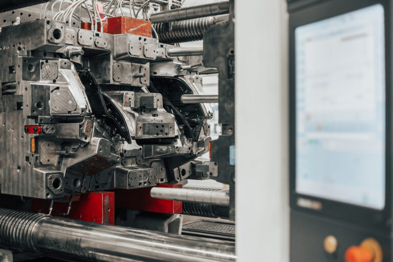

injection molding machines
Injection molding machines for lower volumes have a smaller footprint and lower clamping pressures
