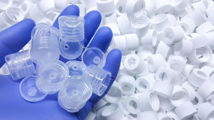

Polycarbonate Injection Molding Design Guidelines
When designing parts for polycarbonate injection molding, there are some general guidelines to follow that ensure your PC parts meet your end-use requirements.
- Wall thickness: Injection molded polycarbonate can support thin walls and complex geometries. The minimum recommended wall thickness is typically 0.040 inches (1 mm) with a maximum of 0.150 inches (3.8mm).
- Rib thickness: Ribs can be used to provide additional strength or support for polycarbonate parts. For the best results, make the thickness of a rib between 0.5 and 0.6 times the thickness of the adjoining wall. It is not recommended to use a rib height that is more than three times the thickness.
- Corner radii: Avoid sharp corners that can result in stress concentrations. With injection molded polycarbonate, use a corner radius of at least 0.125 inches (3 mm).
- Draft angle: Polycarbonate parts need a taper, or draft angle, to assist with part ejection from the mold. For many PC parts, a draft angle of 0.5° to 1° per side is sufficient. Depending on the angle and the shape of the part, however, 1° to 3° degrees per side may be needed.
- Gate location: Locate gates — the openings in the mold through which molten polycarbonate is injected — where the flow of plastic will cause the least amount of stress. A mold flow analysis can determine the optimal gate location.
- Surface finish: Polycarbonate supports gloss and high-gloss finishes, but matte finishes can be used to soften images and reduce glare in applications such as control panel overlays. Non-glossy finishes can also be used with screw caps.
