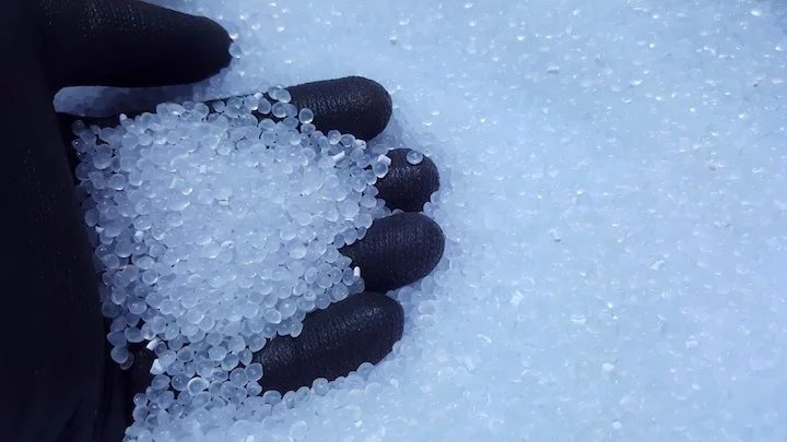

Moisture
Acrylic absorbs moisture over time. Even though it’s fine to use in wet environments, acrylic pellets must be fully dried before processing, which adds time and costs. Failing to remove moisture can result in molded parts with cloudiness, bubbles, or other surface defects. Normal drying times for PMMA are between 3.4 and 5.1 hours.
