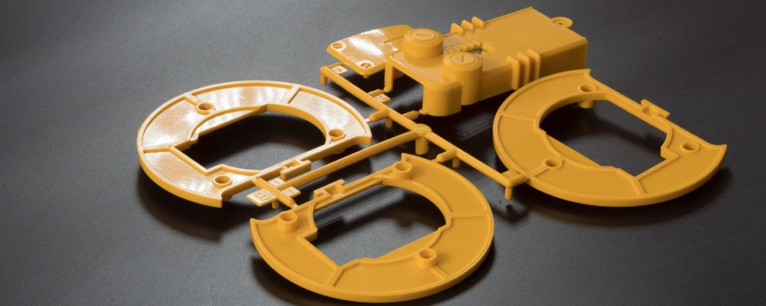

Weld lines in injection molding are a type of cosmetic defect that detracts from a plastic part’s appearance. In some cases, a weld line can also cause a loss of strength and impact resistance. Known also as knit lines and weld marks, weld lines are difficult to eliminate completely, especially if your injection molded part requires holes. Yet there are ways for designers to minimize the appearance of knit lines and their effects on injected molded products.
Part design is important, but the construction of the mold and the skill of the injection molder can also help to reduce weld line defects. Fictiv works with a global network of carefully vetted Manufacturing Partners and we provide quality tooling that’s also cost-effective, and our platform offers design for manufacturing (DFM) feedback when you request a quote. Keep reading to learn more about how to avoid weld marks in injection molding and create a Fictiv account to request an injection molding quote today.
What Are Weld Lines and What Causes Them?
During plastic injection molding, molten material flows through an opening called a gate and fills a mold cavity. The leading edge of the flow, or the melt front, may encounter obstacles such as the core pins that are used to mold holes in plastic parts. If the melt front encounters an obstacle, the flow separates and moves past it in two different streams. These streams come together again once they’ve passed the obstacle, but they might not mix. If that happens, the point of contact forms a weld line.
Sometimes, the two flows don’t mix because some cooling and re-solidification of the plastic material have occurred. Alternatively, the flows may meet in a way that their orientation to each other doesn’t readily support mixing. As the plastic flow continues through the cavity, it mixes and becomes one melt front again, but the knit line remains near the obstruction, and issues with tooling construction or plastic processing may cause it to weaken the plastic part.
