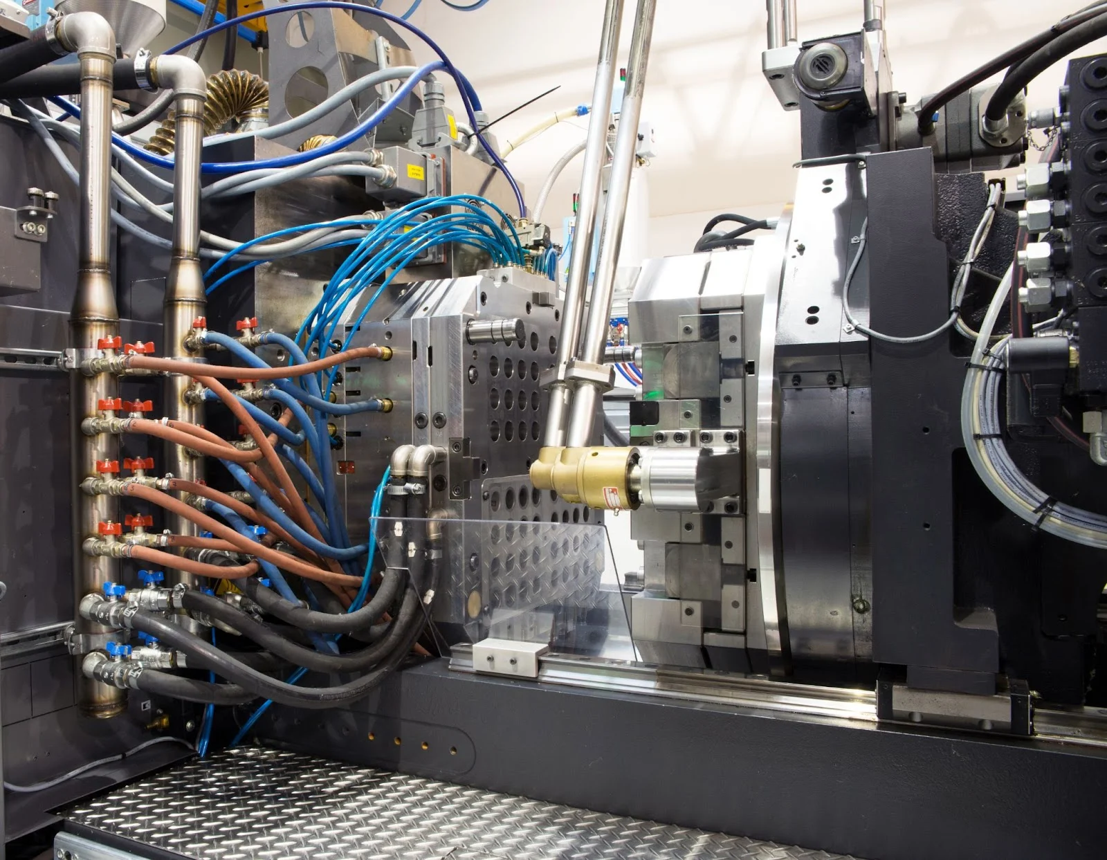

Air Cooling vs. Water Cooling
Most injection molding machines are either air-cooled or water-cooled.

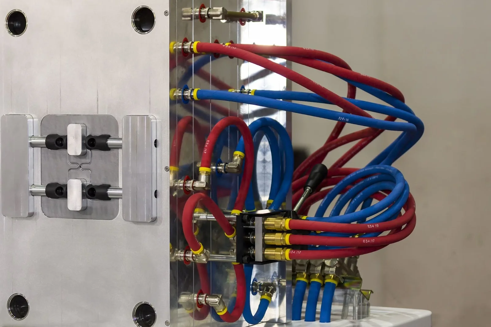

- Air cooling uses an evaporator to remove heat from the injection system and a condenser to remove heat from the evaporator. Air does not conduct heat as well as water, but electric fans can take heat away from the injection mold and blow in cooler air.
- Water cooling pumps coolant through lines on the outside of the mold cavity. For optimal cooling, these waterlines are located as close as possible to the surface of the molded part. Known as thermolators, water cooling systems require a cooling source such as a tower.
It’s important to note that the “water” used for cooling is actually a mixture of fluids. In the cooling tower for an injection molding machine, water is mixed with a biocide to prevent microbial growth. In the cooling lines near the injection mold, water is mixed with ethylene glycol to prevent the formation of rust.

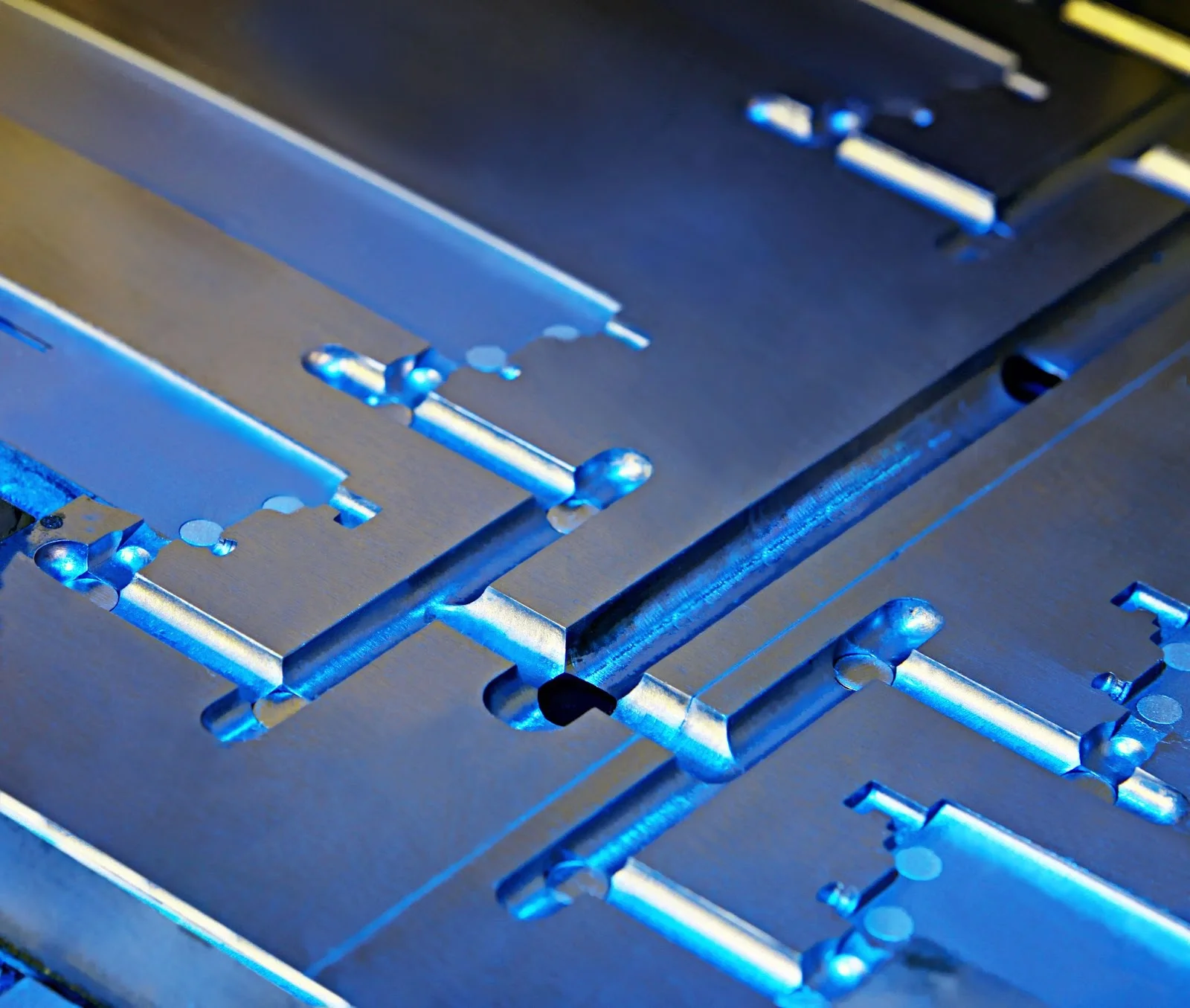

Straight Line Cooling vs. Conformal Cooling
Two types of cooling lines, or channels, are used near an injection mold: straight-line and conformal.
Straight-line cooling is the traditional, or standard method for cooling injection molds. Cooling lines or channels are machined in straight lines into metal molds. Side channels, or branches, intersect with main channels and increase the surface area that coolant can reach. After a plastic part is molded, coolant is pumped through these channels in a circuit. This cools the mold core and draws heat away from the injection molded part. Typically, straight-line cooling is used for parts with simpler geometries. Conformal cooling is used with injection molds for more complex parts. These cooling channels closely follow the shape of the cavity and are not limited to straight lines. Instead, they follow the twists and turns of the injection molded part while offering greater cooling efficiency for faster cycle times. Conformal channels also can cool hard-to-reach areas. Traditionally, the milling and welding required for conformal channels made them cost-prohibitive. Today, a 3D printing technique called direct metal laser sintering (DMLS) can be used to create these channels in a more cost-effective way.

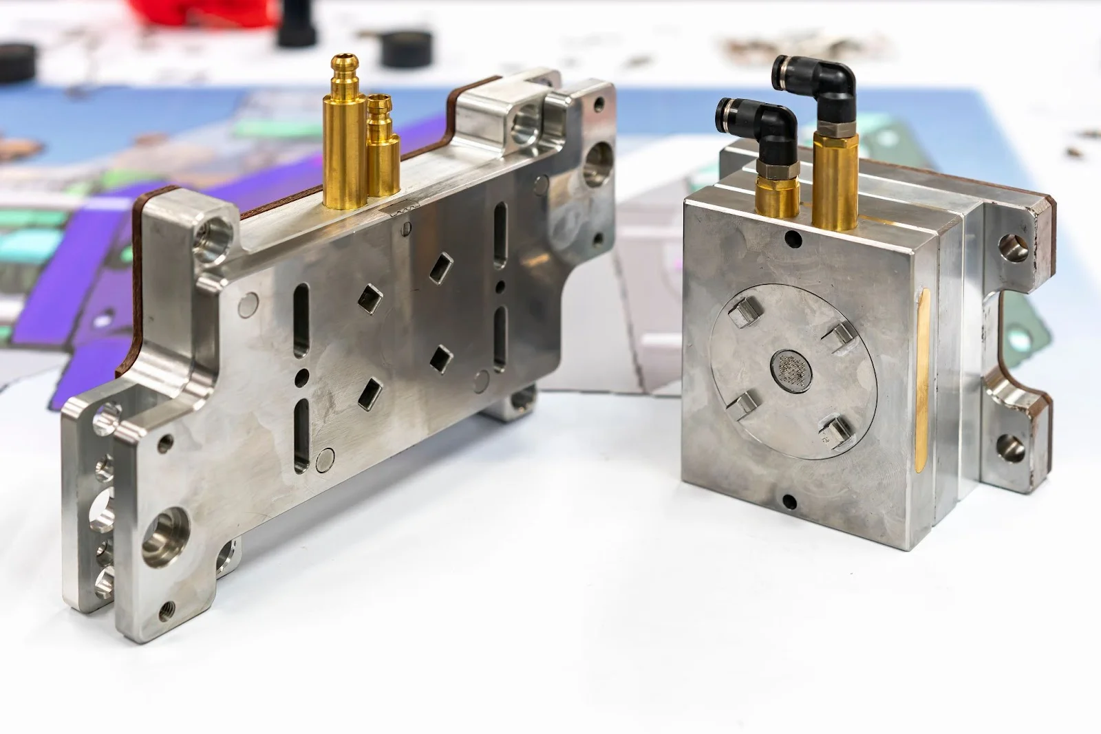

Baffles, Bubblers, and Thermal Pins
No matter what type of cooling channels an injection mold uses, hot surfaces far from cooling lines increase the risk of part defects. To create a more effective cooling circuit around the injection molded part, design features called bafflers, bubblers, and thermal pins can be used. Bafflers and bubblers are especially important with laminar flows because they help to produce turbulence, and a turbulent flow exposes more of the coolant’s surface area to the heated injection mold.

Bubblers are tubes that are fitted into drilled holes to connect coolant channels. The coolant from one channel flows into the bottom of the tube and then bubbles out the top of the tube into another channel, much like a fountain. The coolant then flows down both sides of the tube and continues its flow through the cooling system. Bubblers are usually screwed into the mold core but can also be used for cooling flat sections of the mold that do not support milled or drilled channels.
