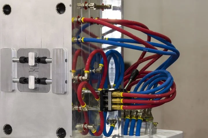

In plastic injection molding, the cooling of the mold is critical to the quality of the part. That’s because mold cooling affects the part cooling that occurs after molten thermoplastic is injected into the tool. Traditionally, cooling is achieved with cooling lines that are cut or drilled into the mold inserts to allow water or oil to flow through the mold block. These channels are cut as closely as possible to the surface of the part in order to provide optimal cooling.
Part cooling is one of the longest steps in the injection molding process and, therefore, has a considerable impact on part costs. Proper cooling can also make the difference between a quality part and one that has issues with warping, weld lines, and material degradation. Injection molded parts that are not cooled correctly tend to have inconsistent material shrinkage and, therefore, develop defects. Material that cools too quickly will increase the flow-front welding and cause weld lines or knit lines in the final part. Material that is not cooled quickly enough will begin to degrade and lose some of its physical properties.
cooling lines
Although traditional cooling lines require drilling or milling, an advanced method called conformal cooling has become more mainstream over the past 10 or 12 years. Conformal cooling can be achieved with split inserts that are milled and soldered back together; however, this process is challenging and can reduce tool life.

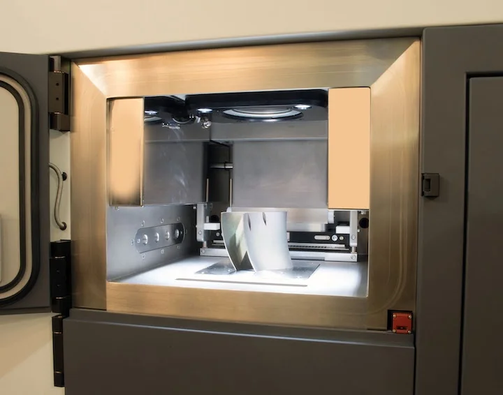

Today, the most common way to produce conformal cooling lines is by 3D printing inserts with direct metal laser sintering (DMLS), or a similar process. With DMLS, you can 3D print an insert where the cooling lines are modeled directly into the insert and are printed at the same time as the insert itself. This allows for more complicated shapes and for the cooling lines to be closer to the part cavity than is possible with milling or drilling.
