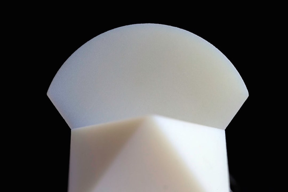

The tool in injection molding, the injection mold, has two main parts: the core and the cavity. The parting line is where the two parts meet, and the direction of their movement is called the mold pull. In the image below, the line on the side of the toy soldier shows where the two halves of the mold came together.

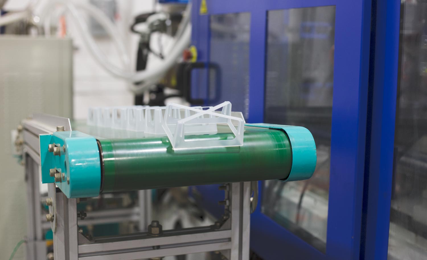

During the injection molding process, molten plastic (the charge) enters a nozzle and then passes through a sprue and runner system. This molten plastic then enters the mold through openings called gates. After the plastic cools, the molded part is ejected from the tool, typically with ejector pins.
