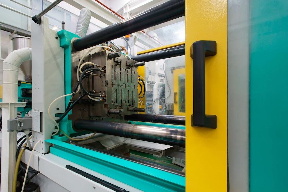

The low-volume injection molding process begins when plastic pellets or granules are poured into a hopper that’s connected to an injection molding machine. Typically, this equipment is smaller than the machinery used with high-volume injection molding. In addition to a smaller footprint, low-volume injection molding machines are designed for faster changeovers because the production runs are smaller.
After the plastic pellets or granules leave the hopper, the feedstock is dispensed into a barrel where the plastic is heated and melted into a liquid. A large reciprocating screw pushes the molten material toward the lip of the barrel while raising the injection molding pressure and temperature. As with high-volume injection molding, achieving and maintaining the proper temperature and pressure is essential for avoiding injection molding defects.
Filling the Mold
When enough material and pressure build up inside the barrel, a ram pushes the screw toward the injection mold. This forces a “shot” of plastic out of the barrel into a system of channels in the mold called “runners.” From the runners, the molten plastic passes through openings called “gates” and into the mold cavity. This hollow section of the mold fills with plastic, which then cools.
There are two types of runner systems in low-volume injection molding: hot and cold. Hot runner systems cost more but help reduce defects associated with fluctuating pressure levels and underfilled molds. Cold runner systems cost less but tend to generate more material waste. Still, the cost-effectiveness of cold runner systems can make them attractive for low-volume injection molding projects.
Ejecting the Part
When an injection molded part is ready, the mold is opened and the part is released with ejector pins that are attached to the mold core. Sometimes, part ejection also requires hand loads or sliders and lifters. Sliders release external undercuts—recesses or projections on a part’s outer surface that prevent direct removal from the mold cavity. Lifters release internal undercuts instead.
Hand loads cost less than sliders or lifters, but still add injection molding costs since each hand load must be removed from a molded part and then returned to the tool during the next molding cycle. Nevertheless, hand loads are a cost-effective choice for low-volume injection molding for prototyping or production. These release mechanisms can also support complex part geometries such as threads.
Post-Processing
After injection molding is complete, post-processing may be required. For example, excess plastic material called “flash” may escape between the parting line where the mold’s core and cavity meet. Some amount of flash is expected, but excessive flash requires removal because it mars part surfaces. A skilled injection molder can reduce the incidence of flash.
Clamping pressure is the force needed to hold the injection mold closed. If pressure isn’t set high enough, the mold may open prematurely and produce flashing. Yet the injection mold also needs to be able to withstand the clamping pressure from the injection molding machine. Typically, the smaller equipment for low-volume injection molding has a lower clamping pressure than a high-volume injection molding machine.

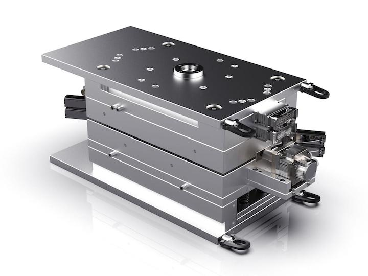

Standalone Molds vs. MUD Molds
For low-volume injection molding, you can choose either standalone molds or MUD molds. There are advantages and disadvantages to each.

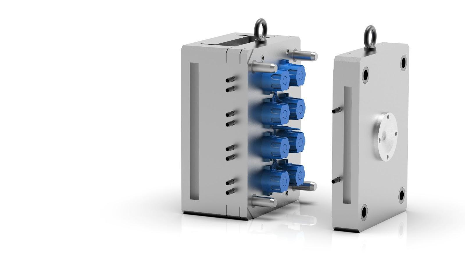

Standalone molds include the core, cavity, and all of the other tooling components needed for plastic injection molding. This includes metal plates for mounting the mold within the injection molding machine. Molds with more components have higher tooling costs, but the only practical limitation on part size is the size of the injection mold that the machine will support.
Master unit die (MUD) inserts, or MUD molds, are universal frames that fit into an injection molding machine and hold a removable insert. The frame size limits the maximum part size, but MUD inserts can reduce up-front tooling costs since you’re using an existing frame. Your mold production costs are also lower because only the removable core and cavity require machining.

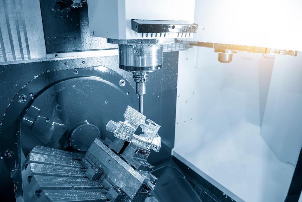

Mold Design and Mold Manufacturing: CNC vs. EDM
There are two main ways to make low-volume injection molds: computerized numerical control (CNC) machining and electrical discharge machining (EDM). CNC machining is used more commonly and features a sharp cutting tool that removes metal. EDM machining uses electrical discharges (sparks) to cut through the metal instead. There are advantages and disadvantages to both mold manufacturing methods.
CNC machining is faster than EDM and is recommended for low-volume injection molds where the mold design includes ribs. When five-axis (or greater) mills are used, CNC machining is also a good choice for complex geometries. EDM machining is slower, but it’s used when sharp internal corners are needed and very deep cuts are required. EDM machining is also used to produce molds for parts that require a mirror finish.
