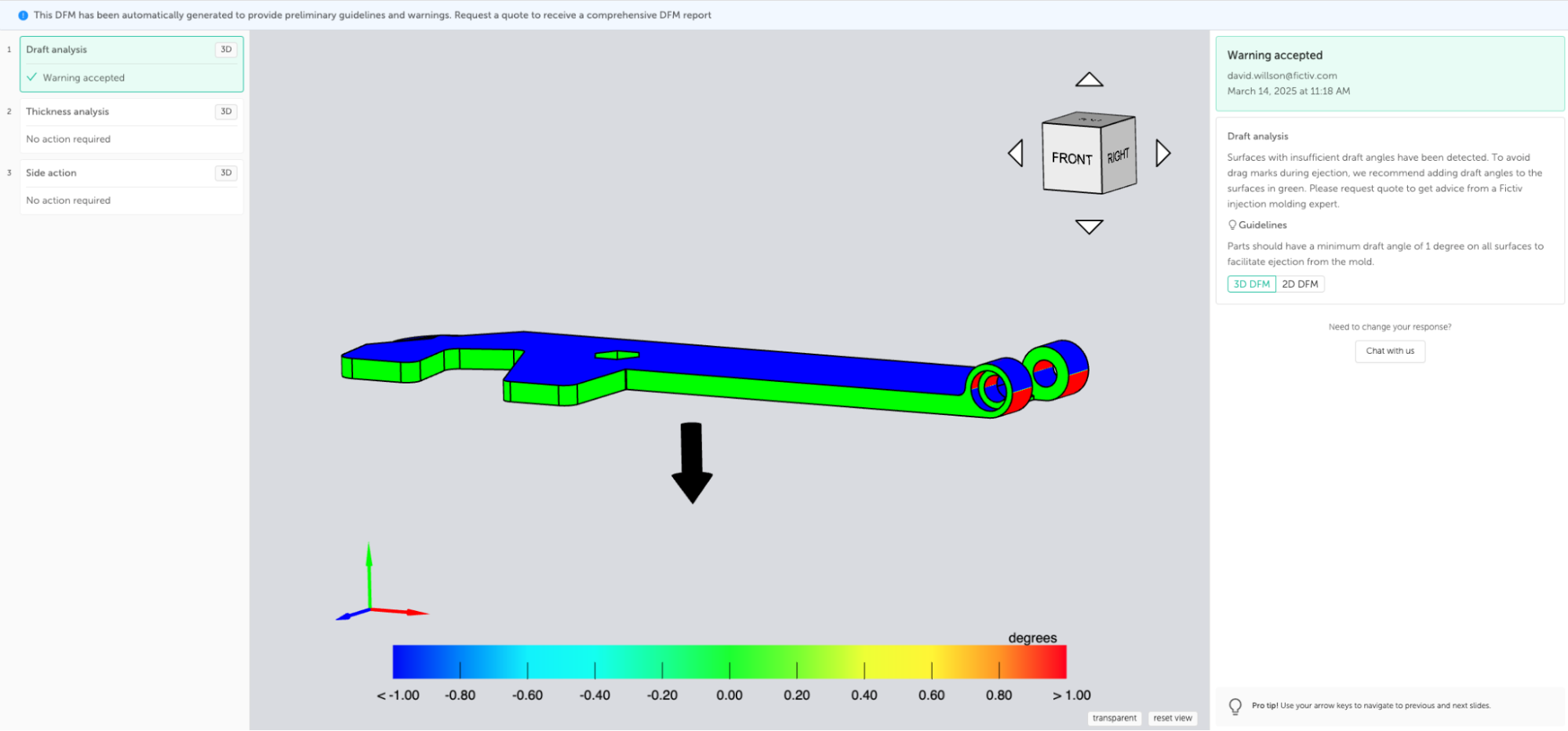

Fictiv offers instant DFM feedback through the quoting platform, and expert advice on best practices through design feedback.

- DFM benefits injection molding processes by pointing out potential changes that can reduce wall thickness variations, thus improving mold flow.
