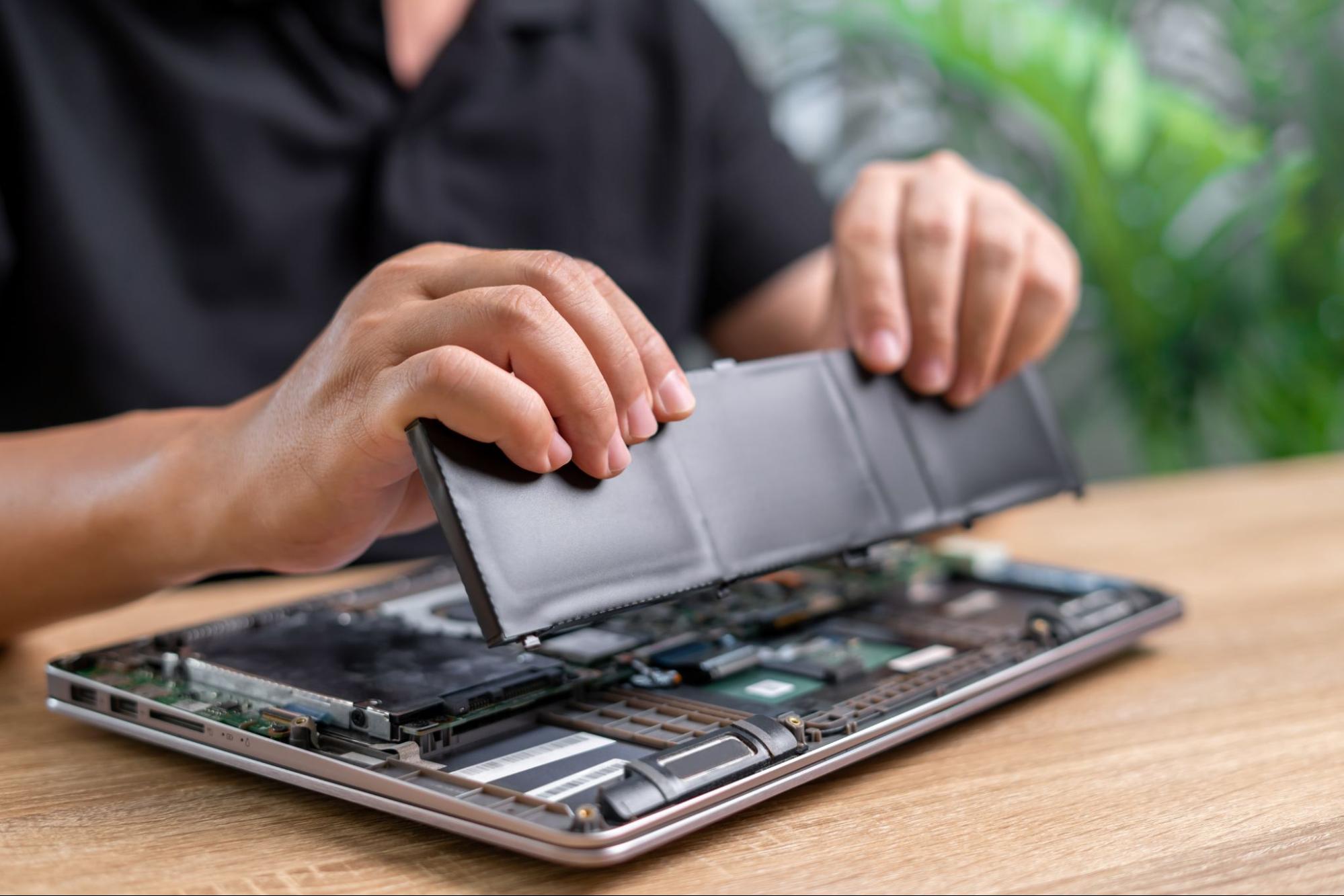

Laptop being serviced for battery replacement.

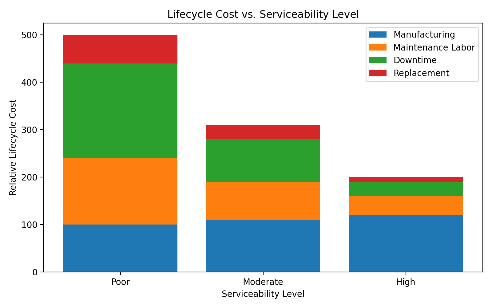

Two systems can have identical reliability yet very different lifecycle costs depending on how quickly issues can be identified and corrected. Insufficient access, non-modular layouts, and inconsistent interfaces extend service time and increase downtime even when failure rates are low.
From the customer’s perspective, these effects compound. Long repair times lead to lost productivity, missed availability commitments, and reduced confidence in the product—outcomes that warranty terms alone rarely offset.
For these reasons, Design for Serviceability must be addressed early in product development. Once enclosure layouts, module boundaries, and interface strategies are fixed, most service time, cost, and operational risk are effectively determined. Designing for access, replacement, and diagnosis is not a late-stage refinement; it is a fundamental design choice with long-term economic consequences.
Illustrative lifecycle cost distribution by serviceability level

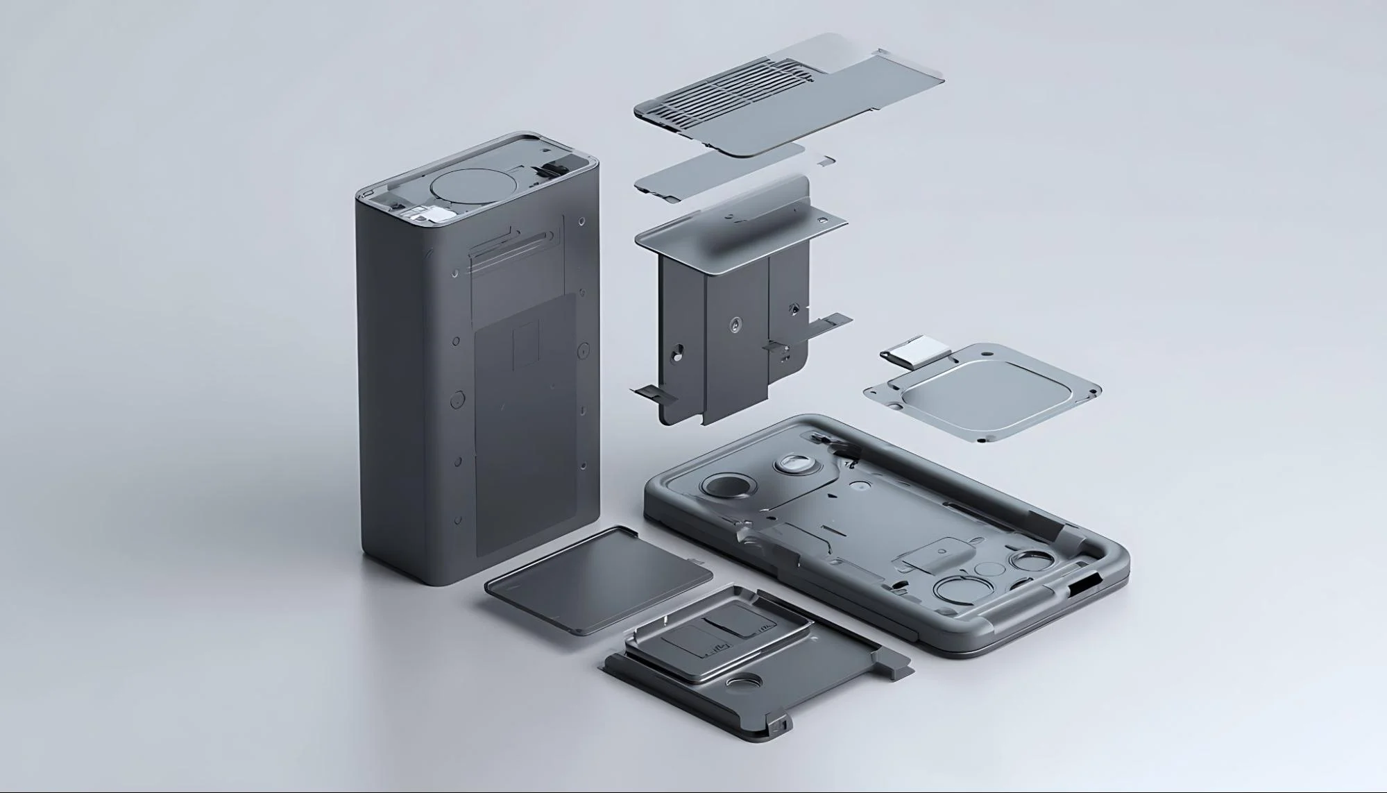

Modularity, Architecture, and Part Partitioning
Poor serviceability often occurs when a single worn or failed component is buried behind unrelated systems, forcing unnecessary teardown. Intentional modularity groups these components by service frequency and wear risk rather than function alone.
Items such as filters, batteries, fans, seals, sensors, and electronics should be placed in dedicated service zones or carriers that allow direct replacement without disturbing surrounding assemblies. Designing around these service realities reduces downtime and helps extend system life by keeping repair economically viable.
Clear module boundaries make it obvious where a serviceable unit begins and ends—interfaces are standardized, fasteners are accessible, and removal does not require partial disassembly of adjacent modules. Unclear boundaries increase service time and error risk. Clear boundaries also simplify spares and upgrades.
Modular design for increased serviceability

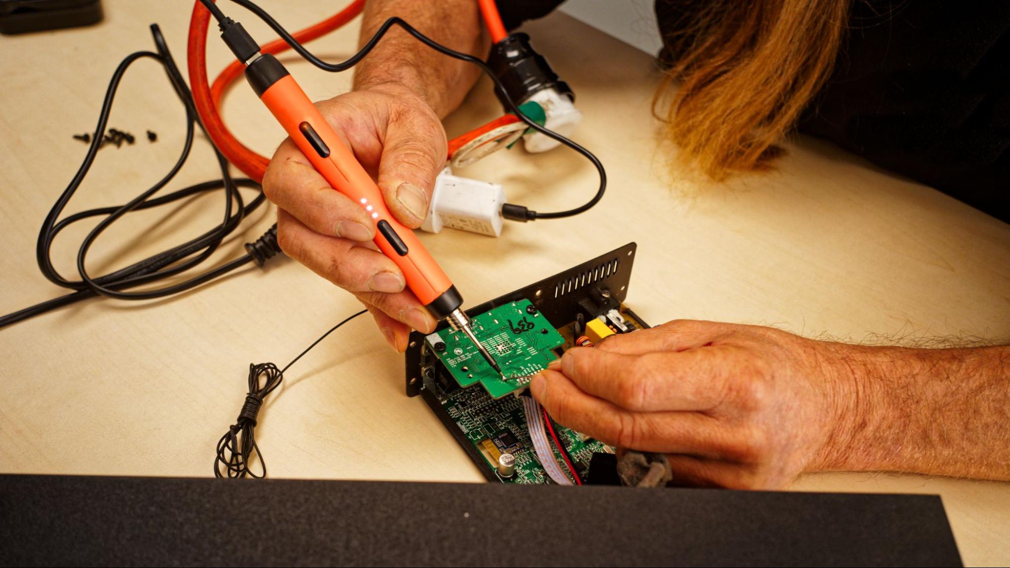

A repair facility servicing a consumer electronics product.
