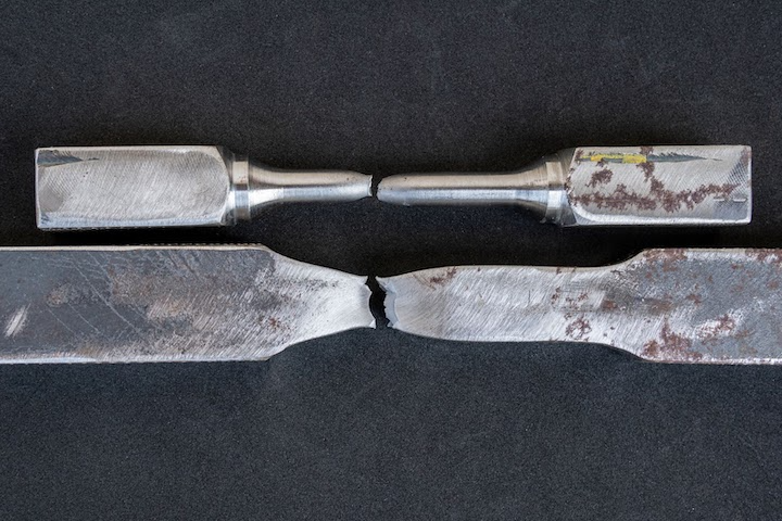

Common Failure Modes and Their Engineering Implications
A proper understanding of various approaches to prevent failures is essential. Here are some common failure modes and their engineering implications:
  • Mechanical Wear and Fatigue: Occur from repeated stress, damaging components like bearings or solder joints.
  • Creep and Deformation: Time-dependent deformation under sustained stress and elevated temperature (e.g., turbine blades slowly elongating in jet engines).
  • Thermal Stress: Common in electronics and machinery. Warps materials or degrades semiconductors when heat dissipation is insufficient.
  • Environmental Factors: Moisture, chemicals, and UV radiation cause corrosion and material breakdown.
  • Electrical Failures (e.g., short circuits, insulation failure): Often originate from manufacturing defects or poor design.
  • Software/firmware Issues:  Can trigger systemic failures without rigorous testing.

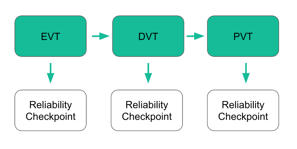

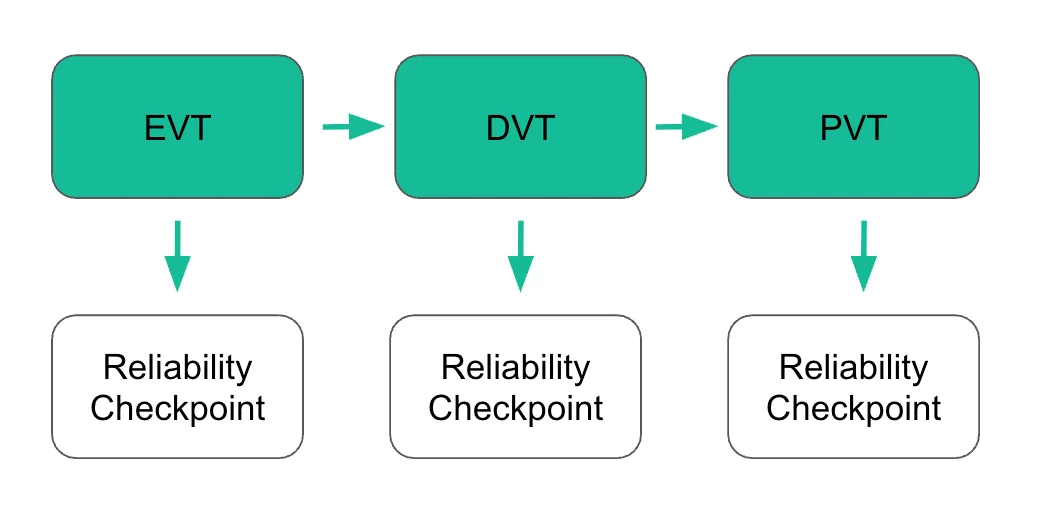

Integrating DFR into the Product Development Lifecycle
Reliability must be designed into new products from the start and systematically enforced throughout development. Integrating DFR throughout the product development process, including engineering validation test (EVT), design validation test (DVT), and production validation test (PVT) phases is crucial for delivering robust, high-quality products that perform consistently over their intended lifespans. These pre-production hardware testing methods, also known as parts of the Stage-Gate process, can be categorized into three points:
  • EVT (Predictive): Identifies risks using FMEA/FTA, physics-of-failure modeling, derating studies, and prototyping. Sets reliability benchmarks when changes are cheapest.
  • DVT (Empirical Validation): Pushes design limits via stress testing to induce failures, map thresholds, and refine designs in a pre-production environment.
  • PVT (Process Control): Ensures reliability carries into mass production via Process FMEA, Statistical Process Control (SPC, Repeatability, Highly Accelerated Stress Screening (HASS), validation, and continuous testing.
This integrated DFR approach creates a feedback loop where field data informs future efforts, continuously improving reliability. It reduces late fixes, warranty costs, and protects brand reputation.
 Design for Reliability Checkpoints
