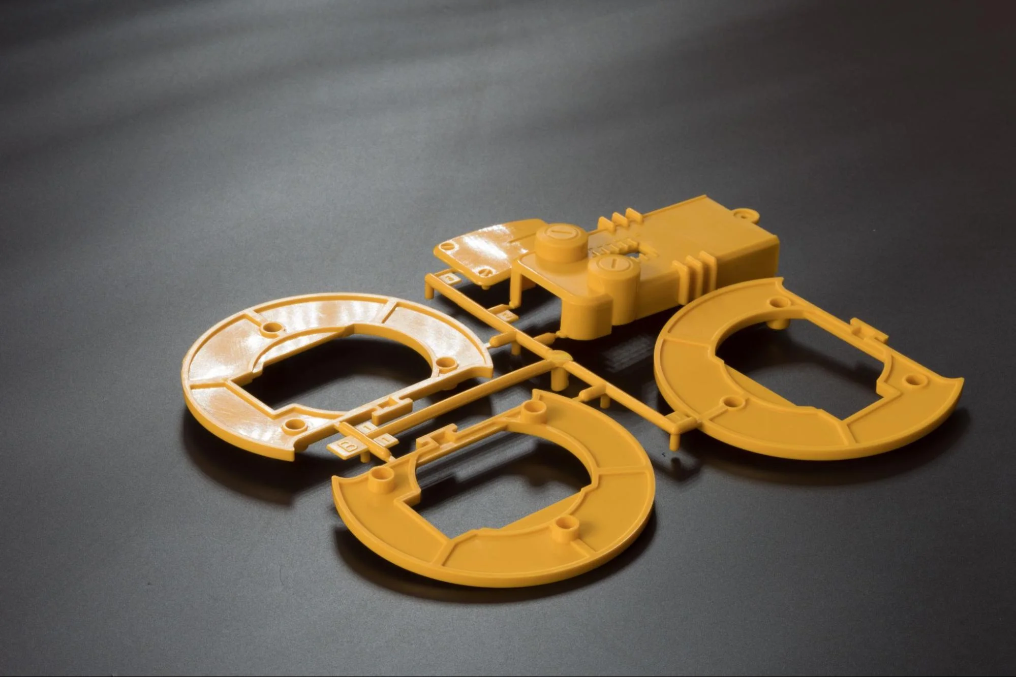

Different parts molded in a four-cavity family tool.
What Is Family Tooling?
Family tooling refers to a type of injection mold that contains multiple cavities, each designed to produce a different yet similar component in the same injection cycle, or shot. This approach differs from the use of single-cavity molds, which produce only one part per shot, and multi-cavity molds, which produce several identical parts per shot.
Family molding is particularly valuable for assemblies where multiple components are always used together—such as the top and bottom halves of a housing, or a frame and its cover. By integrating these parts into one mold, manufacturers can produce complete assemblies in less time and at a lower cost compared to if each part were molded separately.

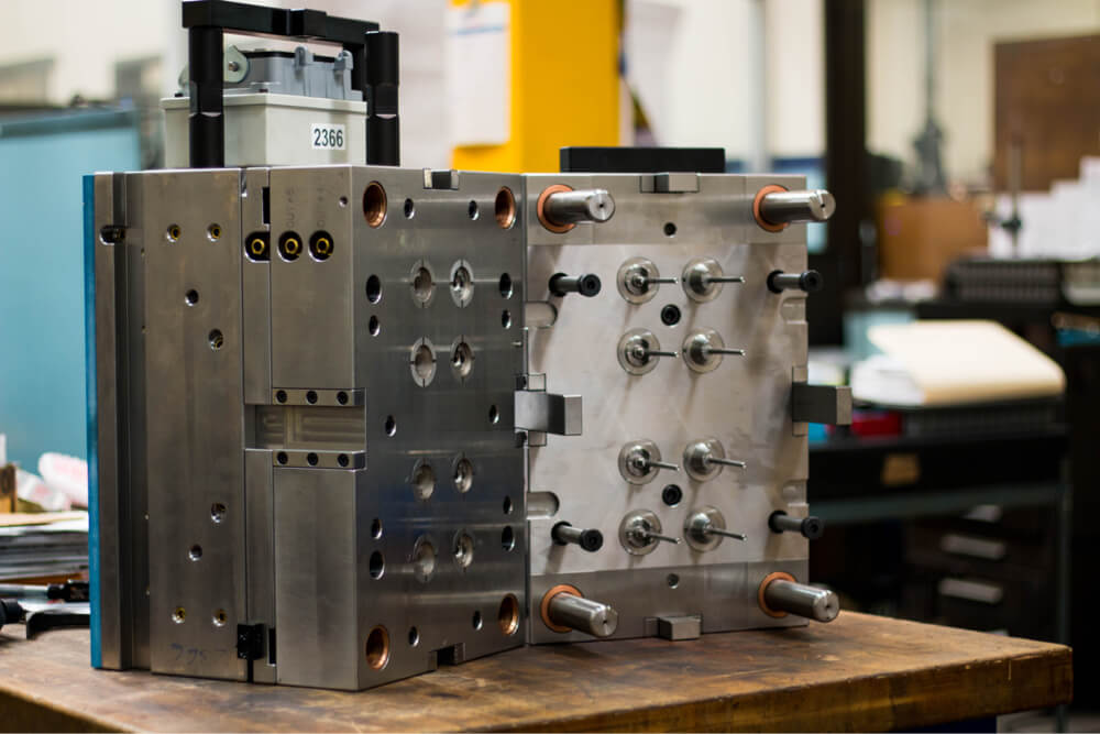

Mold Design and Layout
Engineers begin by designing the mold to house the cavities for the multiple component types to be contained within a single mold base. Each cavity is precision-machined to match a different required part geometry. Key layout considerations include:
  • Part placement to balance the mold’s mechanical and thermal performance
  • Runner length and gate positioning to ensure that each mold cavity fills simultaneously and completely

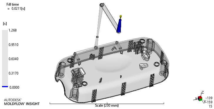

Because the part cavities differ in size, volume, and shape, engineers must account for these variations—a challenge that requires the use of simulation tools (e.g., mold flow analysis) and meticulous design.
Balancing Material Flow
Inconsistent fill across cavities can result in some parts being fully formed while others are incompletely filled, warped, or have excessive flash. To ensure even material distribution, mold designers often use mold flow simulation software to test different runner and gate placement strategies. Some key considerations for balancing material flow are:
  • Runners must be designed to deliver equal pressure and flow to each cavity.
  • Gate sizes might be adjusted based on each part’s volume.
  • Flow restrictors or baffles may be used to slow the flow to smaller cavities.
If a large part and a small part are molded together, engineers may need to adjust runner paths or gate areas so that both parts fill at the same rate and pressure, reducing the risk of defects.
Mold flow analysis is critical for family tooling.
