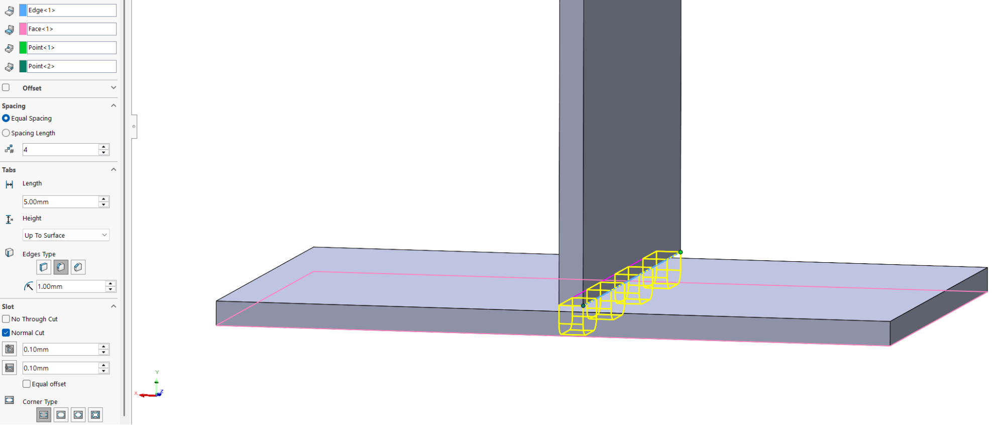

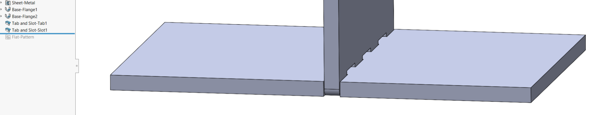

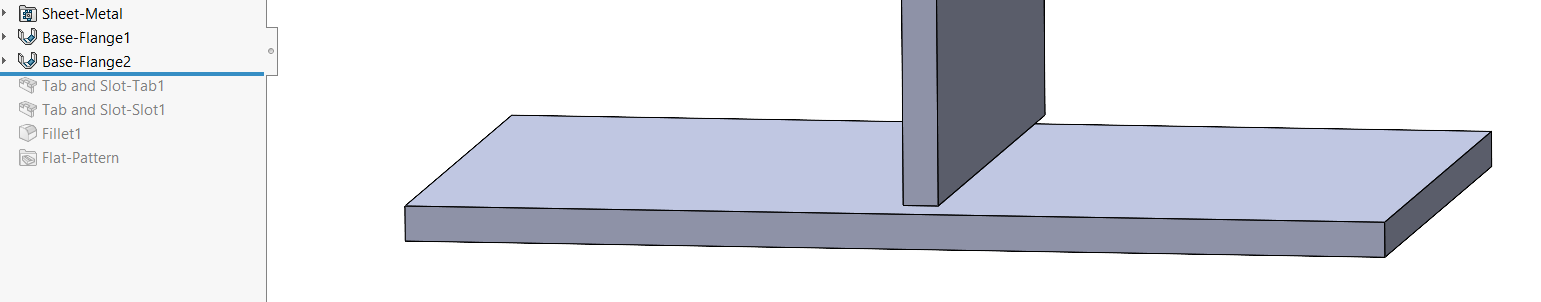

Designing Tabs and Slots in CAD
Tabs and slots can be built into CAD fairly easily with patterned features or built-in tools specifically for this application. SolidWorks has an option in the sheet metal tool that helps automate the design of these features, as shown in a brief walkthrough below:
  1. Create your base flanges, ensuring proper clearance.
SolidWorks tab and slot design base flanges
  1. Create a tab and slot feature, specifying the edge, end face, length, and end type
SolidWorks tab and slot feature
  1. You now have your mating tab and slot features that will show in the flat pattern. You can add any additional rounds or chamfers to remove stress concentrations or break edges.

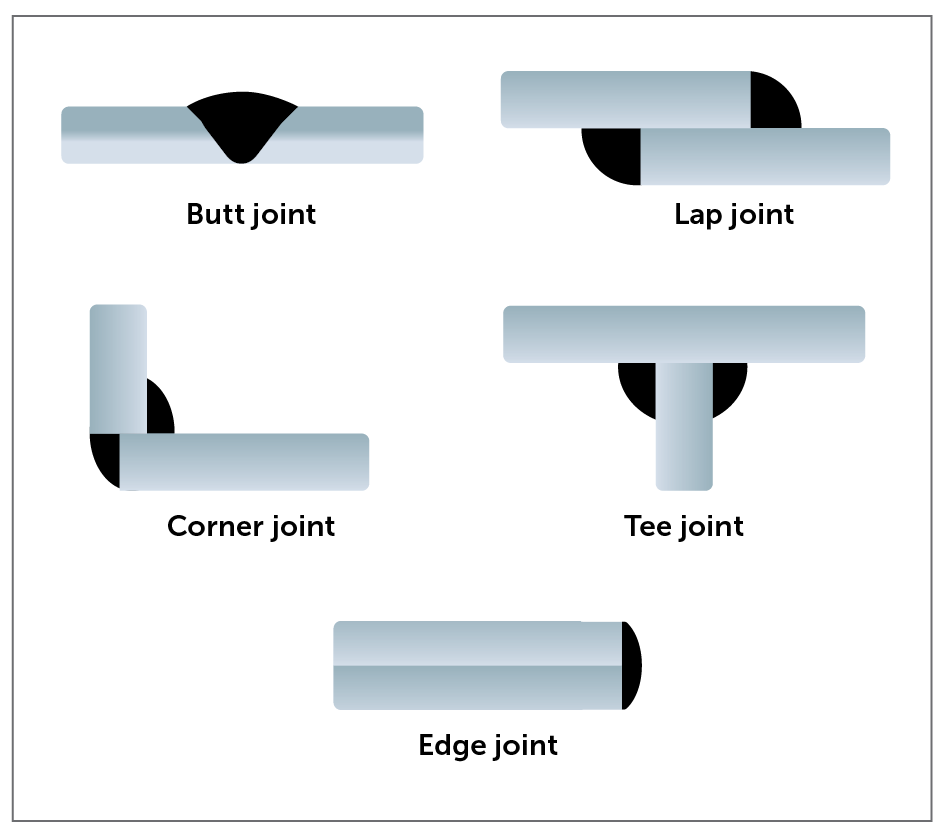

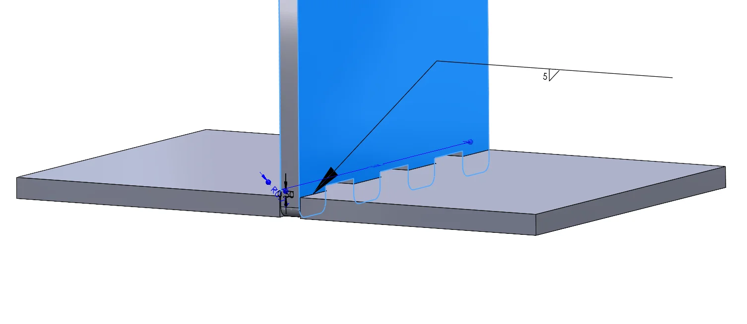

Tab and Slot Integration for Welding
When used in welded assemblies, tabs and slots act as self-fixturing features, temporarily holding components together and maintaining alignment while tack welds are applied. This improves efficiency and accuracy, particularly in thin-gauge or precision sheet metal assemblies.
Maintain 0.1–0.15 mm clearance per side to accommodate weld shrinkage of the base material as the joint cools, and avoid oversized slots that lead to thin weld sections or trapped molten metal. For parts requiring micron-level alignment, combine interlocking tabs with reference holes or pins.  Alternate tack locations (e.g., Tab 1 and Tab 3, then Tab 2 and Tab 4) to balance thermal stress and reduce warping.
Joint TypeRecommended Tab/Slot DesignWelding Notes
Corner JointTabs located along 90° bends or outer edgesMaintains visual alignment of external faces and simplifies tack weld access.
Tee JointSlots positioned along the centerline of the base plateProvides accurate vertical alignment of the perpendicular part and consistent weld penetration along the joint.
Lap JointOffset tabs and matching slots between overlapping platesEnhances lateral rigidity and shear strength, but vertical movement can still occur unless supported by additional weld beads.
Butt JointInterlocking tabs across the joint lineEnsures edge-to-edge alignment for flush welding; ideal for flat panels requiring a continuous surface finish.
Recommended Tab-and-Slot Configurations for Common Welded Joint Types
