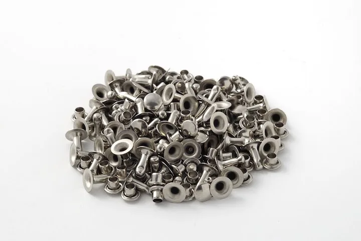

A rivet is a permanent mechanical fastener that is designed to join two or more parts together, and there are numerous types of rivets. Each rivet is composed of a head, a shank, and a tail. To install, a rivet is inserted into a slightly oversized hole, then undergoes a process that permanently deforms it via a compressive force. This permanent deformation is achieved using a range of tools that are dependent upon the type of rivet being used.
In general, rivets are installed via pneumatic or manual hammering, hydraulic pressing, and handheld rivet guns that are either manually or pneumatically operated. When selecting rivet sizes, it’s critical to consider the grip length and the size of the hole. Many different grip lengths are available for each hole size to accommodate different sheet thicknesses. Rivets are typically made from either aluminum or steel, though other materials like copper are also used. Industries that most commonly rely on the use and function of rivets include the automotive, aerospace, marine/naval, construction, aviation, and manufacturing industries.

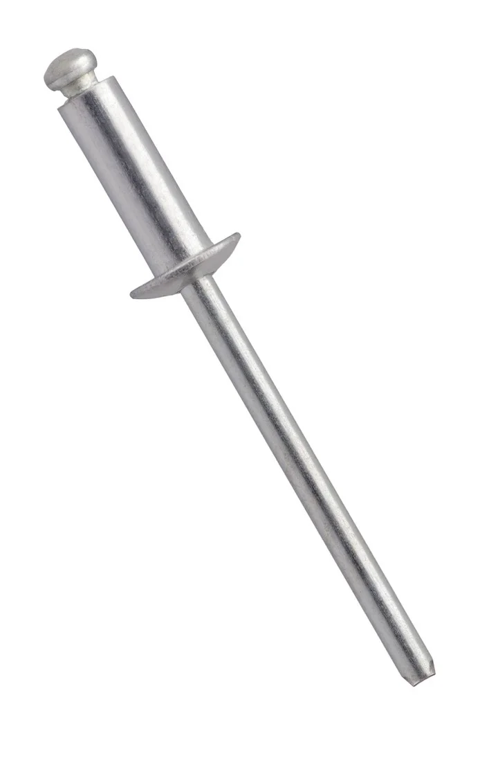

A blind rivet is the most recognizable type of rivet, and is also referred to as a pop rivet. These rivets are used when there is no access to the rear of the two parts being fastened. A blind rivet assembly consists of a shank and a stem. To install, the thicker shank is placed into a precisely drilled hole, and a handheld or pneumatic rivet gun is used to pull on the stem, which has a slightly larger diameter on the end of the shank. The pulling action causes the shank to plastically deform and clamp the two parts together.
The stem is designed to snap off at a specific clamping force and this snapping creates an audible popping sound, hence the name pop rivet. Blind rivets are supplied with an open-end, closed-end, large flange, grooved, and countersunk flanges. Blind rivets are often used on sheet metal constructions.

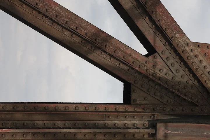

Solid rivets are the oldest form of rivets, and have been used on ships and large steel structures like bridges. A solid rivet consists of a shank and a head. The head can be rounded, conical, countersunk, flat, or oval. To install, solid rivets are placed into a pre-drilled hole, then a hammer or a rivet gun is used to permanently deform the straight end into the required head shape.
In some cases, the rivet is softened by heating it until it’s red hot, which aids the deformation process. During deformation, the shank expands to fill any clearance in the drilled hole, then forms a second head to clamp the two materials firmly together. This type of rivet is robust and is used in critical applications such as vehicle bodies or structural members.
