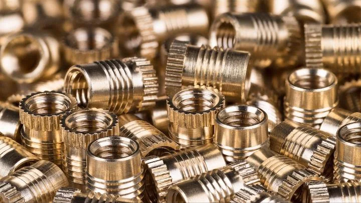

Heat Inset Thread Inserts
Heat-inset metal thread inserts come in various designs, with some featuring male threads and others with female threads. Regardless of the thread type, all insert designs have bosses on the external diameter to help embed them securely in the heated, softened plastic. Many varieties of off-the-shelf insert designs are available from suppliers, but they all achieve the same end goal.
Heat inset thread inserts are typically made from brass because it’s easy to manufacture and is an excellent thermal conductor — meaning it transmits heat more effectively for easier installation.
Installation with Applied Heating Via Soldering Iron
Heating is the recommended method for installing these types of inserts, as it results in the most secure connection. The inserts are designed to be heated just enough to melt the surrounding plastic during installation. This molten plastic then flows around the bosses on the outside diameter of the insert, creating a secure mechanical lock once cooled. The process starts with placing the insert on a slightly undersized hole. A soldering iron is then held against the insert until it’s hot enough to be pressed into the part.
Pro-Tip: There are off-the-shelf inserts designed to nest into specific soldering iron tips, like this one. Also, always check for material compatibility and ensure your soldering iron settings are high enough to sufficiently soften, but not thoroughly melt the 3D-printed part.
Installation of a Pre-Heated Insert with a Drill Press
Alternatively, inserts can be secured on the end of a threaded rod attached to the chuck of a drill press. Inserts can be heated with a butane torch, and then precisely installed in the part. This method results in inserts perpendicular to the part, and their depth can be precisely controlled. However, the drill press must not be lifted before the plastic has cooled, as this risks pulling the insert out.
Installation Using an Ultrasonic Soldering Iron
Ultrasonic soldering irons can also be used to install inserts. These irons work by vibrating the inserts at a high frequency, which causes the plastic to melt wherever it contacts the insert — allowing for precise heating and installation.
