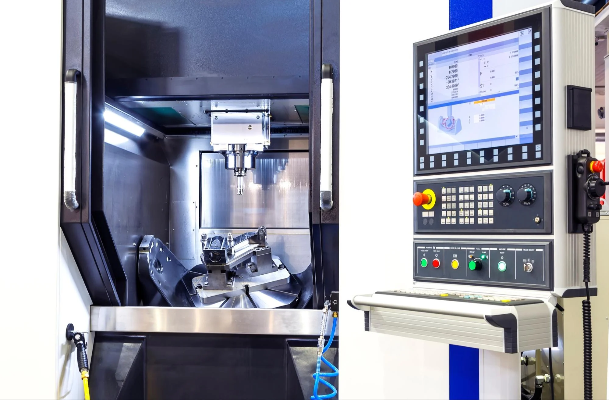

a 5 axis cnc machine with the door open and the code loaded on the display screen
G code programs get loaded into the CNC machine to control the machining operations

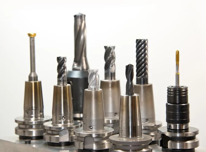

T specifies the tool number to change to, along with an M06 (tool change) command. When you set up the CNC machine, each tool is assigned a number.
a rack of cnc machine tools ready to be loaded into the machine
These tools are ready to be loaded into a CNC machine and labeled for machining operations
