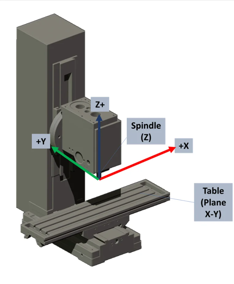

illustration of a CNC machine coordinate system, showing the table, spindle and x, y, and z axes
Figure 1: CNC Coordinate System
CNC machines typically have a control point defined as the center-face of the machine spindle as shown in Figure 1. When the Z-axis is fully retracted and the table is moved to its limits near a corner (typically the back-left), then this position defines the above-mentioned coordinate system point called “Home”.

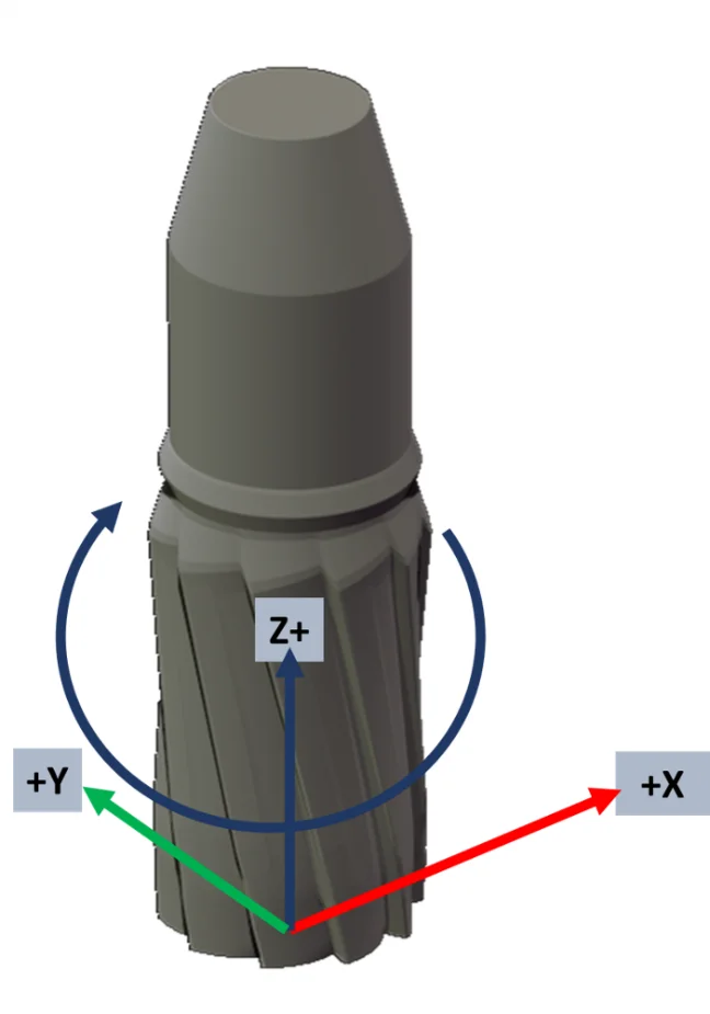

Unless otherwise specified, tools rotate clockwise when viewed from the machine spindle (see figure 2).
Illustration of CNC machine spindle and milling tool with rotational direction and x, y, and z axes
Figure 2: Typical Tool Rotation direction

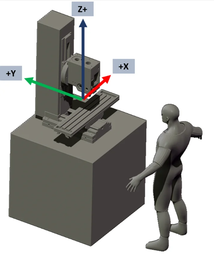

For milling centers, the 3D coordinate systems work as illustrated in Figure 3. The table, which holds the material to be machined, moves in the X-Y plane. The Z-axis is vertical and aligned with the tool. When standing in front of the machine, moving the table left-to-right is the X-axis, while moving forward and backward is the Y-axis. You can orient yourself using the right-hand rule: your index and middle fingers represent the X (index finger) and Y (middle finger) axes. Then, your thumb points in the direction of the Z-axis, the direction of the tool.)
Illustration of a CNC vertical milling machine and x,y, and z axes with a human figure standing in front of the machine
Figure 3: Vertical Milling Center Coordinate System
