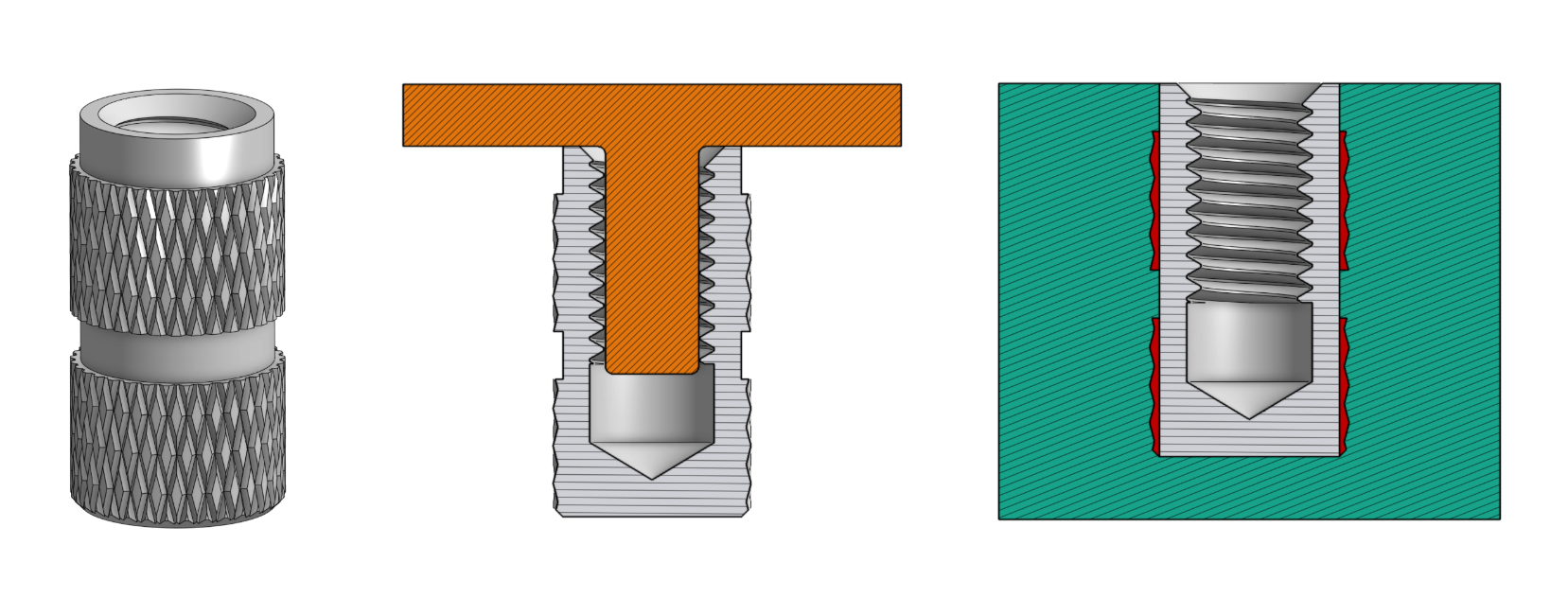

A diagram showing the insert molding process with a blind, threaded, metal insert.
What Is Insert Molding?
The insert molding process involves placing subcomponents into the mold cavity before molten plastic is injected around them. When plastic enters the mold and flows around the inserts, a strong bond forms between them, resulting in a one-piece part with a secure bond.
Insert injection molding integrates dissimilar materials into a single part. Inserts, such as metal threads or plastic pins, are embedded directly into the mold, where encapsulating plastic forms a robust, integrated component in a single cycle. This eliminates secondary assembly, enhancing efficiency and part durability.

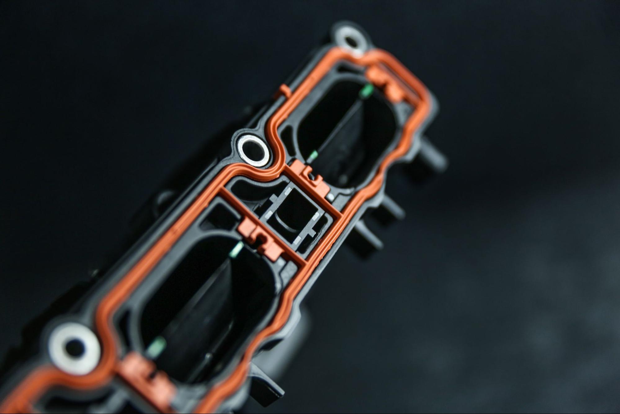

An intake manifold with insert molded parts.

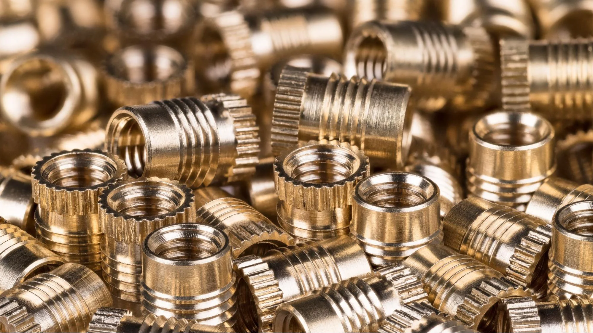

Metal Inserts
Metal inserts are widely used in metal insert injection molding for mechanical reinforcement or electrical conductivity. Common metals include brass inserts (enable precise threading for secure fastening), stainless steel inserts (provide excellent corrosion resistance and high strength), and aluminum inserts (offer a high strength-to-weight ratio and efficient heat transfer).

Threaded inserts for injection molding.

  • Insert Shifting: Unsecured injection molding inserts may shift under high-pressure plastic injection, causing misalignment or poor bonding. Mechanical retention features or automated placement with vision systems ensure precise positioning.

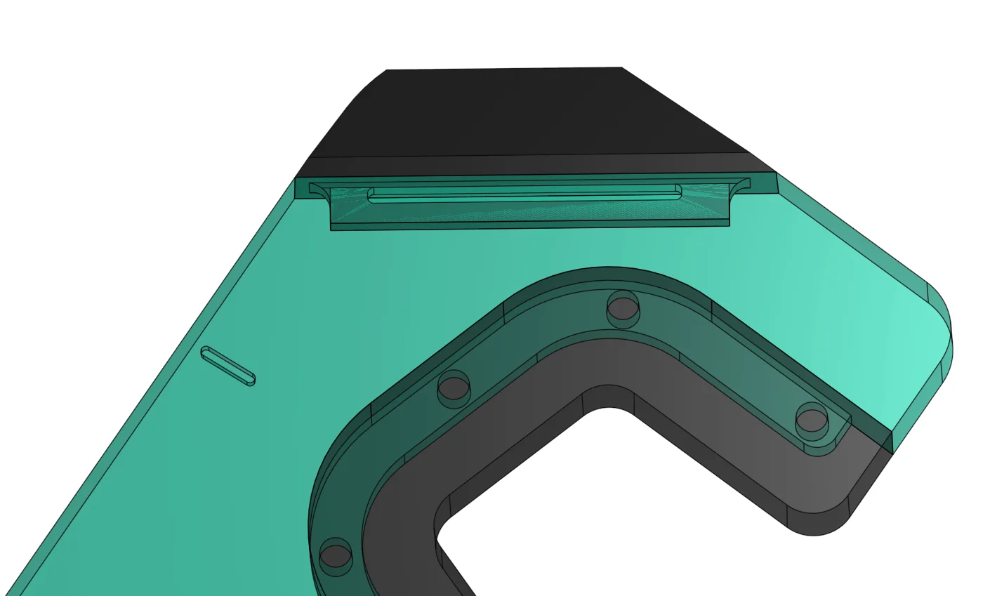

Design Guidelines for Insert Injection Molding
Insert molding yields optimal results with intentional design, anticipating how the injection molding insert and encapsulating plastic interact during fabrication. Some key best practices for designing successful insert-molded parts include:
  • Retention Features: Incorporate undercuts, knurls, grooves, holes, or ribs on inserts to mechanically lock them into the encapsulating plastic after molding, preventing shifts under injection pressure or during use.
  • Wall Thickness: Ensure uniform wall thickness of the encapsulating plastic around inserts to avoid warping, sink marks, internal voids, or weak spots.
  • Plastic Flow Paths: Position gates and runners to allow molten plastic to flow smoothly around the insert, preventing turbulent flow or trapped air that causes incomplete filling, poor bonding, or cosmetic defects. Ensure enough space for material flow around the inserts.
  • Ejection Considerations: Design molds with ejector pins placed away from the insert to prevent dislodging it from the encapsulating plastic during demolding, avoiding part damage.
  • Tolerance Planning: Account for thermal expansion and shrinkage of both the encapsulating plastic and insert, ensuring a snug fit for adhesion while allowing slight clearance to prevent plastic cracking or misalignment, using simulation software like Moldflow or SolidWorks Plastics.
  • Tooling Precision: Employ high-precision tooling, such as CNC-machined molds with tolerances below 0.01 mm, to align inserts accurately in the mold cavity, minimizing performance issues, cosmetic flaws, or tool wear.
  • Tooling Placement: Consider features that may be used to hold the insert in place during the molding process, such as standoffs or pins for threaded inserts, and position them in the design accordingly.
CAD showing design for insert molding and overmolding.

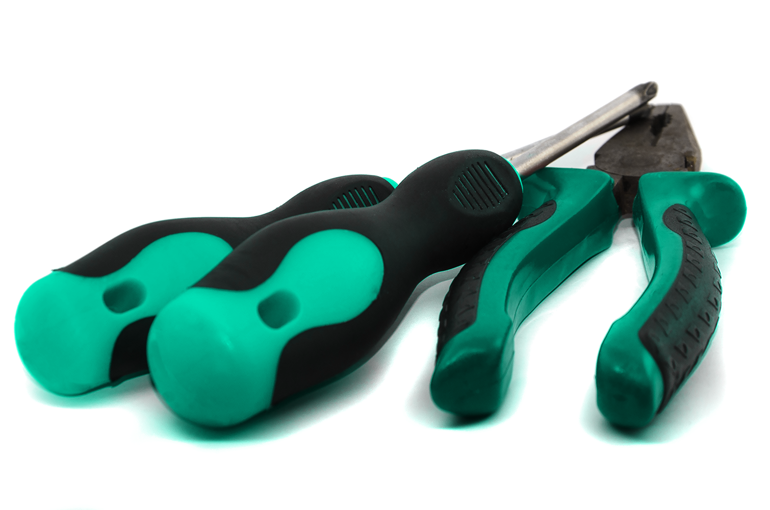

Insert-molded tools with a rubber-like grip overmolded.
