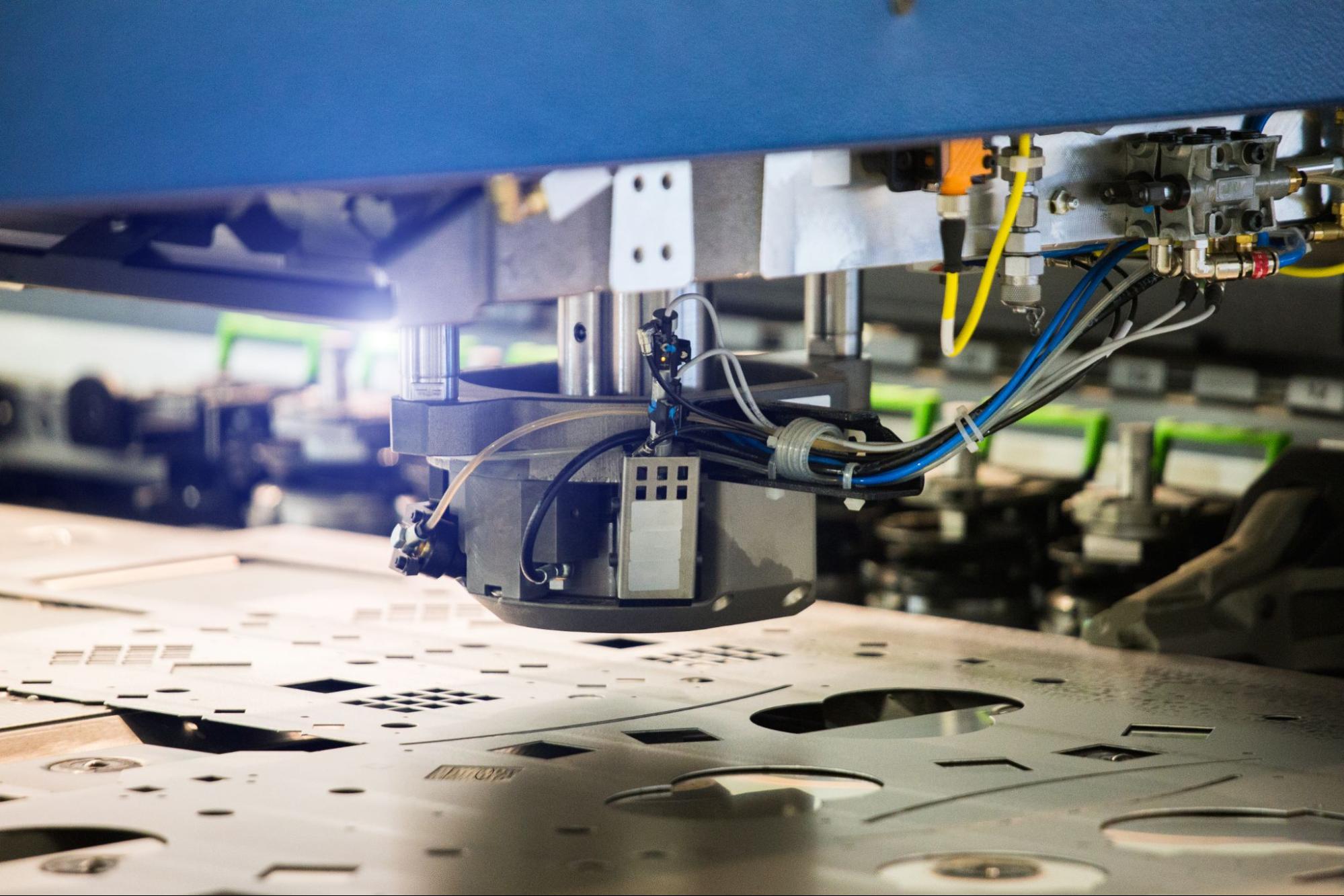

  • Blanking: Cutting the complete outer shape of the part from the sheet stock.
  • Piercing/Punching: Cutting internal holes or features, with the slug being scrap.

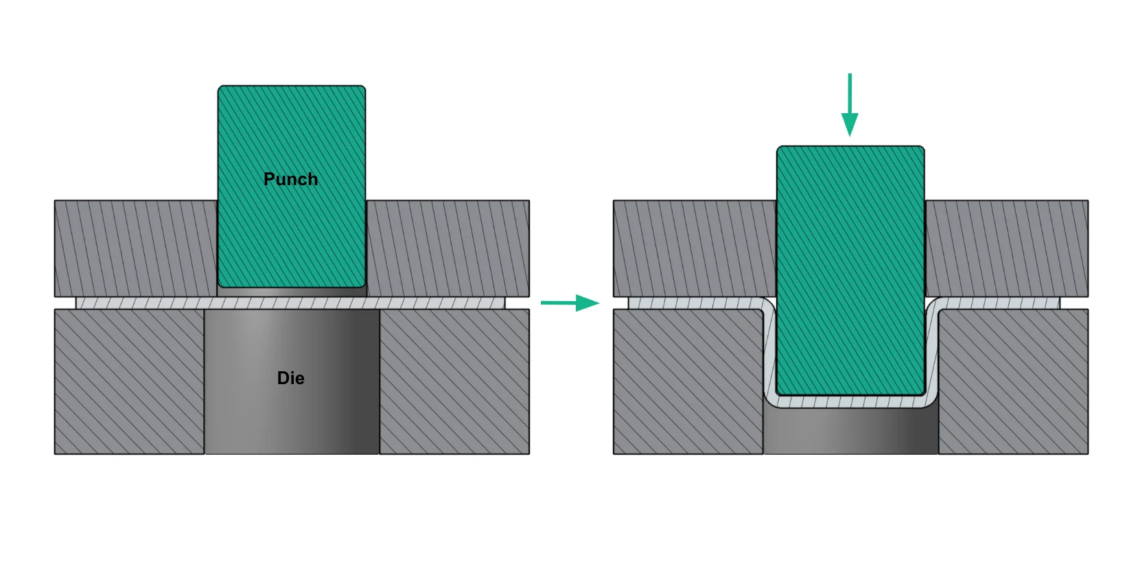

Stamping process with punch and die

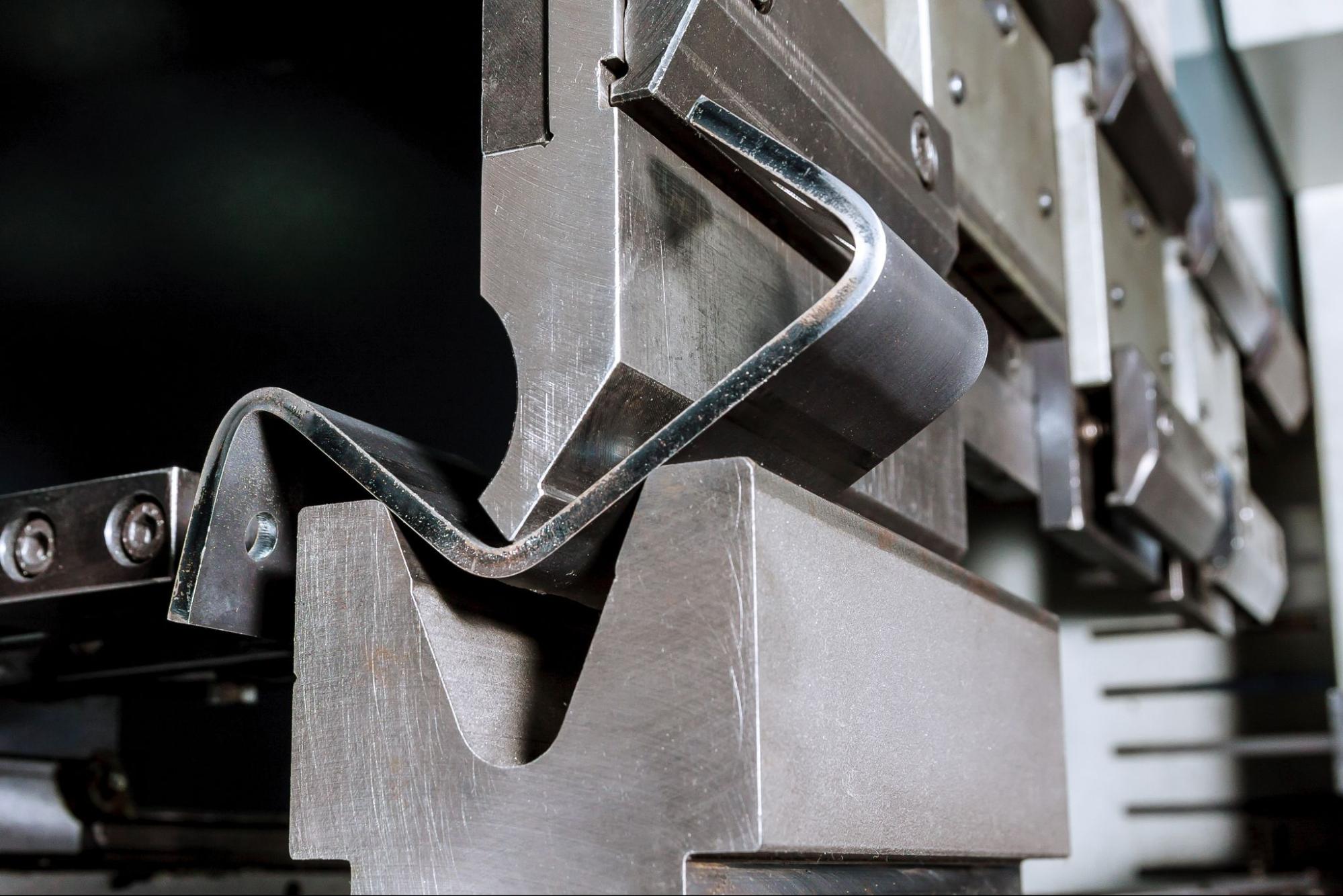

Bending & Forming
Bending deforms the material along a straight line. Engineers must account for springback, or the material’s tendency to partially return to its original shape, by designing the die to over-bend the part.
Sheet metal bending and forming are operations within the broader metal stamping process.

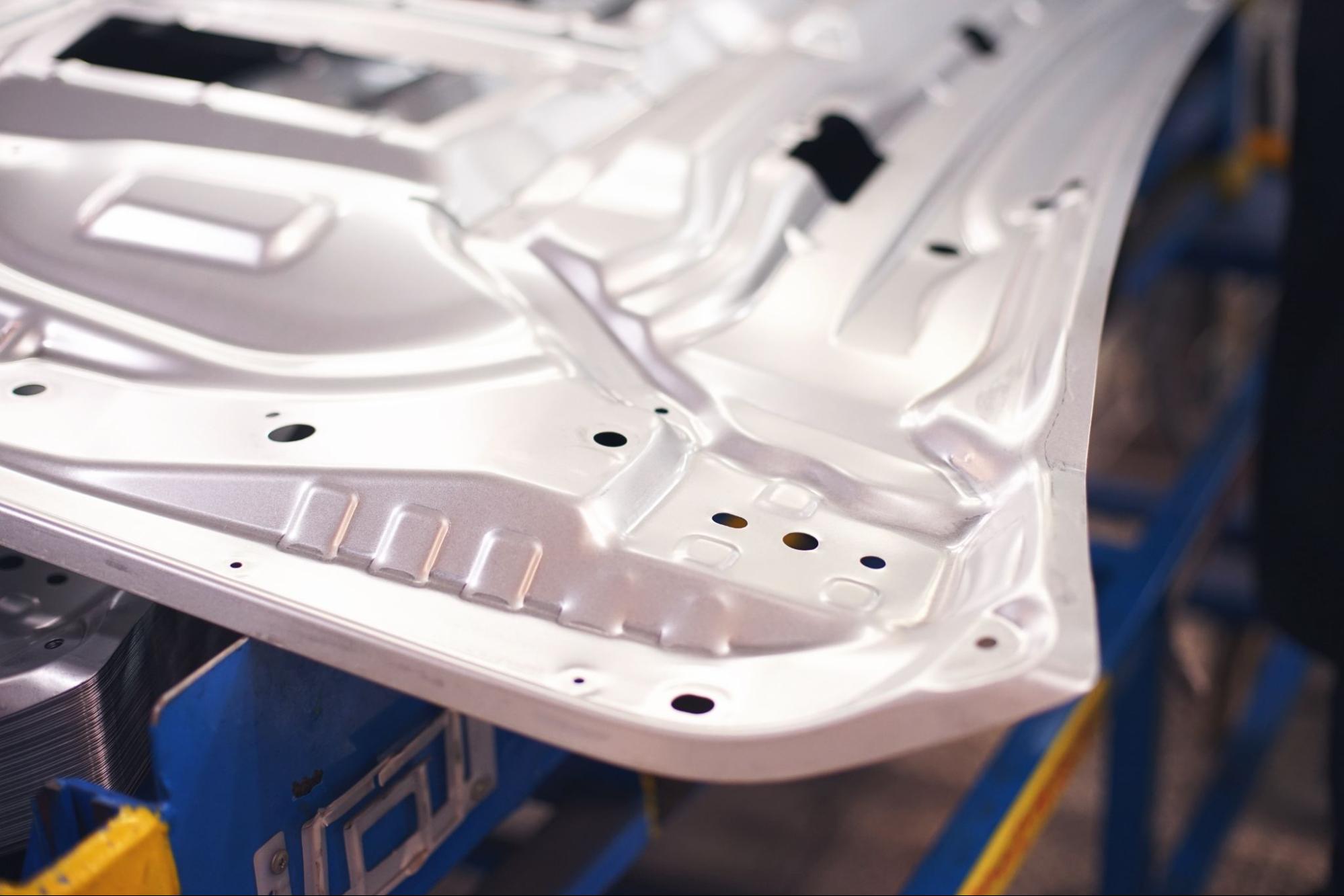

A stamped metal automotive part.

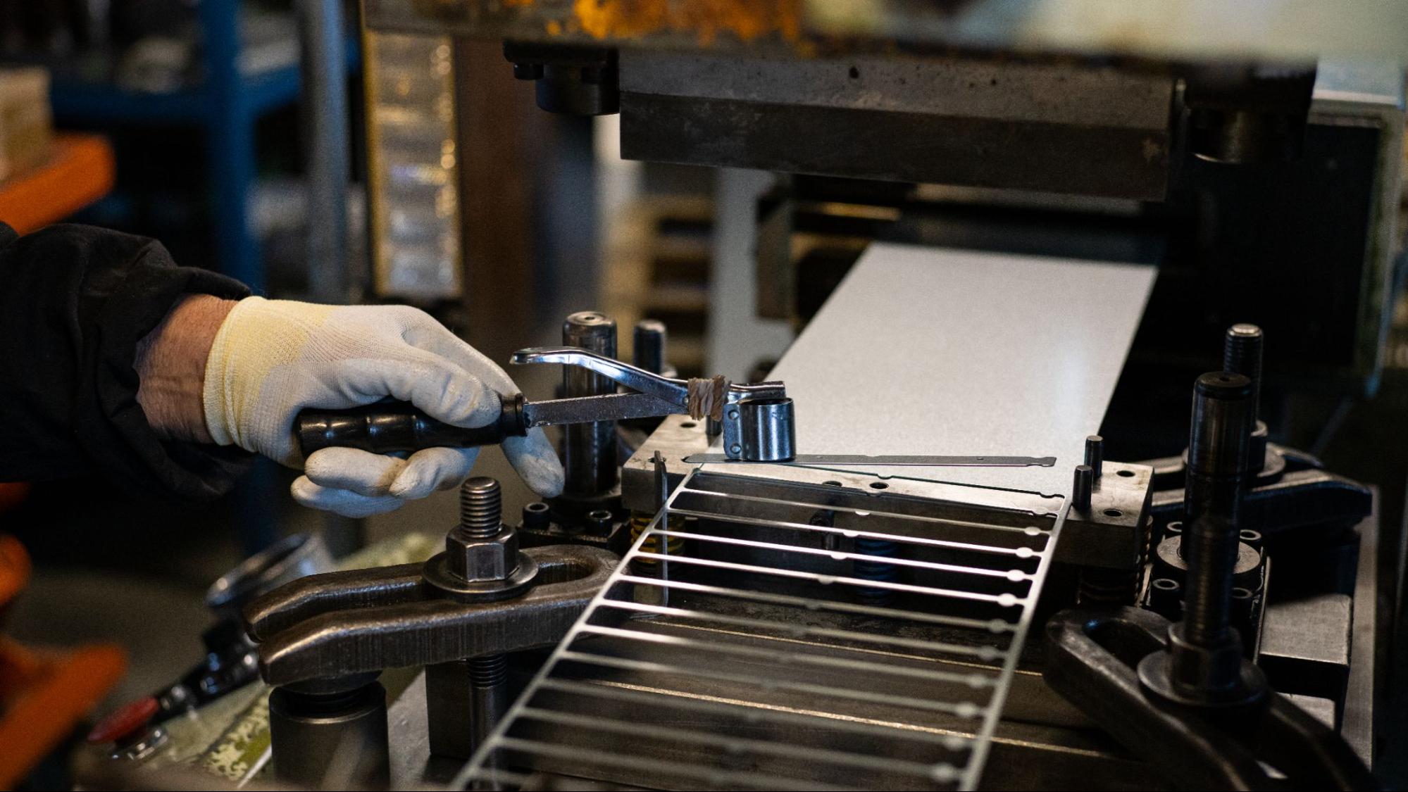

What Tools Are Used for Metal Stamping?
The tooling, or die set, is the single largest capital investment in stamping and dictates the part’s final quality and cost. A stamping die consists of several crucial elements:
  • Punch: The upper cutting or forming tool, attached to the ram.
  • Die Block: The lower half, containing the cavity or cutting edge.
  • Stripper Plate: Mechanically removes the part or the scrap web from the punch during the ram’s retraction.
  • Pilots: Pins that enter pre-punched holes to ensure that strip material is perfectly indexed for subsequent operations.
Additionally, engineers must consider the die material, which is often composed of tool steel. Tool steel selection is based on wear resistance, required part volume, and material hardness:
  • D2 Tool Steel: The industry standard for high-volume dies due to its exceptional wear resistance and longevity.
  • A2 Tool Steel: Used for medium-volume runs and offers a good balance of toughness and wear resistance.
In addition to single-strike dies, options include:

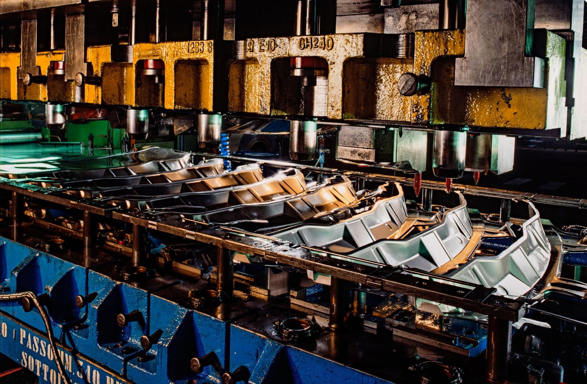

  • Progressive: The sheet metal strip passes through multiple stations, each performing a specific task.
  • Compound: A single station performs multiple operations simultaneously.
  • Transfer: An automated system or robotic arm transfers the part to various stations within the press.
