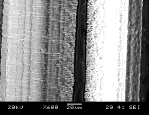

SEM image I captured of a ductile material
You will easily find aluminum or stainless steel sheets, but it’s very difficult to find lead or zinc sheets. This is because certain metals and their alloys possess certain factors that make them easier to form into thin sheets, such as their crystalline structure, ductility, and malleability.
Metals with a face-centered cubic (FCC) crystal structure have a higher ductility and malleability and are, therefore, more easily formed into thin sheets. Examples of metals with an FCC crystal structure include aluminum, copper, and gold; these are highly ductile, malleable, and easy to form into sheets. Alternatively, metals with a body-centered cubic (BCC) structure are brittle and not malleable, making it difficult or impossible to form them into sheets.

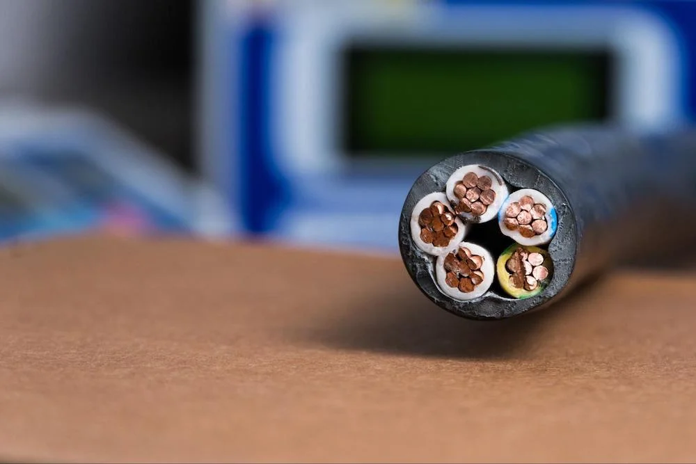

 cross-section of a wire bundle, showing ductile copper wire usage

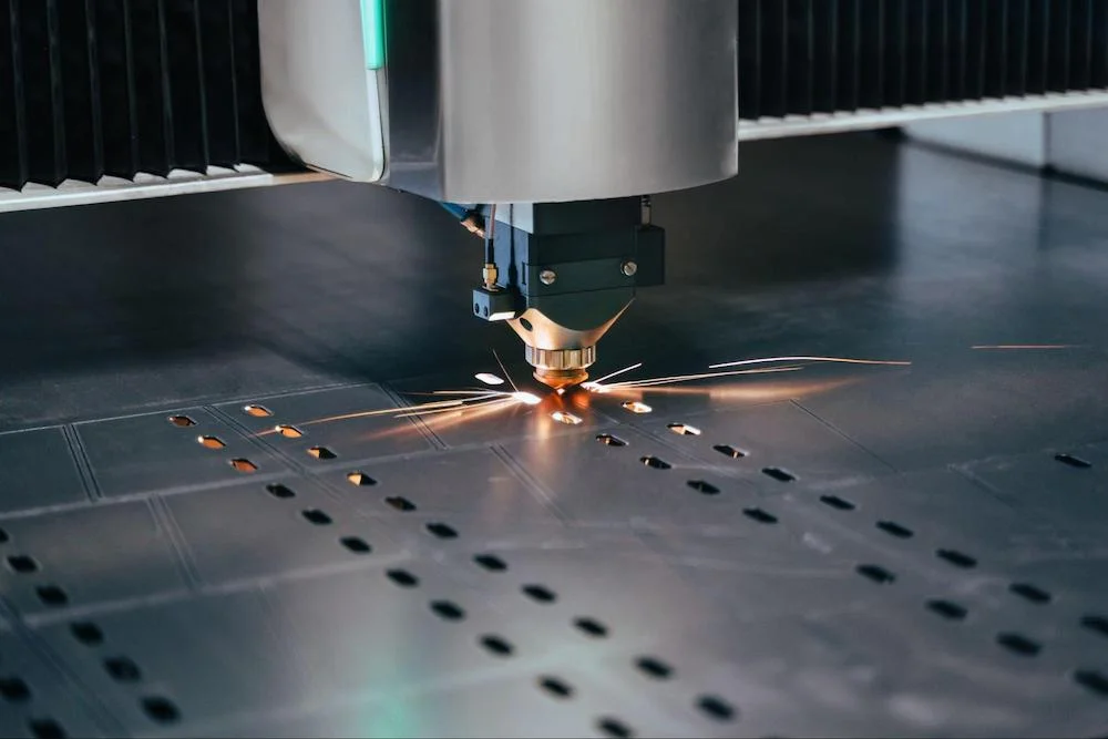

Laser cutting is one of the most popular processes for cutting sheet metal parts. It is a precise and efficient process that can rapidly produce complex parts with high accuracy. The limitation of laser cutting is that the sheet thickness needs to be less than 6 mm thick for the process to work.
 Laser cutting sheet metal in action
What is Laser Cutting?
Laser cutting involves cutting sheet metal parts utilizing power from a laser. The word LASER is an acronym for Light Amplification by Stimulated Emission of Radiation. This simply means that a laser is a narrow, high-powered beam of light with similar wavelengths (versus white light from light bulbs that is a mixture of various wavelengths).
What is happening with the laser cutting of sheet metal? Well, remember that light is energy via excited photons. The laser beam is a stream of photons that are full of energy. The laser beam of photons is focused on the metal surface (sheet metal), and the energy is absorbed by the metal. When the photons hit the surface of the metal, their energy is transferred as heat, and it is enough energy and heat to raise the temperature of the sheet metal to its melting point where vaporization may occur. When the laser starts, a tiny hole is produced rapidly, and then the movement of the laser extends this hole, creating a narrow cutting path. Laser cutters also have a continuous flow of gas that works to blow through the cut metal. This gas smell is what I remember the most about being around laser cutting.

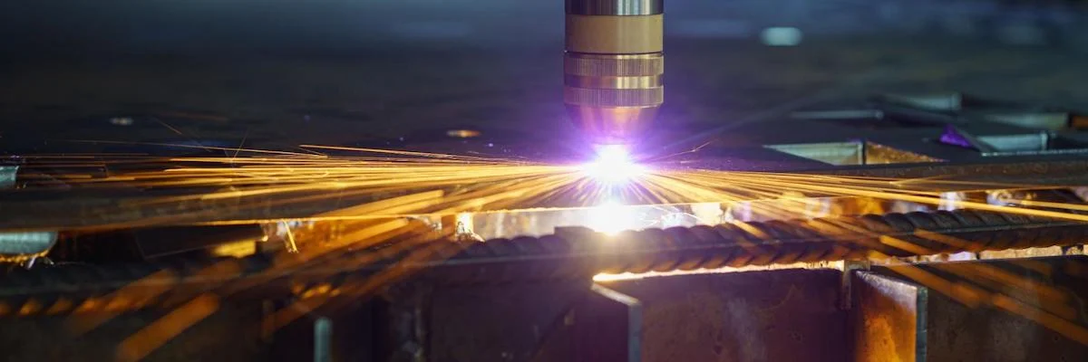

Plasma cutting involves a flow of electricity coupled with gas to burn through material. “Plasma” is a term used to describe superheated material and is a mixture of positively and negatively charged gas particles. The sun, lightning, and stars in the solar system are all comprised of plasma. So, think about something with the same energy and power as the sun being directed at a metal surface. A stream of highly concentrated electrical current is coupled with a fast flow of gas (oxygen or nitrogen) that settles on the sheet metal surface, creating high heat. This generated heat melts a slot (not a hole as in laser cutting) in the sheet metal, which is propelled through the cutting path.
plasma cutting sheet metal in action
Because of the higher amount of energy generated during plasma cutting, it can be used to cut thicker sheet metal, upwards of 8 mm thick, versus the thinner metal targeted with laser cutting. Plasma cutting is slower than laser cutting, and the width of the cut path is wider.

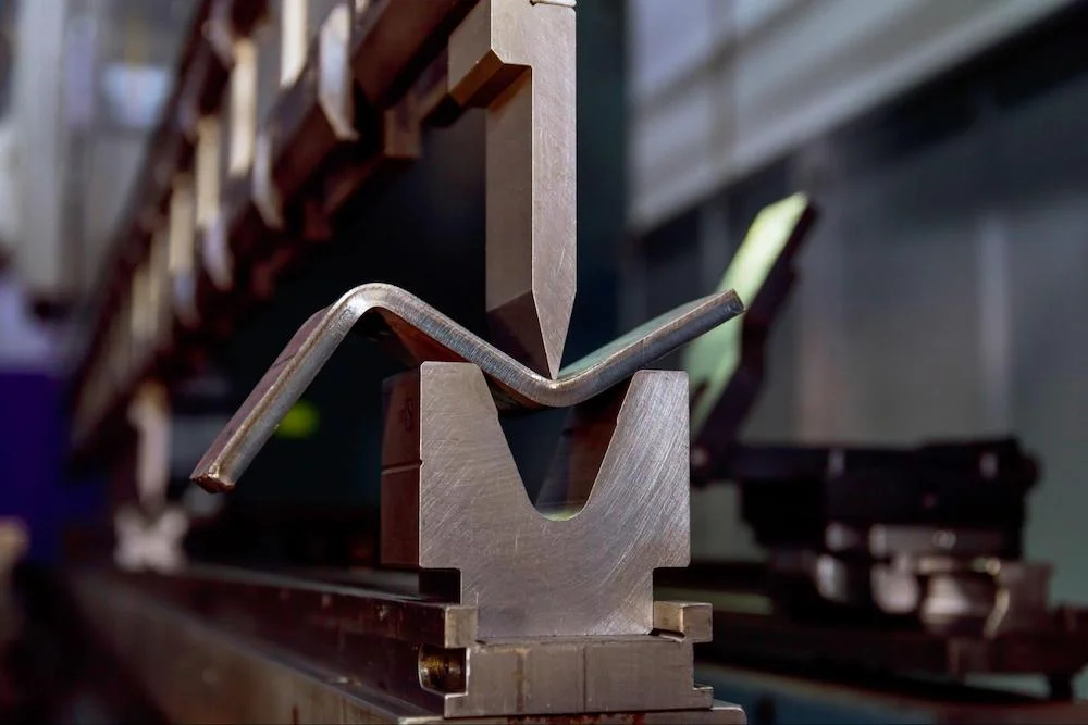

Bending sheet metal is popular because it allows a single part to fit within an assembly in many directions without complex machining or assembly of multiple parts with fasteners or permanent metal joining. Sheet metal is a popular choice of material to bend because its low thickness usually enables bending without cracking.
press brake operating to perform Sheet metal bending
Sheet metal bending involves inserting a sheet of metal (often previously stamped, laser, or plasma cut) into a press that has been fit with a set of dies (press break). The sheet metal is placed in the correct orientation on top of the bottom die, typically to a stopping point that is raised, and then the press is operated, putting pressure down on the sheet to cause permanent, plastic deformation of the sheet and fix the bend you desired to place in the sheet.  Sometimes, a sheet is bent multiple times and in several different orientations. Some bends take several steps so the metal isn’t too highly stressed. Metal bending can produce complex shapes and contours, including curves, angles, and bends.
Tips for Sheet Metal Bending
  1. Design your bent sheet metal parts with enough material to create the bend (the sheet to bend is often called the blank). Imagine a sheet of metal rolled up in a cylindrical shape; you would need enough material to fit the outside circumference of the cylindrical shape. This same concept also applies to bent metal segments that are less than a full circular shape.

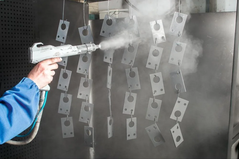

Powder Coating
Powder coating is a dry finishing process that combines polymer resin, leveling agents, curatives, pigments, flow modifiers, and various other additives. What makes a powder coating unique and interesting is that all these ingredients are melted, cooled, and then refined by grinding them into a fine, homogenous powder. This process is reminiscent of the manufacturing flame spray coating powder, made from atomizing metals into small ‘powder’ particles and sorting them by particle size.
powder coating sheet metal parts
Like any other finishing process, the success of a powder-coated finish is directly dependent on the part preparation. Powder coating involves using a spray gun that electrostatically charges the powder particles. The propulsion of these powder particles is attracted to the electrically grounded part. After powder coating, the parts are cured in a heated oven. This facilitates a chemical reaction whereby strong molecular chains are formed, and the coating homogenizes to a dense and tough finish.
Less commonly, powder coating is accomplished by heated parts immersed in a fluidized bed where the powder melts on the parts. Then, the parts are either pulled out and left to allow the coating to dry or further cured, solidifying the coating.

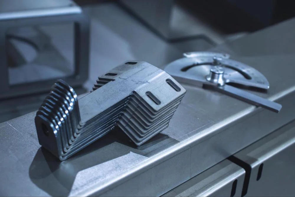

There are several other methods that are utilized to finish sheet metal parts, and the finishing process selection depends on the environmental conditions, assembly, function, and desired aesthetics. Some common finishing methods include deburring, welding, painting, plating, powder coating, surface modifications, and polishing. Deburring involves removing any sharp edges or burrs left on the sheet metal after cutting or bending. Welding is used to join two or more pieces of sheet metal together, while painting and plating provide a protective layer to prevent corrosion, improve conductivity, or increase wear resistance. Polishing can be used to give a smooth and shiny finish to the sheet metal. Conversion coatings like passivation or anodizing offer corrosion resistance and may impact part aesthetics. Each method has its advantages and disadvantages, and manufacturers must choose the appropriate finishing method based on the specific application and requirements of the finished product.
sheet metal parts
