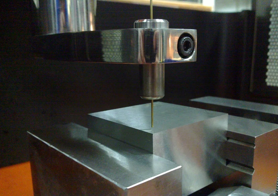

  • Hole Drilling Electric Discharge Machining: The third type of EDM is used for drilling. Hole drilling EDM is able to machine very small, deep holes, which is difficult or even impossible with conventional drilling methods. Additionally, hole drilling EDM is super clean, and doesn’t require any deburring. In this process, the electrodes are tubular and the dielectric fluid is fed through them. Similar to the other EDM types, the electrode cuts/erodes the workpiece, but due to the discharged gap, the electrode doesn’t actually contact the workpiece. This minimizes deflection of the tube electrode as compared to drill bit deflection in conventional drilling processes.
Small hole-drilling EDM machine
Figure 1: hole drilling EDM
