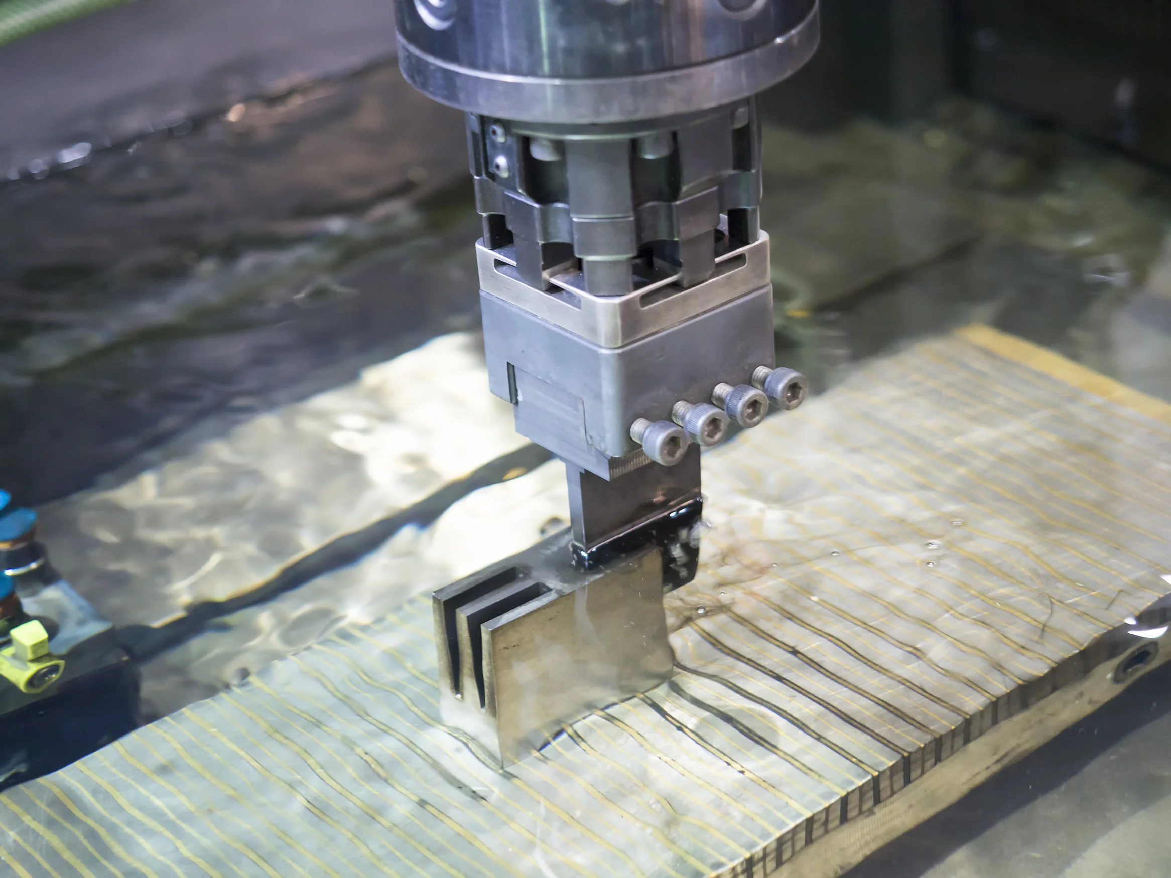

EDM is accomplished through two methods:
  1. Sinker EDM: a pre-shaped or pre-formed electrode (which is typically CNC machined) with the geometry of the desired cavity is pressed into the workpiece to create said cavity. This type of EDM is also referred to as die-sinking EDM, or cavity-type EDM, and is optimal for producing geometries like internal gears.
  1. Wire EDM: a thin, metal wire is used to cut through material and form the desired part shape.
For more information on the different types of material removal methods with EDM, check out this related Fictiv article.
Fictiv offers both types of Electrical Discharge Machining (EDM) processes, which are useful for cutting deep pockets and complex features like gears or holes with keyways.
