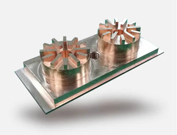

Copper alloys are commonly used for electrodes because of their greater durability and conductivity as compared to graphite. They also have greater machinability as compared to tungsten carbide and offer comparatively low tool wear given their material removal rate.
![Image of a CNC machined copper alloy EDM electrode](https://www.fictiv.com/wp-content/uploads/2021/10/image1.jpg)
Different copper alloys may be considered for EDM electrode material, including copper tungsten and brass. Generally, such electrodes produce a mirror-like surface finish and work well for small cavities. Copper tungsten sintered electrodes are heat resistant with high electrothermal conductivity and provide a relatively low wear rate versus speed of material removal. Brass, a mixture of copper and zinc, is a good electrode material for less precise work because it’s a softer material.
