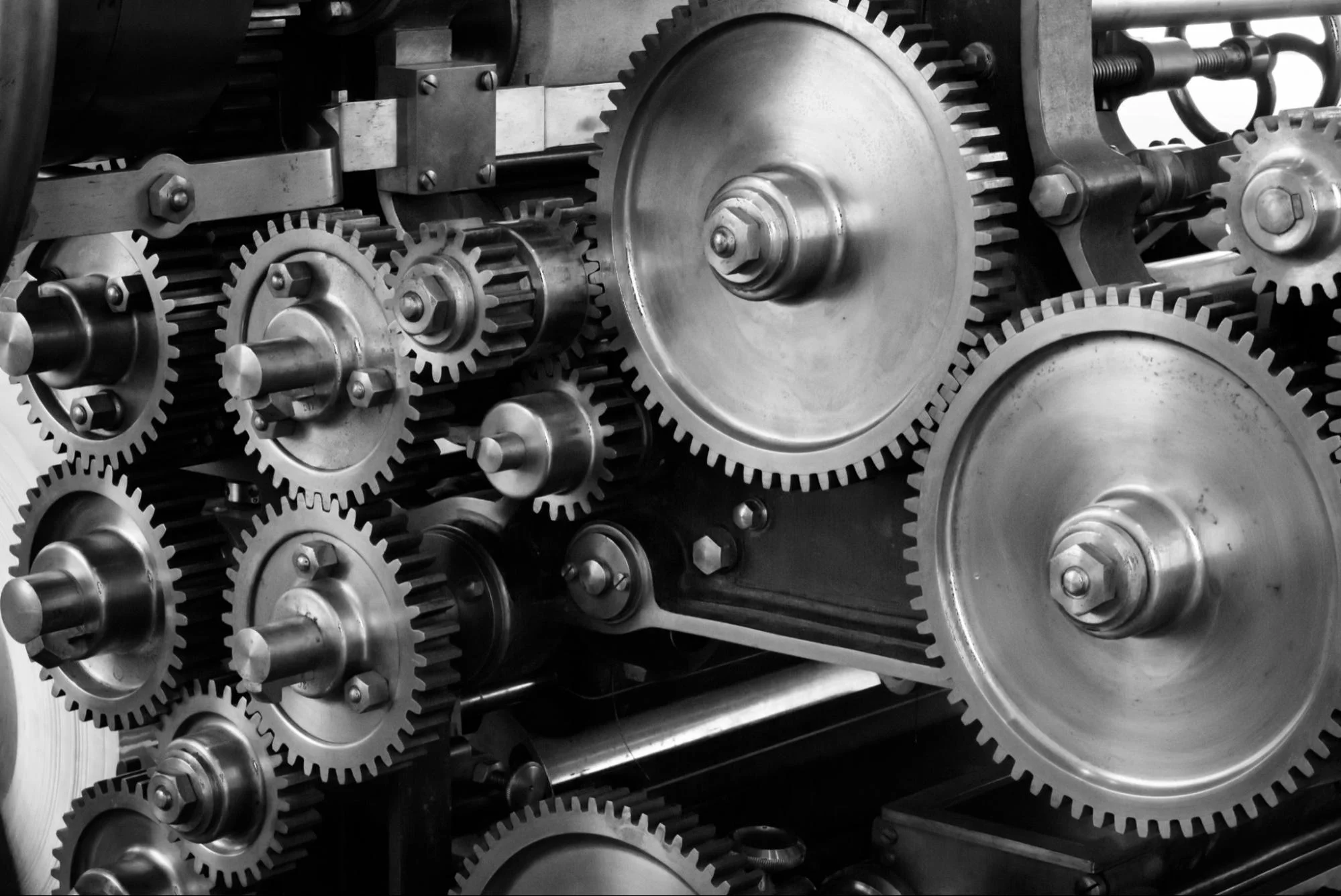

an assembly of gears all connected
Figure 1 An assembly of gears

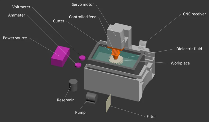

Breakdown of EDM System components:
Figure 2 shows a diagram with the typical components of an EDM system.
a diagram of an electron discharge machine EDM
Figure 2 EDM System Components

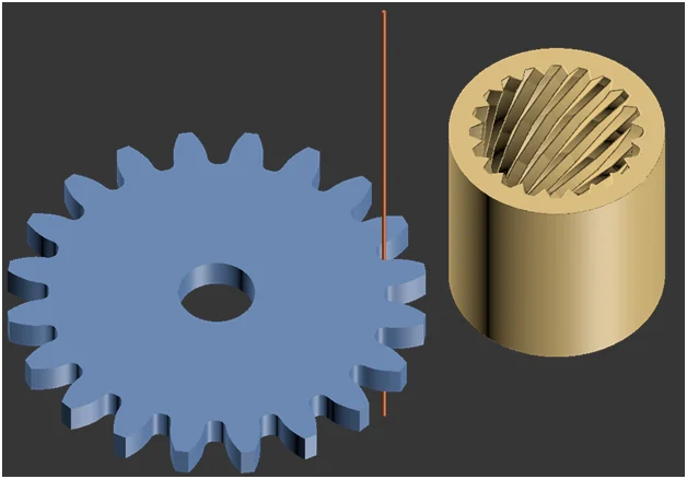

As discussed above, Wire EDM only cuts perpendicular to the gear blank. This becomes a limitation for fabricating Helix gears or more complex intricate shapes as shown in Figure 3. However, unlike Wire EDM, Sinker EDM synchronizes two axes. These two axes work at the same time, producing a radial or twist motion, allowing fabrication of helix, radial gears and even interior full and partial cuts. In other words, the electrode or cutter can rotate. The caveat is that the electrode can cut into undesired geometry areas, wiping out helical shapes, if the program and the motion pattern are not well designed.
a regular gear next to an internal helical gear
Figure 3 Wire EDM limitations for gears with complex shapes
If your gear geometry is a customized and complex design, one good practice is to use different electrode sizes. This can be similar to carving or sculpting, where you are fine-tuning details at the end with smaller, more precise tools. This, of course, increases the work time, you now have the capability of controlling the geometry in an efficient way.

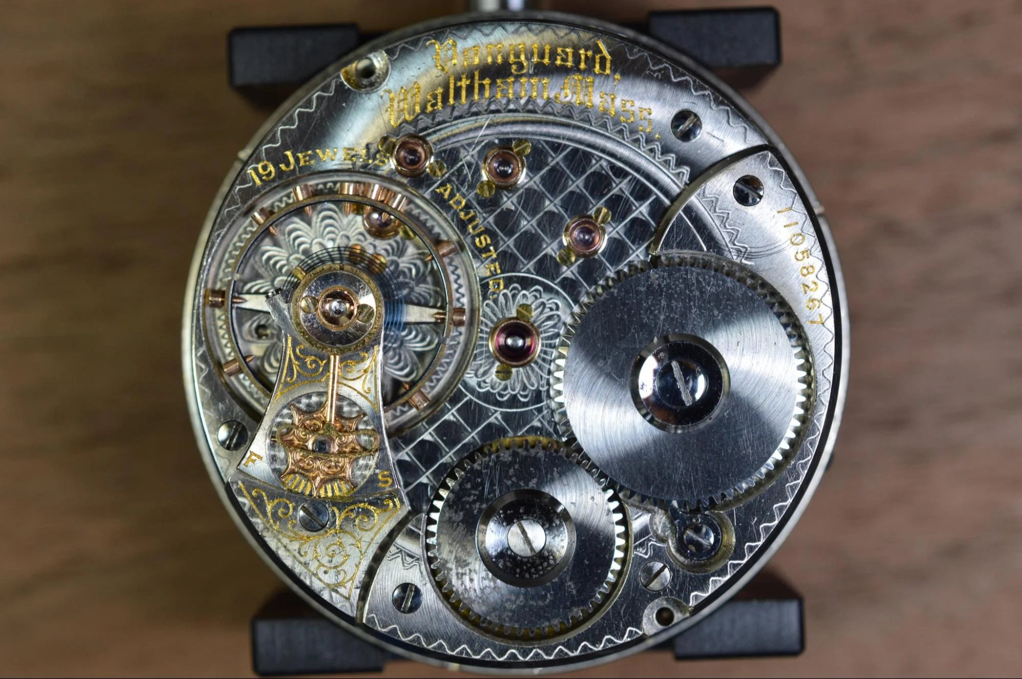

With all of the advantages of EDM for gear fabrication, there are some cool applications out there. From micro machining gears for watches and clocks to more robust gears like used on race cars, wire EDM and sinker EDM can be valuable despite its slow speed in comparison with other machining methods.
the inside of a watch with the gears and engraving
Figure 4 the tiny and precise gears inside a pocket watch
