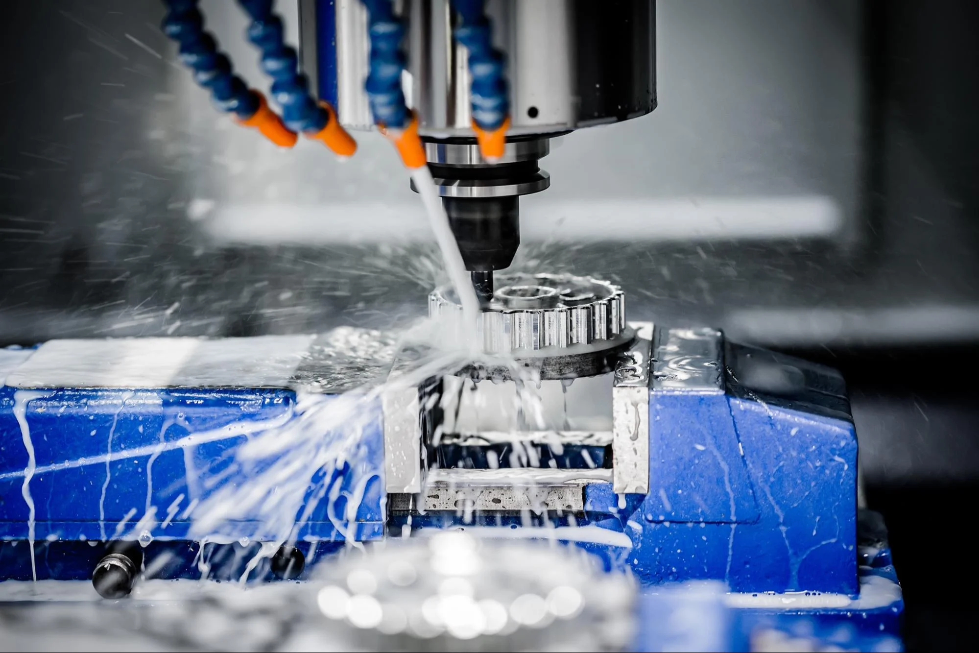

We’ll start with the classic machinist’s vise. A vise can be clamped down to the table of your CNC machine. A vise won’t work for every part, though. There is a sweet spot in sizing because of limitations on how large your part can be – a vise can only open so much. Thickness matters as well – a very thin part may be warped when you tighten the vise. You can also only use a vise for parts with parallel edges. When using a vise, make sure that your part is level, and that it is tightened down fully. If set up correctly, a vise can be extremely repeatable and accurate!

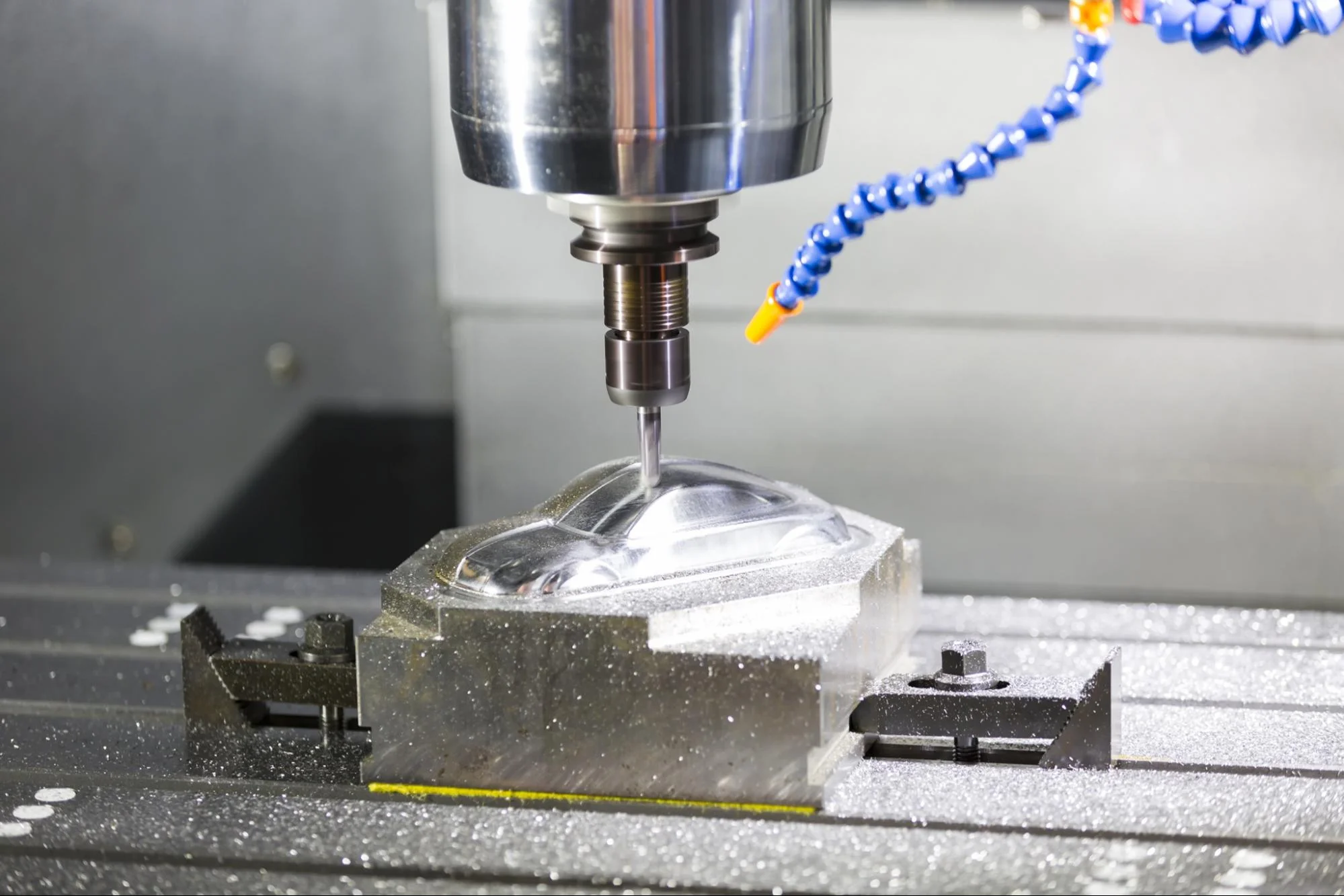

Step clamps, also known as toe clamps, are a very common workholding method for manual milling. This clamping system utilizes the T-slots on a machine’s bed. They are an extremely firm way of holding down your workpiece and are another effective CNC workholding solution. However, there are some downsides that make other workholding devices a better choice. Step clamps can be time consuming to set up, although they are adaptable to a variety of parts (as long as you have a flat surface to clamp on. They are not as repeatable as other workholding fixtures. As soon as you loosen the clamp, it no longer stays in the same location. You then have to reconfigure the setup again for the next part. Step clamps are good for holding big plates to be machined and for clamping down fixture plates.

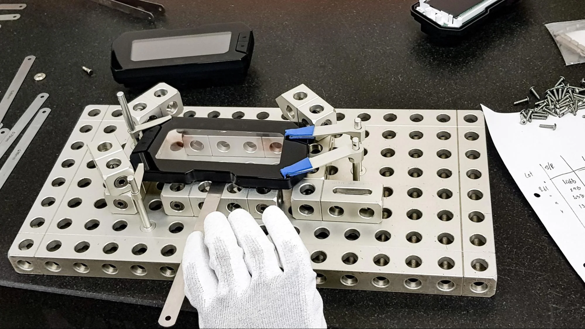

Fixture plates can be used to mount a wide range of parts to be CNC machined. You may also hear them referred to as tooling plates. They are made of aluminum or steel and have a grid of holes. Some of these holes are intended for dowel pins and some are threaded for bolts. Fixture plates are a very useful workholding method due to their repeatability; each hole has a known location and won’t move once the plate is installed. The dowel pin holes are useful for locating your fixture or part on the plate. The threaded holes are good for bolting down your fixture or part.
![A part on a fixture plate](https://www.fictiv.com/wp-content/uploads/2021/05/image5.jpg)
There are a couple different ways to use a fixture plate. One method is to design in bolting holes to your part. This workholding method allows you to have access to multiple sides of the part and machine interesting geometries or surfaces. However, it will require post-processing to remove the fixture holes.
Another method is to design a custom fixture that holds your part. Then, you then bolt that fixture to the fixture plate. This takes advantage of the locating features of the fixture plate. Fixture plates also protect the table of your CNC machine from a wayward tool. There are many options for nuts, bolts and other tools to use with a fixture plate, so get out there and explore!

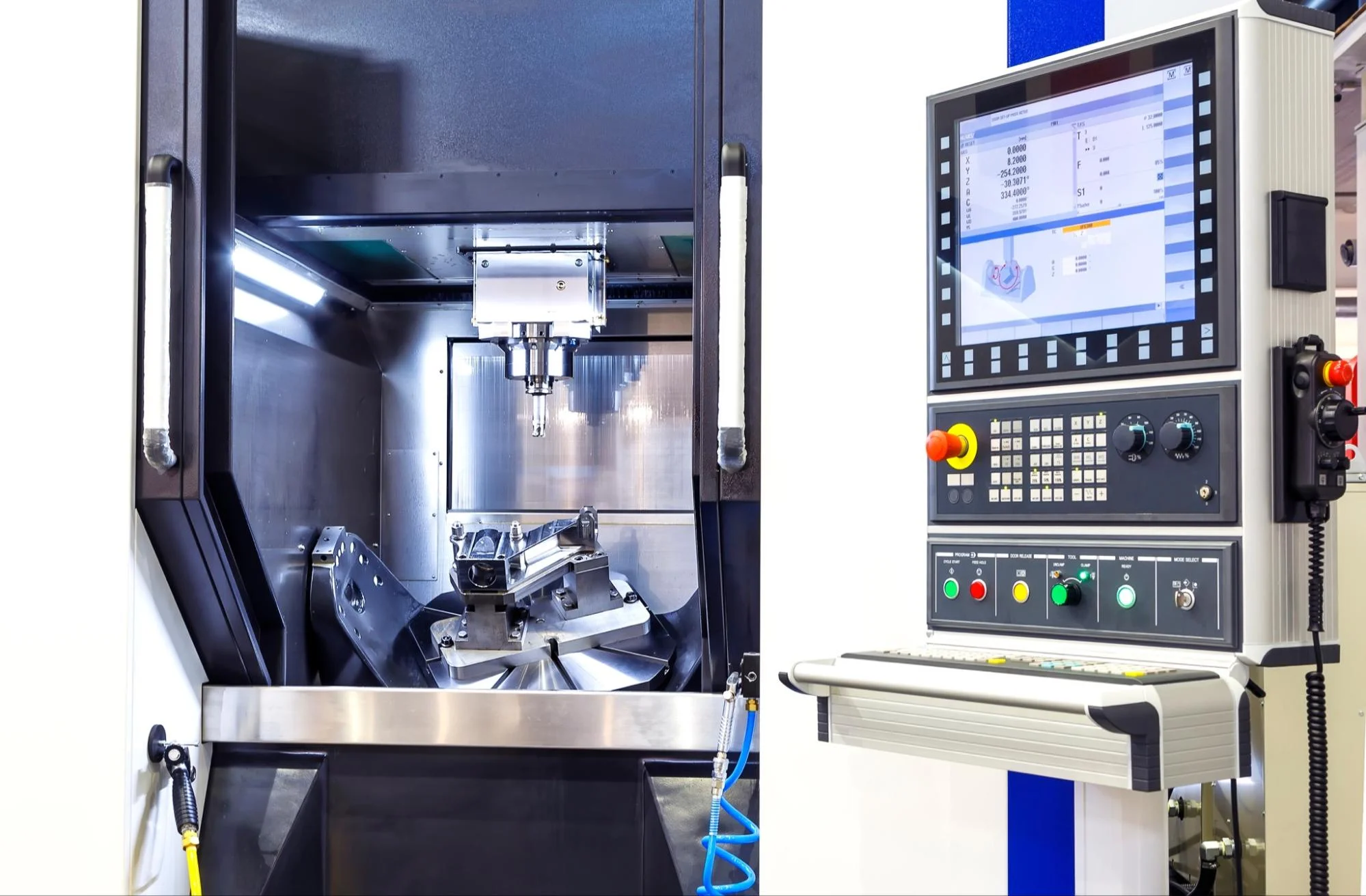

The CNC workholding methods that I have reviewed so far are great for a standard 3-axis CNC milling machine. These machines have many capabilities, and with creative fixturing you can machine a lot of different geometries. However, there are some limits to what a 3-axis machine can do. You may find yourself machining something more complex on a 4- or 5-axis machine. 5th axis workholding is a whole different story. With the additional range of motion, the machine has much greater access to the workpiece. More axes means more fun but also more potential for crashing! Pay extra attention to allowing access to multiple surfaces. You also need to leave clearance around the workpiece and machine table for the cutting tools to move.
