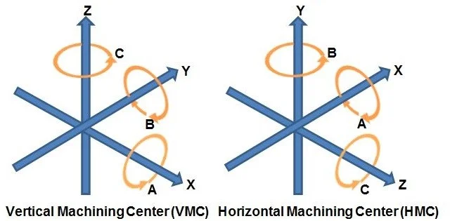

CNC machines come in a wide range of configurations. In general, there are two main styles of CNC mill, namely VMC (Vertical Machining Center) and HMC (Horizontal Machining Center). A VMC typically has the spindle vertically along its Z-axis whereas an HMC has the spindle horizontally along its Z-axis as shown in Figure 2 below:
![Different Types of CNC Milling Machines](https://www.fictiv.com/wp-content/uploads/2023/01/Machine-Axes.jpeg)
CNC mills can further be categorized by the number of translation and rotational axes in which they can be moved — these are often referred to as degrees of freedom. There can be a maximum of 6 degrees of freedom, namely 3 transitional (X, Y, Z) and 3 rotational (A, B, C) degrees of freedom. A higher degree of freedom results in a machine that is more capable of producing complex components because it can position the milling tool in more locations and at multiple angles. The most common multi-axis CNC machines have 3, 4, or 5 axes. 5-Axis CNC milling machines are the most advanced machines, with the most popular configurations being the trunnion and gantry styles.

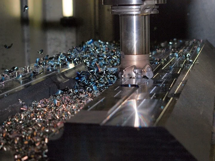

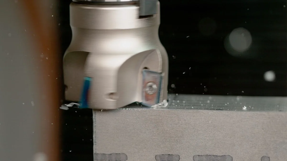

- Plain Milling: This is the most basic operation possible on a CNC mill, that’s used to produce flat faces parallel to the bed of the CNC mill.
- Face Milling: Face milling is similar to plain milling, however, a much larger diameter tool is used and the depth of cut is only a fraction of plain milling. Face milling produces a large, flat surface.
![Face Milling](https://www.fictiv.com/wp-content/uploads/2023/01/Face-Milling.jpeg)
Face Milling

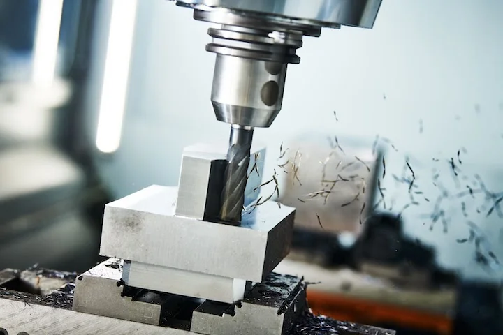

- Side Milling: This refers to the process of milling a flat, vertical surface on the side of the part.
![Side Milling](https://www.fictiv.com/wp-content/uploads/2023/01/Side-Milling.jpeg)
Side Milling

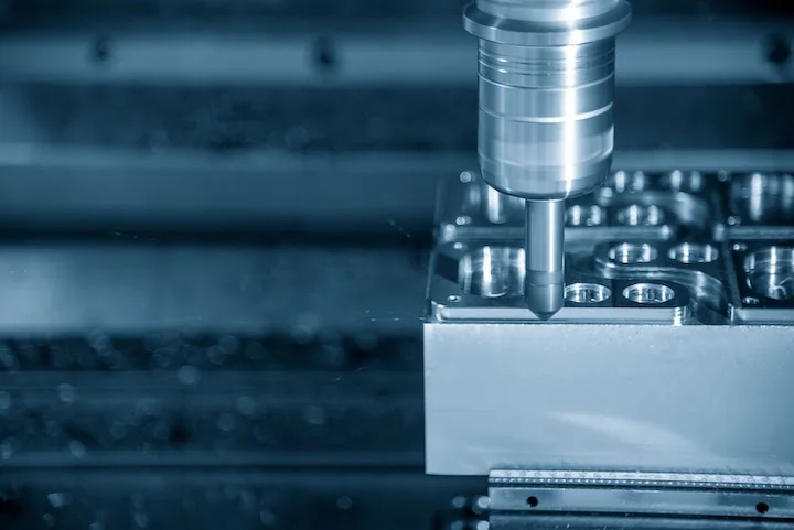

- Hole Drilling: Holes are typically machined using a drill. However, larger holes can be machined with an end mill that cuts the hole by spiraling down into the workpiece.
![Hole Drilling](https://www.fictiv.com/wp-content/uploads/2023/01/Hole-Drilling.jpeg)
Hole Drilling

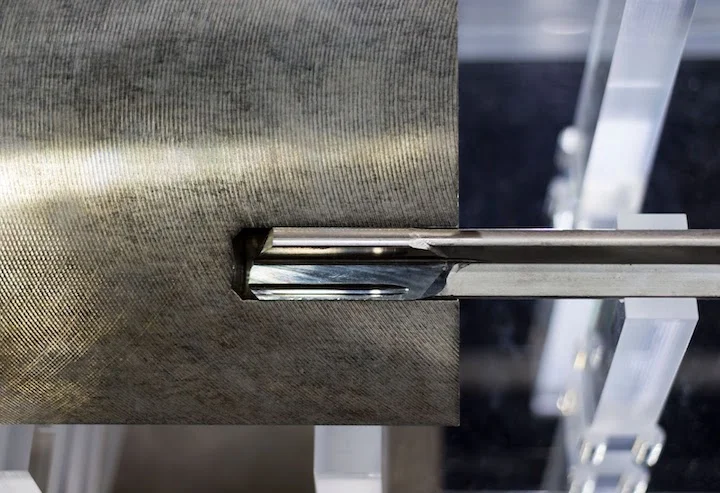

- Reaming: After drilling, the hole can be reamed to achieve a precise diameter. Reamed holes are often used to accurately position items with locating pins.
![Reaming](https://www.fictiv.com/wp-content/uploads/2023/01/Reaming.jpeg)
Reaming
