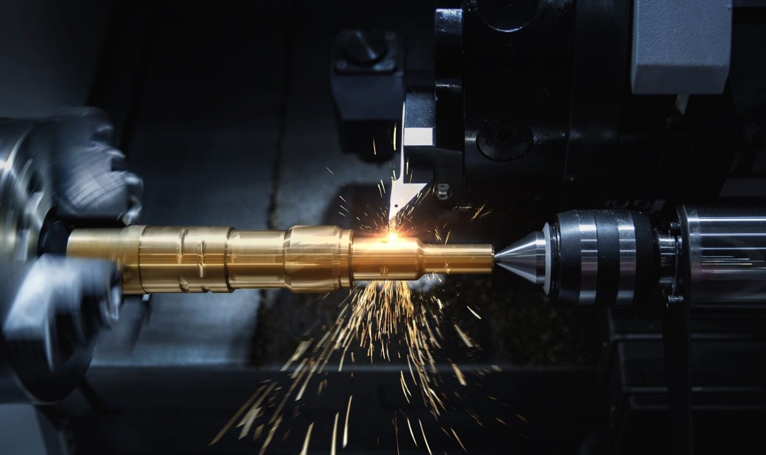

When using a CNC turning machine to turn a part, the workpiece is locked into a set of jaws to hold it tightly. The machine then begins to spin the workpiece at a high speed. A cutting bit is then used to slowly remove material with each pass, symmetrically shaping the object into the final shape.
