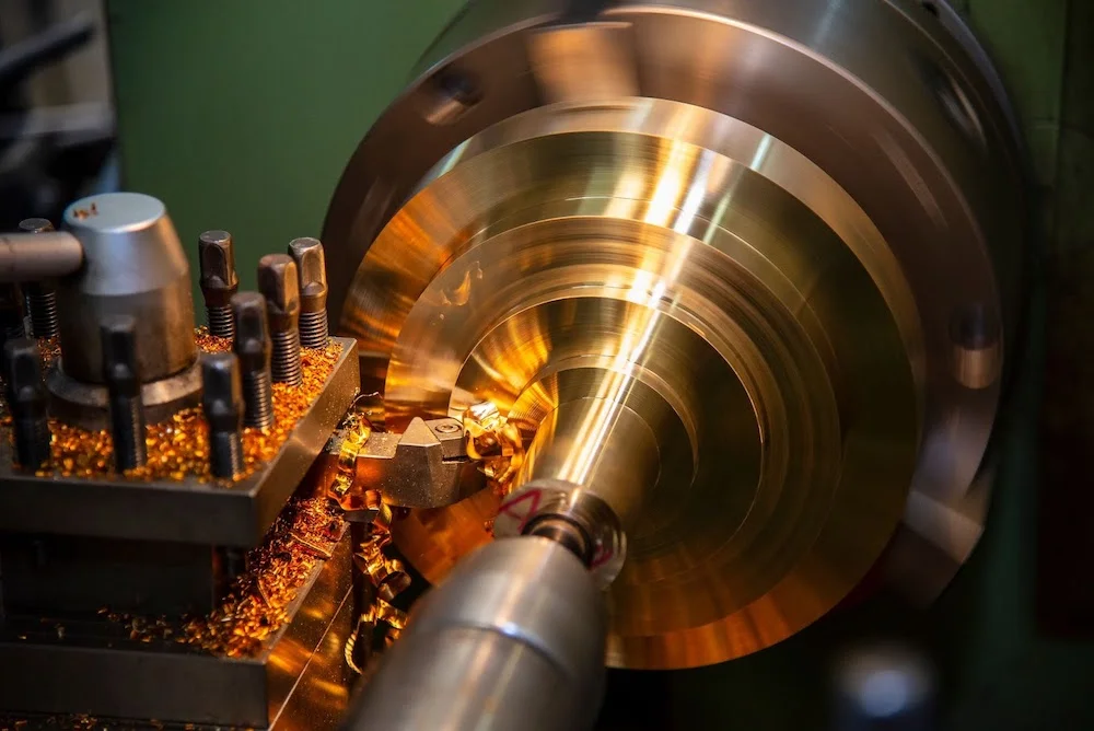

CNC lathe machining of brass shaft parts
Copper, unlike steel and aluminum, is not typically used in structural applications because of its low strength and high ductility. Basically, copper is a “soft and squishy” metal, but what it lacks in strength, it makes up for with high thermal and electrical conductivity — it’s typically used for wires and cables.
When copper is mixed with zinc, the resulting alloy is brass. Brass not only retains much of copper’s thermal and electrical conductivity, but can also be alloyed with other elements to achieve higher strength, higher corrosion resistance, and lower friction. Common uses for brass are locks, gears, bearings, sleeves, and plumbing fixtures. Brass is also used for decorative items due to its shiny, gold finish and high formability and machinability which allows for intricate details.

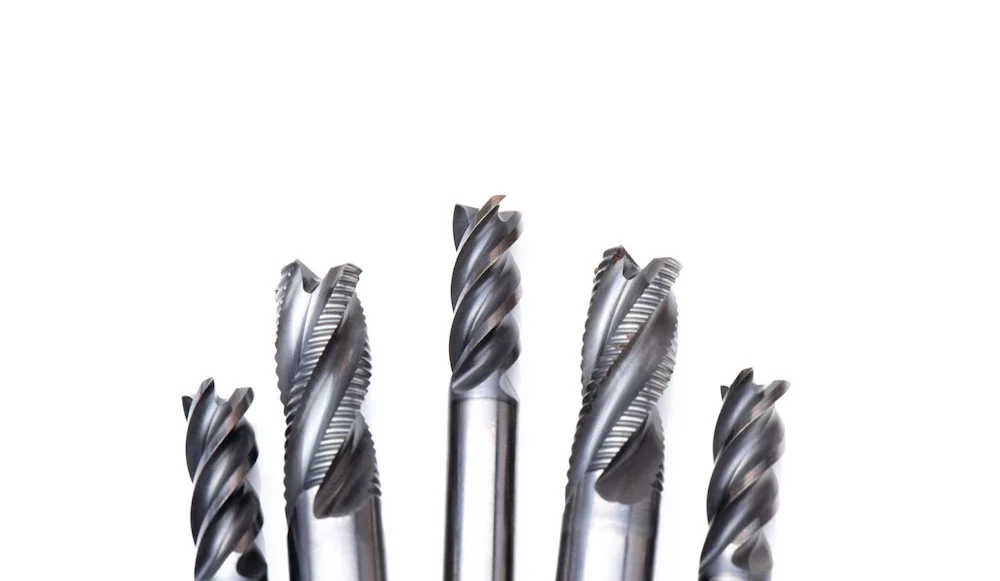

Machining rates (also known as feeds and speeds) ultimately control your material removal rate no matter which kind of metal you’re using. For example, with aluminum, its high machineability means you can remove a lot of material in one pass. But, aluminum’s low melting point means you must manage the heat generated during machining or the material will end up sticking to the tool. Depending on the grade of aluminum, your max feed and speed will change, as different grades and heat treatments can range from having a “gummy” material to extremely hard.
Pro-tip: As a quick reference, check out this guide for some standard feeds and speeds: “Feeds and Speeds: The Definitive Guide.”
Because various types of metals have a wide range of machinability, different cutting tool shapes and different cutting tool materials should be used depending upon your application. For example, if the material requires significant chip removal (or chip clearance), the number of flutes in a tooling bit should be increased or decreased to optimize your process. If maintaining a sharp edge on your cutter is paramount, you can prioritize hardness over toughness by using carbide tooling instead of high-speed steel tooling.

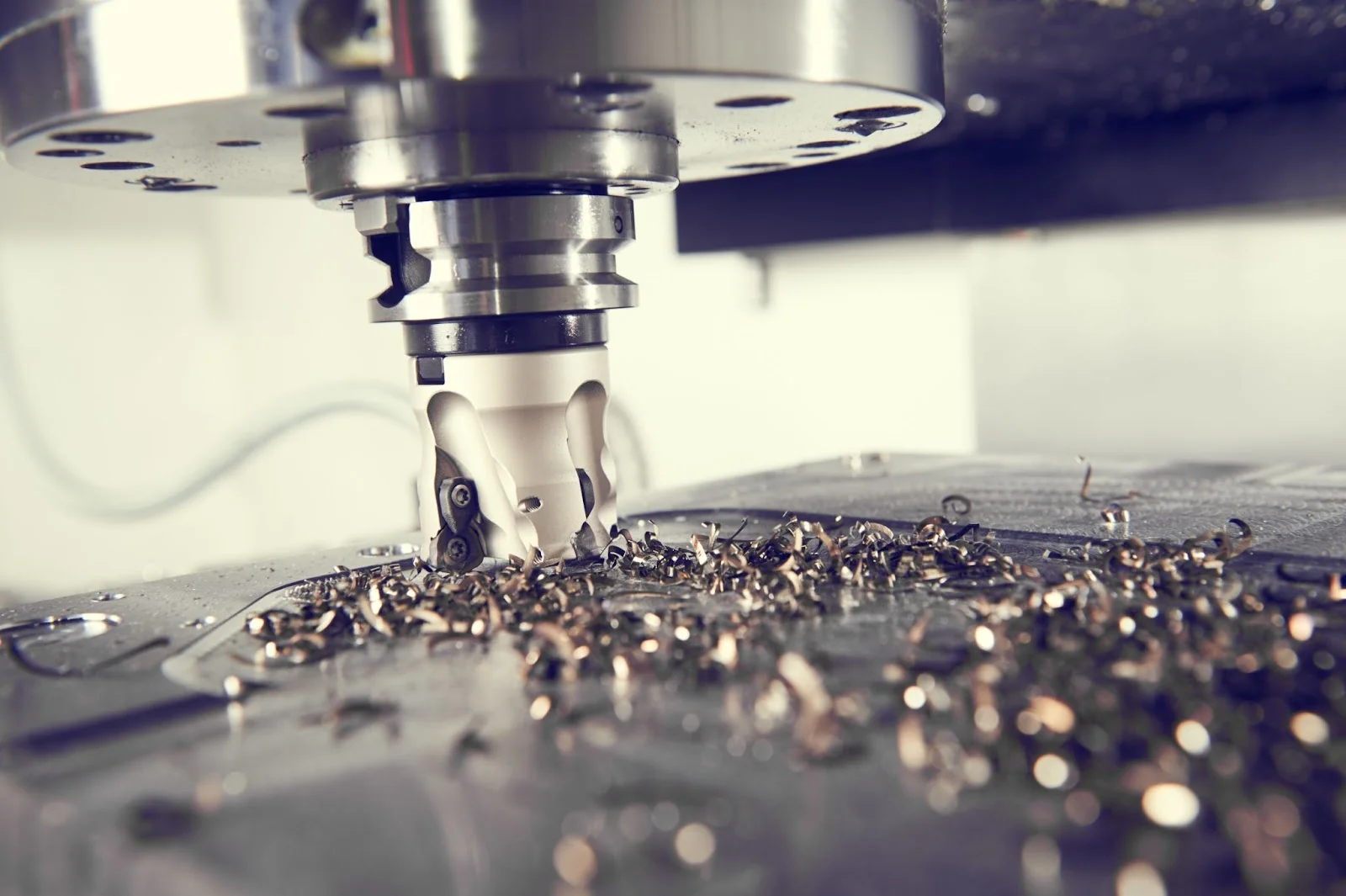

Industrial CNC Milling
And tool material isn’t the only consideration. Tools can have a variety of finishes such as aluminum titanium nitride or zirconium nitride coatings to help improve friction and heat management while cutting. To make it even more complicated, the helix angle is also critical — changing this angle directly affects the heat build-up during machining and therefore affects your optimal feeds and speeds and resulting surface finishes.
