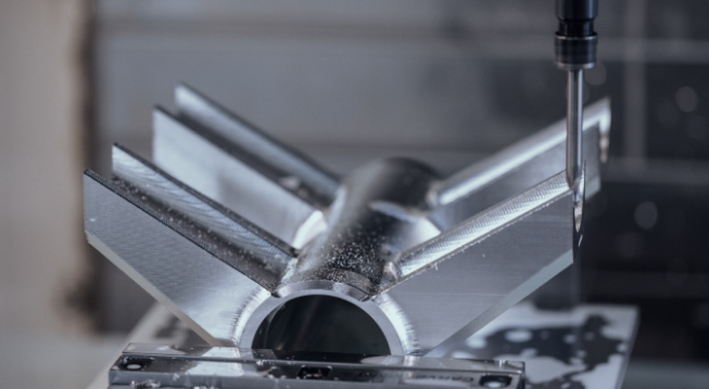

  1. Machine Cutting Axes
Your machine’s capability dictates the level of CNC cutting complexity. Modern CNC technology allows for multi-varying axis rotation and translation. This permits the machining of highly complex features.
For example, a 5-axis machine can cut angles that a 3-axis machine cannot accommodate. Part manufacturing typically requires multiple setups to machine all features on a part. But with higher axis capability, we can reduce the number of set-ups and increase the potential to manufacture highly complex CNC parts. And different variations of CNC milling make it possible to maintain design consistency.

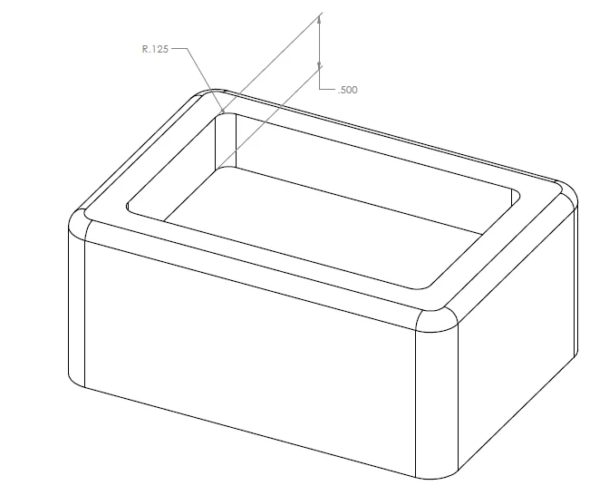

Internal corner radii are another key feature to carefully consider For example, using a .250” end mill to machine an internal pocket will generate a .125” inside corner radii, which should be used in all possible areas where a corner radius is cut. This approach eliminates tooling changes within the machine, which reduces machining time and therefore, machining costs.
On the other hand, if we need to change between a .250” end mill and a .1875” end mill to accommodate two different corners, the machine must stop milling to change tools — increasing processing time and part costs in the process.
The final element to consider when CNC milling complex parts is the depth of pockets, and there’s a simple formula to determine the proper internal corner radii:
CNC Machining Complex Parts
This formula sets the minimum internal corner radii of a feature at 1⁄4 of the feature’s depth. This formula is referenced to ensure enough tool clearance within an internal feature and to allow the usage of standard-sized cutters. Standard-sized cutters like end mills have standard lengths based on their diameter. If you exceed that depth, you risk not physically being able to hit the required feature depth without breaking the tool.

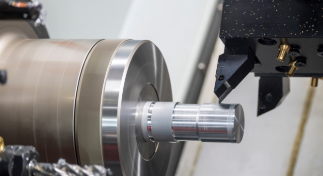

CNC turning involves rotating a workpiece at high speeds while advancing a cutting tool along the workpiece surface to remove material. Turning is a conventional method of producing CNC machined parts and has been utilized since 1940 when the first numerical turning machine was invented. Another name for this machine is a CNC lathe. Within a CNC lathe, cutting tools are mounted on a numerically controlled turret, which allows for complex operations. For example, a hexagonal turret allows 6 different cutting tools to be held in a single setup — which enables the machine to make 6 different types of cuts in one operation.
CNC lathe facing the surface of a workpiece
CNC lathe facing the surface of a workpiece Click image to preview
Live Tooling v. Non-Live Tooling
The advancement of live tooling has made it more cost-effective to machine complex parts on a static CNC lathe. Live tooling allows a lathe controlled by CNC, along with the turret of differing spindle and sub-spindle configurations, to perform an array of operations while the workpiece is fixed in orientation to the main spindle.
The operation of a CNC lathe without live tooling limits the types of cuts and tooling that can be used. During the standard turning operation, the tool is in a static turret, and the only movement possible is a linear motion along the z-axis of the workpiece. This limits what cuts can be made for one machine set-up. Also, with only z-axis translation, more complex machined features must be performed in a secondary operation on a CNC mill.
Live tooling permits all standard turning cuts, plus milling features as well — they can accommodate angular configurations to support both axial and radial cuts. The development of live tooling lathes has allowed significant reductions in lead time and machining cost. Combined with the ability to machine features in the radial and axial directions has enabled the designing and prototyping of highly complex CNC machined parts on a much smaller budget.

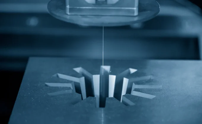

Electrical Discharge Machining is a unique, non-traditional method because it doesn’t use sharp tooling for material removal like CNC mills and lathes. Instead, EDM removes material using a flow of electricity and thermal energy, which is why it’s called an electro-mechanical process.
Conventional EDM uses a tool (cathode) that emits an electrical current. The cathode runs along a workpiece (that serves as an anode) immersed in a dielectric fluid. This closed electrical circuit generates high temperatures and sparks which vaporize the material. For this cutting process to be effective, the workpiece material must be electrically conductive. Fictiv offers various non-ferrous metals, normalized and/or hardened that are great options for cutting complex part profiles.
The main advantage of EDM machining lies in its ability to cut hardened metals easily. EDM machining is better suited than conventional CNC machining because tooling costs are significantly reduced — traditional tooling wears quickly when cutting hard materials. Additionally, CNC EDM permits the machining of advanced CNC mechanical parts like gears, splines, internal gears, keyways, and other difficult-to-cut internal profiles. Many of these features would commonly be manufactured with a CNC mill or broaching machine, but EDM allows for this processing with high efficiency and minimal setups.
One enormous advantage of EDM machining is its ability to machine multiple parts at once. So, not only can you cut one rack gear profile, multiple racks can be stacked linearly and cut at the same time. This capability reduces lead times, part costs, and machine cycle processing times.
electrical discharge machining
A wire EDM workpiece being processed
Tolerance and surface finish capability
EDM offers high-quality cuts with tolerances tight as +/- .0001”, which permits the design and manufacture of extraordinarily complex and custom CNC parts. Wire EDM can cut materials as thin as .0004” and thicknesses up to 16”. EDM also offers surface finishes as great as 32 micro-inches, a surface finish close to CNC grinding without the post-processing. To accomplish this level of finish, multiple tool passes are necessary, but it’s still a fractional cost compared to conventional machine grinding.
