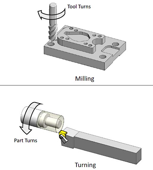

CNC turning services offer a widespread technology for manufacturing cylindrical parts from various materials. Unlike CNC milling, CNC turning rotates the workpiece and introduces a stationary tool into the workpiece. Advanced CNC turning centers take this further by adding milling functionality to the machine to produce highly complex parts like those in the image below:

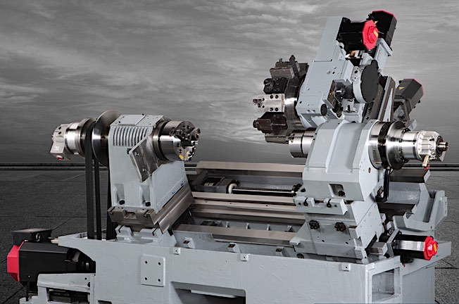

The difference between a CNC lathe and a CNC turning center can be simply expressed as a difference in their capabilities, with a turning center typically being capable of multiple operations while a lathe simply turns. A lathe is a machine designed to cut a rotating workpiece while turning refers to the rotational cutting process in general.
Before CNC technology, lathe machines were similar and easy to identify. However, with advancements in technology, many new features have been added. So, we need to differentiate between simpler CNC machines that perform operations like the original lathes, and enhanced machines (CNC turning centers) that can perform turning cuts in additional ways.
CNC Turning Center
Some companies differentiate the two based on the number of toolpath axes the machine can execute. CNC toolpaths can be classified as 2D, 3D, 4-axis, or 5-axis (this applies to both milling and turning-cutting processes). Lathes generally are 2-axis machines, while turning centers are typically 3-axis, 4-axis, or 5-axis machines. Other companies refer to machines that can perform turning cuts as well as milling and drilling operations as turning centers.

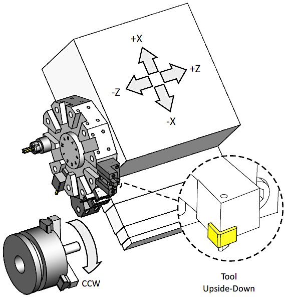

CNC Turning Machine Components
Turning machines consist of a spindle attached at one end to the machine drive system, while the other end accepts the chuck that grips the workpiece to be cut. The chuck typically has three or four jaws, with three jaws being the most common. Four-jaw chucks can be used to grip square bar and also allow for off-center turning.
Cutting tools are often made of carbide inserts. Those inserts are mounted into tool holders, which are bolted to the turret using a variety of specialized holders, depending on the type of tool. Tools are then indexed as a part of the preparation before machining starts.
CNC Lathe Tool Turret

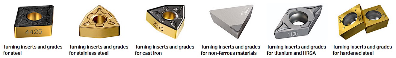

CNC Turning Tooling Materials
Several companies dedicate significant research efforts to designing better inserts, coatings, and alloys to increase tool life and performance. Because there are a variety of insert designs, selecting the insert that’s appropriate for the material being machined is crucial. Attempting to machine a hard material using a tool meant for softer materials — while using the same speed and feed values — can break the tool or damage the workpiece.

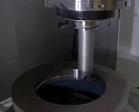

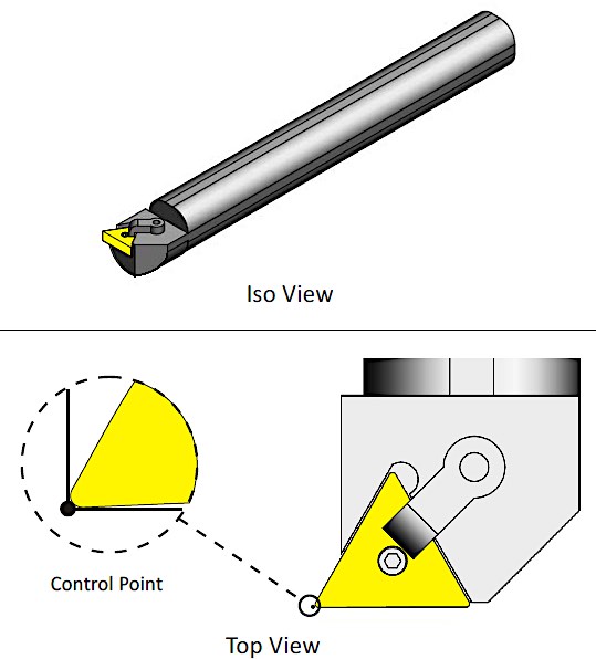

  1. Boring
    After a hole has been drilled it may be necessary to enlarge it. The easiest way to do this is through a boring operation where the cutting tool is fed into an existing hole and removes material from the inner wall of the hole.
CNC Boring

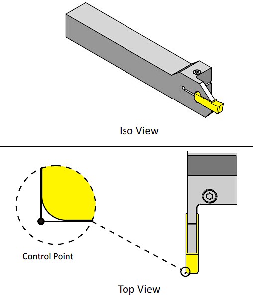

  1. Grooving or Parting
    Grooving is typically used to create features like O-ring or circlip grooves and contouring operations. A grooving tool is sometimes also called a parting-off tool and is used to remove the completed part from the workpiece stock.
Grooving

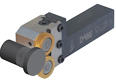

  1. Knurling
    Knurling produces a diamond pattern into the outer diameter of a part. This pattern is not produced by cutting, but rather the knurling tool compresses the material into the desired pattern. Knurling is most often used to add grips onto a part.
CNC Knurling
