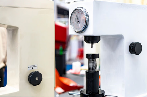

Because the hardness of a material is a measure of its ability to withstand shear forces before deformation, it also determines the material’s wear resistance, which impacts CNC machining. A softer material cannot withstand as much shear force as the material starts to slide across itself and deform, so it will have a higher tendency to smear during CNC machining. Expert machinists know how to manage this characteristic to precision machine even the softest metals, however.
![hardness tester machine](https://www.fictiv.com/wp-content/uploads/2022/10/hardness-tester-machine.jpeg)
Along with increased hardness comes increased wear resistance because harder materials are more difficult to cut through. A material’s ability to be cut and the type of tooling capable of cutting the material are directly correlated to the hardness of each material. For harder materials, diamond-infused cutting tools are a good choice, as are carbides and ceramics. Conversely, soft metals can be machined with almost any tooling, but managing the speed of the tool well is critical to get clean cuts without smearing.
Pro-tip: Regardless of your tooling material, roughing is a good technique for the beginning phase of CNC machining hard materials. Roughing is pre-machining materials before annealing or hardening treatments.
Harder metals are not as forgiving when it comes to tooling chatter, so they must be machined with more rigid, higher precision tooling. Also, using the right tool shapes is key to successfully CNC machining hard metals. For example, ball end mills are great for finishing or roughing hard metals because they disperse heat well and limit workpiece deformation. Corner radius tools are good for hard metals with broad or flat shelf portions, but they can cause chipping.
