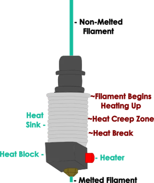

Heat creep occurs in hot extrusion 3D printers, including FFF (Fused Filament Fabrication) and FDM (Fused Deposition Model) 3D printers. It refers to the unintentional transfer of heat from the hot end, where the filament melts, to the cold end where filament is fed into the printer’s extruder assembly.
![visual depiction of heat creep in 3D printing](https://www.fictiv.com/wp-content/uploads/2023/05/visual-depiction-of-heat-creep.png)
As shown in the diagram above, heating should only happen in the heat sink zone and below. When heat transfer occurs above the heat sink, you get premature heating of the filament, and problems like filament softening and clogging that lead to printing issues. There are a few reasons why heat creep might occur, and most of them can be controlled or mitigated.
