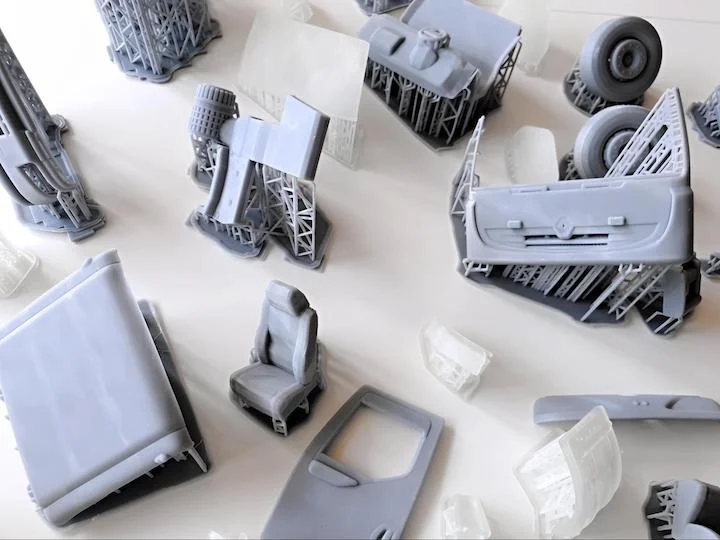

![SLA 3D printed parts](https://www.fictiv.com/wp-content/uploads/2023/05/SLA-3D-printed-parts.jpg)

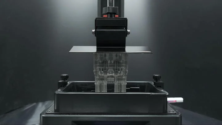

![SLA 3D printer](https://www.fictiv.com/wp-content/uploads/2023/05/SLA-3D-printer.jpg)
SLA resins undergo a process called polymerization when exposed to specific wavelengths of light. During polymerization, the individual monomers and oligomers within the plastic resin form chemical bonds. As a result, the material solidifies into rigid or flexible geometries, depending on the specific resin.
