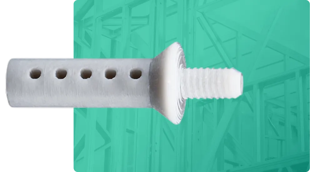

Accura Xtreme is a photopolymer resin used in Stereolithography (SLA) 3D printing technology. It is known for its exceptional toughness, durability, and resistance to high temperatures, which makes it suitable for applications that require robust, functional parts. Here are some common applications for Accura Xtreme in 3D printing:
Functional Prototypes: Accura Xtreme is often used to create functional prototypes of products and components, especially those subjected to mechanical stress, impact, or high temperatures.
End-Use Parts: It can be used to manufacture end-use parts and components for various applications, such as those used in industrial machinery, equipment, and tools.
Automotive Components: Accura Xtreme is employed in the production of automotive parts that require toughness and resistance to heat, including under-the-hood components, brackets, and air intake systems.
Aerospace Components: In aerospace applications, where parts must withstand harsh conditions, Accura Xtreme can be used for creating components like ducts, housings, and brackets.
Industrial Equipment: It is suitable for manufacturing parts used in industrial equipment and machinery, such as gears, housings, and jigs.
Oil and Gas Industry: Accura Xtreme’s resistance to high temperatures and durability make it valuable for producing components used in the oil and gas industry, including downhole tools and equipment.
Custom Manufacturing Tools: Manufacturers use Accura Xtreme to produce custom tools, jigs, fixtures, and assembly aids that require durability and resistance to wear.
Electrical and Electronic Components: The material’s electrical insulation properties make it suitable for producing enclosures, connectors, and housings for electrical and electronic devices.
Sporting Goods: Accura Xtreme is used to create sporting goods such as protective gear, equipment components, and firearm accessories.
Consumer Products: It can be employed in the production of durable consumer products like cases, handles, and parts for power tools.
Medical Devices: Accura Xtreme can be used for producing certain medical device components, such as instrument handles and equipment housings.
Water-Resistant Parts: In applications where water resistance is crucial, such as marine equipment and outdoor gear, Accura Xtreme’s durability is advantageous.
Heat-Resistant Components: Parts that need to withstand high temperatures, like those found in manufacturing processes, can benefit from Accura Xtreme’s heat resistance.
High-Impact Applications: It is used in applications that require high impact resistance, such as automotive crash test prototypes and protective gear.
Tooling Inserts: Accura Xtreme can be used to create tooling inserts for injection molding and other manufacturing processes, where durability and thermal stability are important.
Accura Xtreme’s combination of toughness, durability, and resistance to high temperatures makes it a versatile material for a wide range of industrial applications. It is particularly well-suited for parts that need to endure harsh environments and mechanical stress.

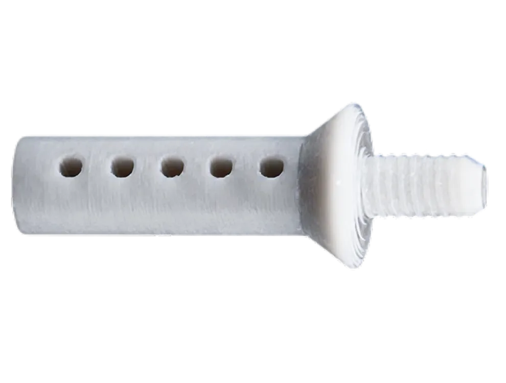

Accura Xtreme Grey
Accura Xtreme Grey is highly stable, with a low thermal expansion rate, making it an ideal choice for intricate, detailed designs. It is also a durable material, boasting a high impact strength and good chemical and electrical resistance. This material is often utilized for electronics enclosures or consumer product enclosures. SLA Accura Xtreme Grey is a reliable and cost-effective option for a variety of 3D printing applications. It’s strength and durability make it a great choice for snap-fit components as well.
Accura Xtreme White 200
Accura Xtreme White 200 is highly stable, with a low thermal expansion rate, making it an ideal choice for intricate, detailed designs. It is also a durable material, boasting a high impact strength and good chemical and electrical resistance. This material is also capable of producing a wide range of post-processed finishes, such as matte, glossy, and textured. SLA Accura Xtreme White 200 is a reliable and cost-effective option for a variety of 3D printing applications. It’s strength and durability make it a great choice for snap-fit components as well.
