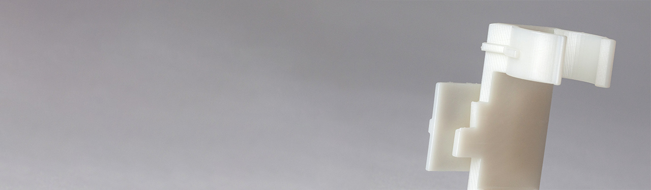

Accura 25
Accura 25 is a durable and flexible SLA 3D printing material. It’s ideal for snap-fit part designs, as a master pattern for urethane casting, and conceptual modeling. Accura 25 can be used for functional prototyping or end-use parts and has excellent resolution, dimensional accuracy, and can be primed and painted after printing.
Process:
SLA 3D printing
Colors:
White
Resolution:
0.1 mm
Max Print Size:
635 x 736 x 533 mm
Design Recommendations
Max Part Size [x, y, z]
10 x 10 x 10 inches (380 x 380 x 255 mm)
Gaps for Mating Parts
0.5 mm between parts that need to be assembled
Tolerance
± (0.13mm + 0.05mm/mm)
Min Wall Thickness
1.0 mm for production, 1.5 mm for consistent measurement or mechanical properties
Min Hole Diameter
0.5mm
Note that any surface in contact with support will have small nubs in the final product as a result of support removal. To optimize the overall surface smoothness of the part, avoid extra overhangs, steep slopes, or large flat planes that may add more structural support.
Cost Saving Tip
Parts can be designed hollow to reduce material usage. Make sure to design a drainage hole that’s at least 4mm in diameter to allow removal of trapped resin. Surrounding walls should be at least 2mm thick to ensure a successful print.
About the Process
Stereolithography, or SLA, is a 3D printing technology known for achieving highly detailed and functionally accurate parts. The technology utilizes a mirror that is programmed to direct an ultraviolet laser to draw and cure a part’s cross-section onto a vat of photopolymer resin. After each layer, the build platform lowers and a recouter blade wipes over a new layer of material on the top of the tank.
Once the part is complete, it is removed from the build chamber, cleaned of support and excess resin (typically using isopropyl alcohol), and then placed in a UV oven for further curing. This ensures the part reaches its optimal physical properties.
