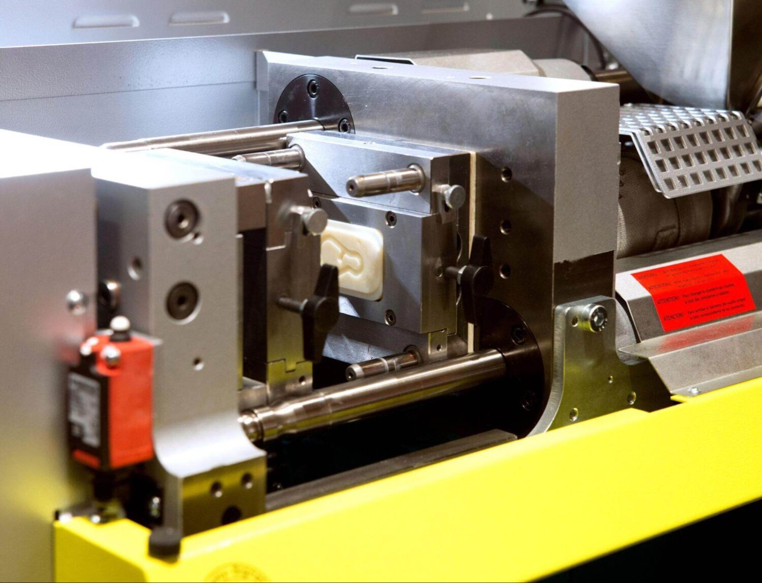

By utilizing additive manufacturing for molds, 3D-printed tooling can be produced in a fraction of the time and cost it would take for traditional tooling. For low-volume production, this gives it a clear edge over traditional mold-making, which can be slower and more costly. As a result, manufacturers can now rapidly prototype, iterate designs, and bring products to market faster than ever–without the financial commitment of traditional tooling.
3D-printed inserts can be used in injection molding tools as a cost-effective solution.

Injection Molding Tooling (for Plastics):
3D-printed inserts provide a lower-cost, faster alternative to traditional steel molds. Ideal for short runs, prototyping, and low-volume production, they enable the creation of complex geometries with reduced lead times.
