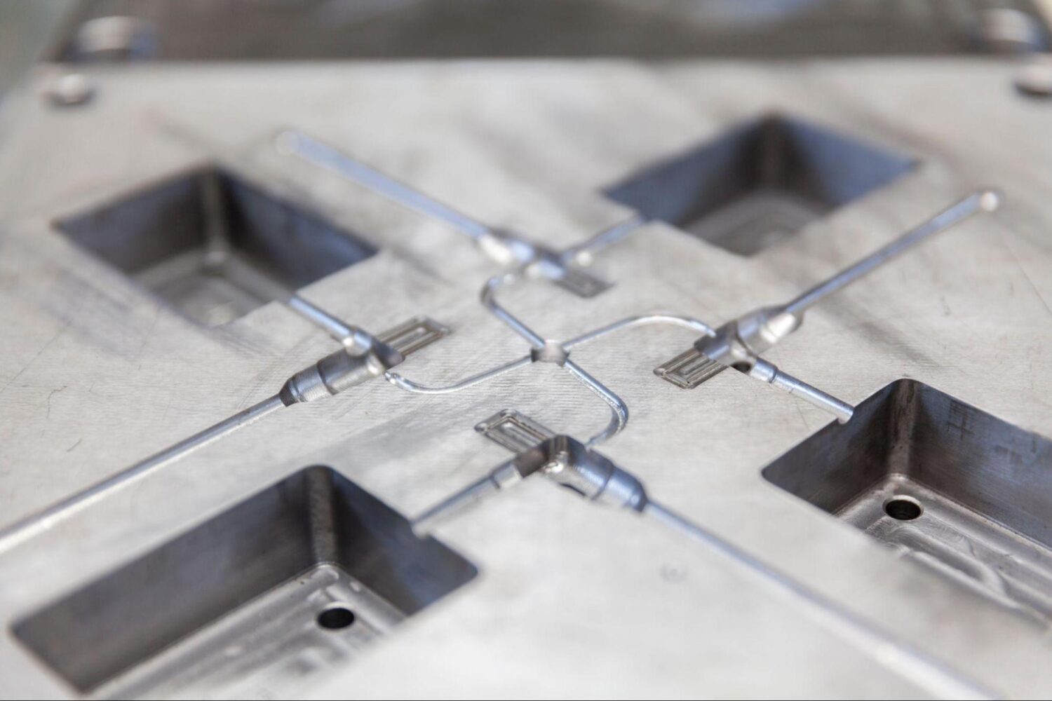

Runners and gates on the cavity side of an injection molding tool.

2. Runners and gates
Runners are channels that direct molten plastic from the injection nozzle to the mold cavities, while gates are the entry points into the cavities. The design and placement of runners and gates are critical to ensuring proper material flow, minimizing waste, and avoiding defects like short shots or uneven filling.
